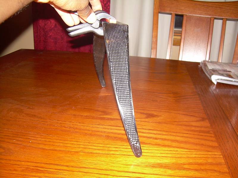

I think the combined weight is about 5.2 oz. I remember weighing them against the ES gear and nearly crying as they were more than double the weight. They have a more finished look than the ES gear but significantly heavier. To look at the ES gear you would almost think that Ed is able to bond carbon fiber without epoxy. His gear has no shine to it and is extremely light.
I will ask Mark exactly what the weight was and report back.
OK which way is the front and which is the back?

The gear sweep back....

There is no real substitute for the ES gear. it's gone, so the point is irrelavent. they were the lightest and the strongest. They didn't look as good but they worked WELL. Currently all of the gears weigh about the same. About 4.5+ ounces. So pick your poison and save weight elsewhere. Unless someone has a better source they're holding out on?
They sweep back. And they do end up behind the LE of the wing. Even the most radical sweep doesn't sweep too far so it's fine.

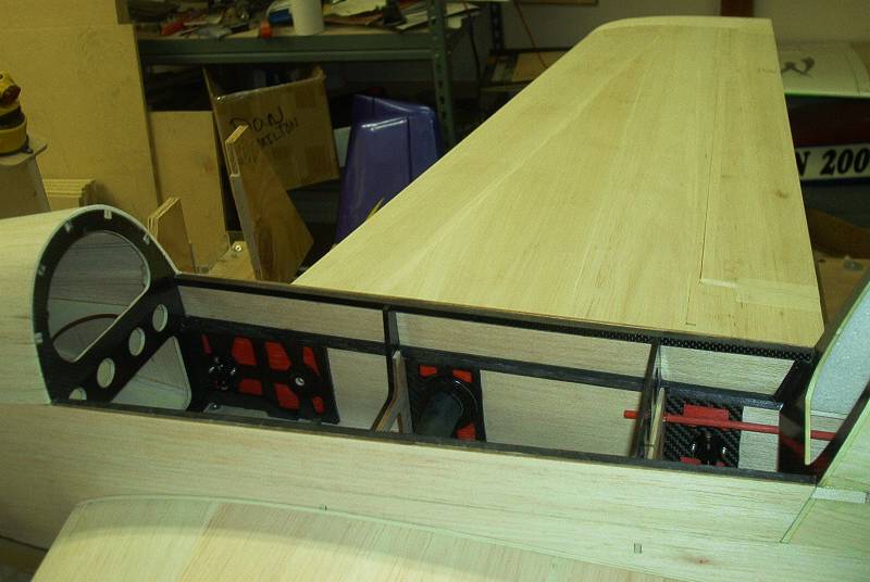

I utilised most of my long weekend for the Fuse Construction. It is easy build so far (As you can see I glued the F4 upside down which forced me to cut a little bit for the DEPS. My Mistake).

Fuse Jig is real nice. This is my first Kit with no prior build experience and I found this Jig as a real good investment. Got it from Pete.
Srikar
F2T is also in wrong, it goes behind F2 not in front....hopefully that's just set there and you can adjust?

Wow, that is lot of relief to see your post Mike. I was worried when the Canopy formers were not mathing perfect with the F2T and TDF. Dean was aksing me why the 1/2 inch gap was there between F2T and Canopy Former looking into photos and I was not able to understand why that Gap was there.
No, I did not glue the F2T yet, so I will put it back of F2 and hopefully that should align the Canopy formers close to F2T and TDF. I will confirm this later this evening.
Thanks a lot for correcting me.

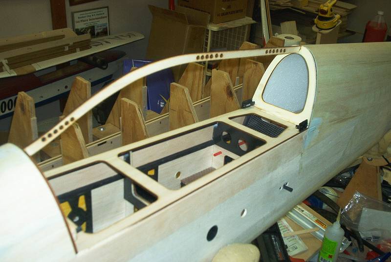

A few pics for you.
With a hard sanding block and 80 grit paper, sand a slight bevel on the aft top edge of F2. This just lets F2T adhere better.
Note the dimension marked on the fuse drawing, that measurement is taken at the top middle stringer, from the front face of the firewall to the aft face of F2T. This sets F2T at the proper angle. Glue it on with a thick blend of epoxy and milled fiber, wiping down the excess. You just want a strong joint here.
After sheeting the front end, and setting the canopy frame, I glue the canopy to the frame using a jig that I made. It's just a piece of MDF board cut undersized so the canopy frame overhangs and doesn't interfere. A few inches below I made a flange to tape to. Tape the frame down to the flat piece of MDF and glue the canopy on. Run the tape snug but not tight pulling the canopy against the frame. Again you just want minimal gaps. If it's tightly pulled down, you will distort the angle. just snug and make sure the rear face doesn't change angles or you will hate life. if you wish, make a piece to brace the rear face so it can't move. This is probably the best way to do it.

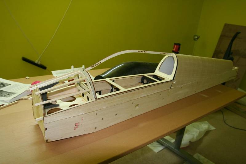

I just glued the F2T with milled fiber epoxy and going for decking. I made my canopy jig just as shown in picture with MDF and will glue it timarrow. Attached is the picture from V2 build that I am thinking about for hatch latch setup and I am not sure how the Turtle Deck inside got Balsa where the hatch latch was attached. Is the same can be applied for VF3 too?? I beleive, some photos will be helpfull If you have.
Srekar...my bad! That picture is of a Patriot I built last year. I was trying to show one method of installing the latch so that daily use wouldn't mark up the fuse or canopy.
BTW - no foam in the turtle decks worked out fine! I wet the 1/16 wood, placed it in the shucks for a few days (without glue) and once dry, installed them with one former in the middle and one stringer across the top. After glassing it was plenty strong and easily saved a couple ounces.

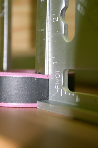

I have a question about Engine mount. I am using AR 70 and one of the 2 beams are not stright at 0 degres. One beam is at about 2 degres from the center. I am not sure if this has to be that way or this is a defect.
First picture is good with stright beams and other 2 pictures shows clearly that the second beam is not at 0 degres.
Any body, any coments?

your mont doesnt look good, maybe the pic lies but it seem that the al.beam is pressed into the pink front plate so that is not "straight" anymore but plate and beam is not like it should be i think!
I whould ask either Hyde or Central (if you bought it there) if this is how it supose to be, i dont think so!
