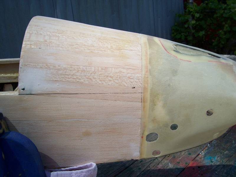

This is the BM V3 I am Monokoting. What I need is a lot of input on jointing the monokote to the cowl. I am afraid to sand much more for fear of going threw. I will be using Lustrekote Missile Red. What color should I use as a base or primmer coat, an can one of these clear coats work. If my memory serves me when I esed the clear coat it shined so much it would blind you, but when it dry ed it smoked up.How about some help with this beauty

hi Wendell, looks good so far!
Paint the cowl. use a light grey primer first, be sure to get the pinholes filled. What I do is use BVM pinhole filler first, then spray primer. Usually a quick sand with 400-600 grit and it's ready for paint right there.
Don't get too crazy with sanding and filling around that cowl on a monokoted plane. you will have a seam there unless your name is Faye Stilley LOL
After the paint fully cures, just overlap the monokote about 1/4" onto the cowl, taking care to match up the colors. Done. use graphics to camaflouge the seam. Only thing I know how to do.
I'm redoing the prototype as I type this, and will have it in Birmingham at the contest this weekend if you want to drive down and have a look. I'm not too worried how this one looks, this plane is a used up $2 ***** but she still flies SWEET. So assuming I can get it test flown and trimmed out, I'm flying this weekend ice cold with no practice (can you say "sitting duck"?) So my goal is no zeroes for at least one round. After that....GAME ON!!!
-Mike

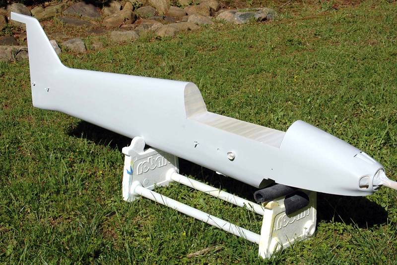

HI All,
I've got the electric twins in white k-36 primer.
I tried something new, I mixed in 1 part DCC white with 2 parts k-36 - reduced that to 50% with DT870 and shot a nice thin coat. It not a pur white but it is a couple shades whiter than the straight k-36. I am sanding this out to 400 dry right now (5:30am) and will shoot another overreduced coat of k-36/white dcc this time mixed 1 : 1.
looking great so far and I think this mixture with the DCC tint is the wa to go and it's should be much lighter in weight than straight k-36 - plus so far it seems to sand and fill just like the k-36.
I also found two new (to me ) products at my paint store that should be helpful. One is this spary can of PPG Adhesive remover - should be great for cleanup after using spary masks. and the other is this scuffing paste to be used with the grey superfine sctochbrite pads. The paint scheme on these electrics requires the white base to be overpainted with trim colors, I am hoping this scuffing paste will speed the job....

okay after the first hour sanding the k-36/DCC white base - I am really impressed that the addition of the white DCC even improves the sandability of the k-36, seems to fill pin holes better and is a slightly harder coat, but that makes it even better smoother base - sanding with 320 and 400 grit dry.
one of the fuses is almost completed in about an hour - it's going to take at least 2 full hours to sand out to 400 for each plane -

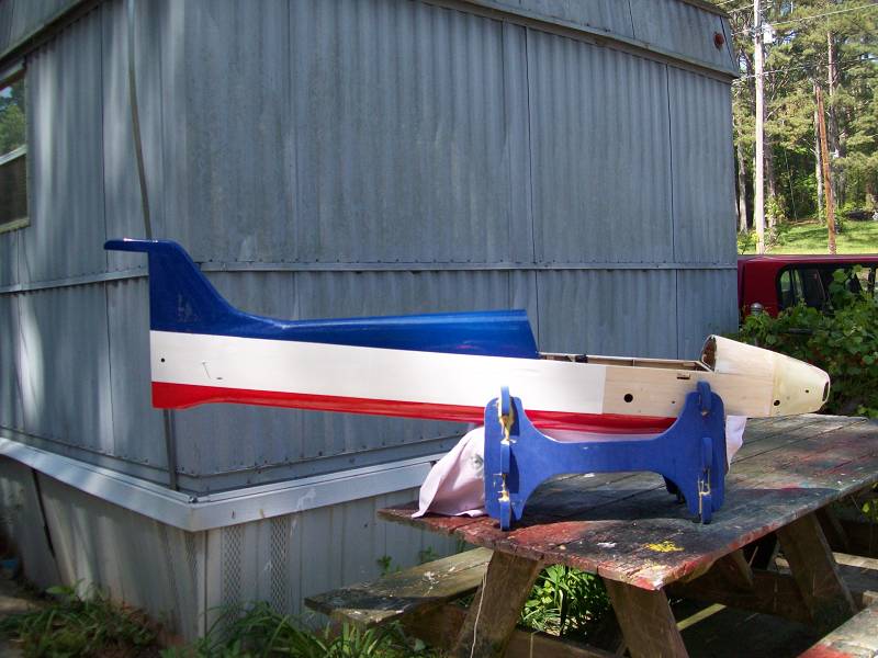

Hay Mike,
Well I took your advice an used a white primer by Lusterkote. I resanded the color an applyed two coats o0f white an wet sanded each along with 3 coats of Missle Red with wet sanding between coats an still came out Orange. I thought maybe the momokote Missle Red was shinner then the spray so I put on 2 coats of clear. I am given up. will send picks of final plane when done but here is the Cowl an belly pan. An the same problem with the canopy. I have learned the hard way that Monokote an lusterkote do'es not match.

Wendell,
The only way that I've been able to make Lustercoat match is to use the lustercoat primer, and then paint the object with white lusterkote, and then spray the color. If I'm not mistaken it says on the can to base all colors with a white lusterkote base coat,
Arch

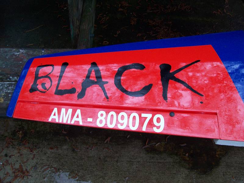

The colors didn't do right but I think it will make up for it in performance. Will do all the graphs tomorrow
