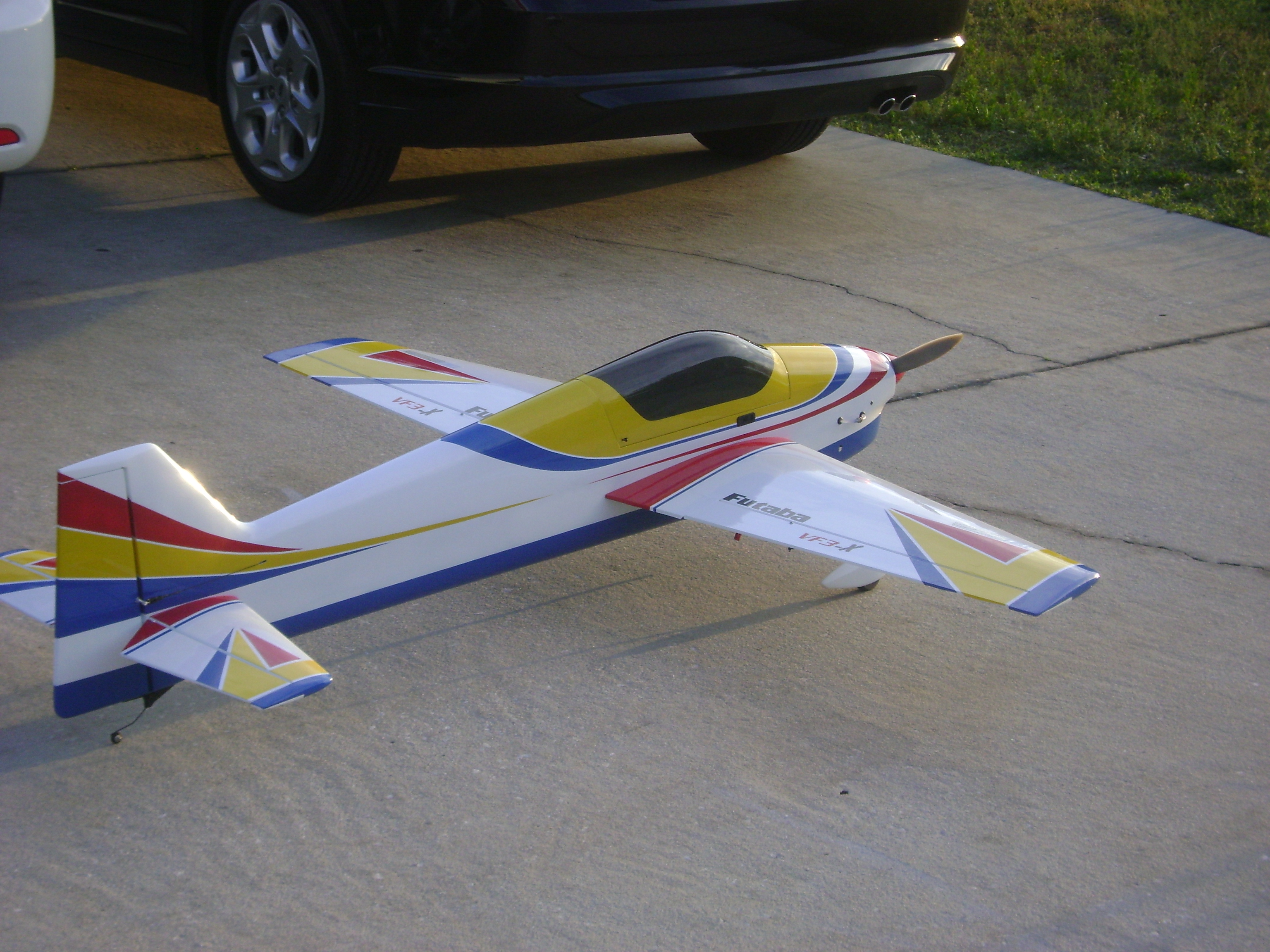

My dads Black Magic VF3 is finally done !!!
He might not know it, but I am really really proud of him and so glad he finally got his finished.
For all the time and effort he puts in to make sure my airplanes are up and running, he definitely deserves this airplane.
so here are some pics of the finished plane.
thanks guys!!

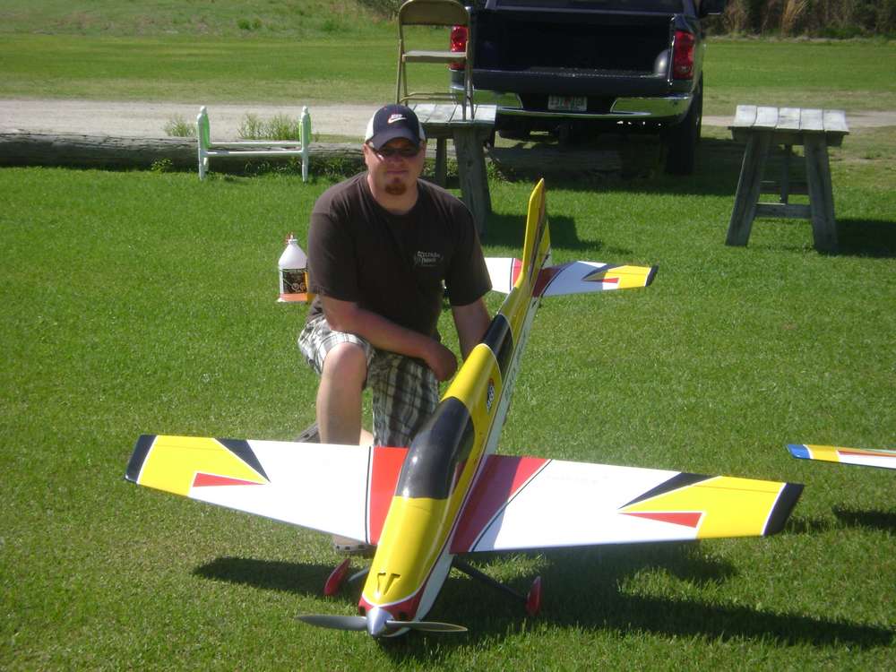

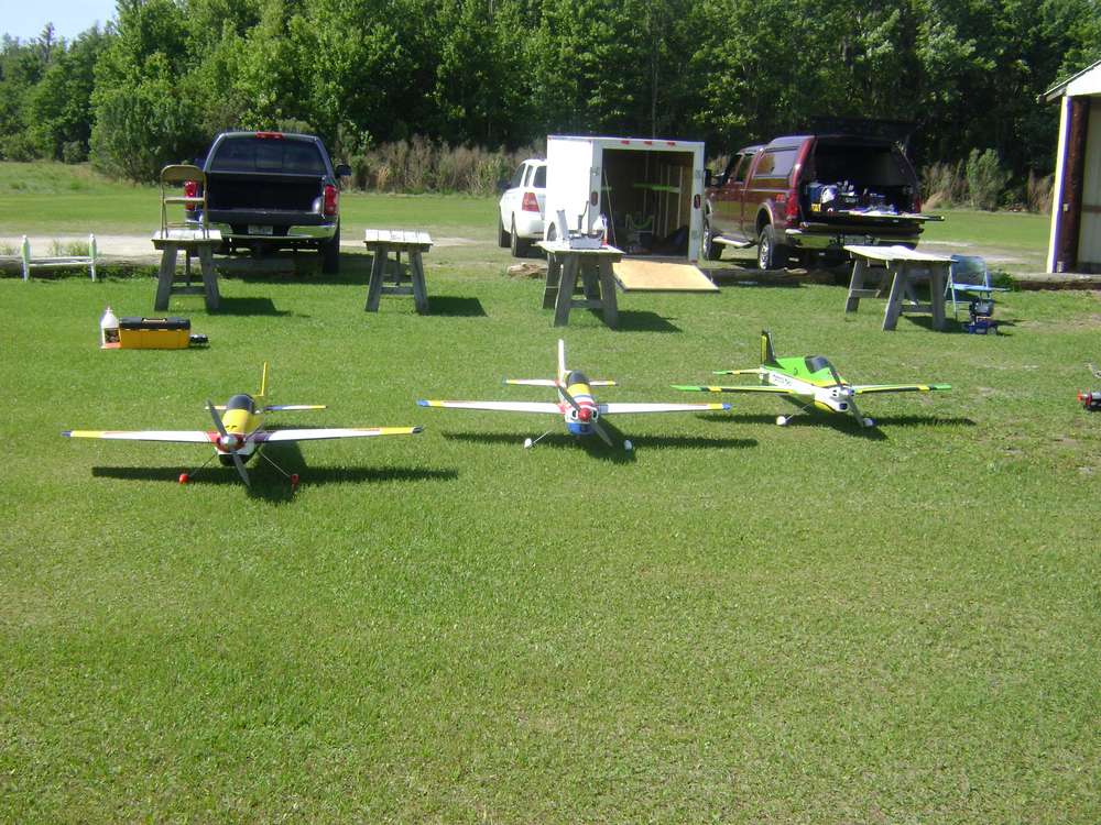

Well we all had a good day of practice here in central Florida. There are two VF3's and one V2.
Larry
