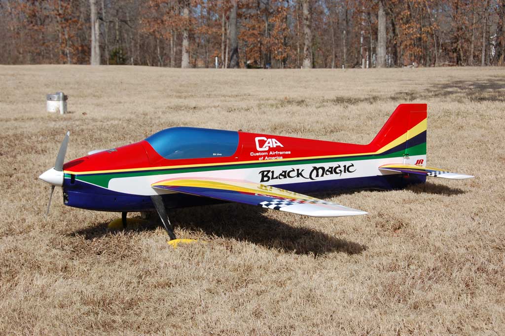

I was talking with Larry on the phone this evening and realized I hadn't posted pictures of my V3 since it's finished. I was able to maiden it yesterday, and it flew terrific. I need to do more trimming (pulls to the canopy on downlines and pulls to the wheels on left-rudder knife-edge), but it flew very well off the board.
Thanks a lot to Pete, Larry, Arch, Dean, Mike, and everybody else who helped me through the building and finishing process.

Looks good Bob.
Perhaps try moving the CG more forward to remove the pull to gear and more incidence in the wing to fix the downline pull to canopy.
Cheers
Jason.

Hey Bob,
It looks great and glad to here it fly's well. Jason has a good point there so give that a try. Just make sure that the stab is set at 0 degrees. You did a great job there and I'll keep you posted on mine.
Larry

RJ,
Out of everyone of them I have flown, and at last count that was up to 19 of them. They fly the best with 0 mix for right rudder, about 2% with left rudder, and about 1% down elevator to low throttle. If you are at that point, then just leave it alone. You will be at a point where you are chasing your tail. You can move the CG forward, but it will mess with other things. From personal experience, if you are at that point, and everything else is correct. Stab at 0, wing at .4-.5 and CG in front of the tube, you can't go wrong.
Plane looks great,
Arch
Plane looks great,
Arch

Thanks a ton, Arch. I will try the small mixes first, and if that fixes it, I'll call it done
i may be a bit tail-heavy, though, as I can fly it inverted straight and level with not elevator.
Bob
i may be a bit tail-heavy, though, as I can fly it inverted straight and level with not elevator.Thanks,
Bob

Bob,
You might be slightly tail heavy. Try shifting your CG forward and see what you get. If you are tail heavy your mixes will be a little more. When it is right you can fly it with 0 mix, but if you get really discrimination there will be a SLIGHT pull to the gear. I know people will talk about 0 mix planes, but I've yet to see one if you really push the envelope. With the speed changes and the fact that we fly props you will never get rid of all the effects from prop.
Arch
Arch

Great, thanks for the advice and explanations, Arch. I will get my CG right on the front edge of the wing tube, then see what I've got. It will be nice whent he weather warms up enough to get out and play more than once a week.
Bob

Hey Arch! I just wanted to confirm what you already know to be true: slight mix to correct pull to the canopy in downlines and pull to the wheels on left knife edge.
Before I went out today, I moved the CG forward a bit, and now I have to barely lean on the elevator in inverted flight. It's right where I like it. I flew it a bit and found that it was wobbling badly on rolls, and it was not pulling to the canopy at all on downlines. In my experience, that has always meant too much wing incidence. I was right at 0.5 degrees, so I backed off half a turn on the adjusters and flew again. Wow! Way better! Nice axial rolls, and it pulls to the canopy slightly on downlines. Such a small adjustment, but it was just what it needed. As you said, it needed just a hint of mix with left rudder and none at all with right rudder.
I think it's a keeper
Thanks!
Bob

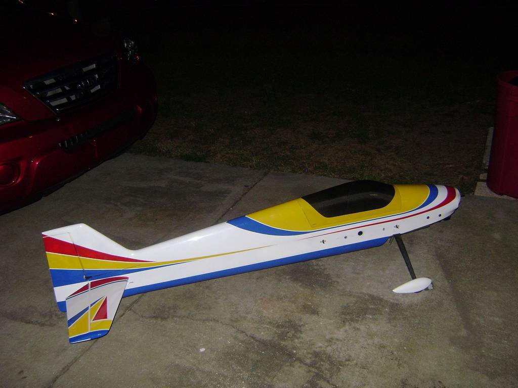

Hey Guys,
Well my dads VF3 is really coming together. The wing and stabs are done and all thats left is mounting the battery and switch. We will be test flying the bird either monday or tuesday.
wish us luck!!
thanks
