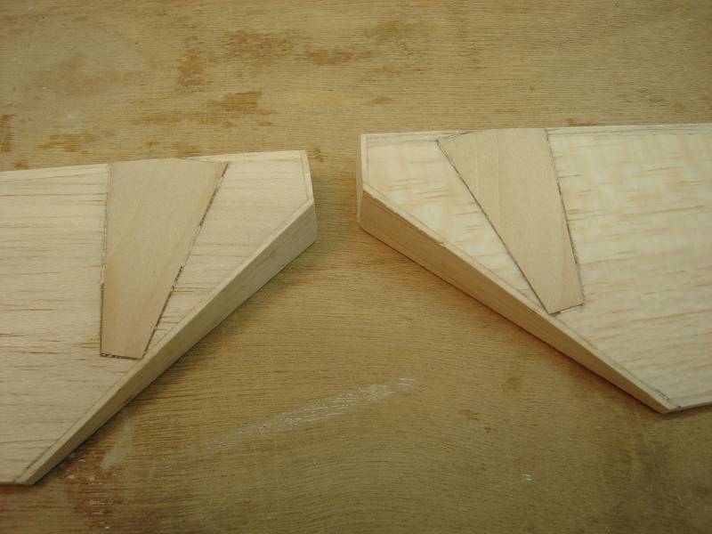

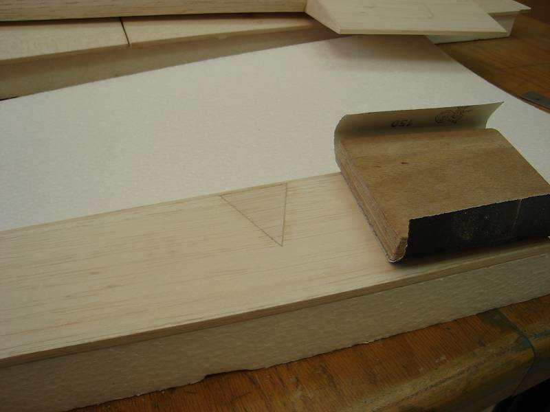

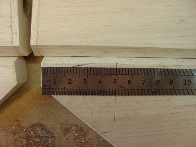

ORIGINAL: rolyjr
Hi Isaac,
Still busy with form the spars - coming along nicely. Great photos you put through. A couple of questions:
What is the measurement for the leading edge to the hole (leading side of the hole) you cut for the incidence adjuster on the root? Suppose the measurement is not entirely critical, but would be useful to have a reference point.
I see you have made either a hole, or an indentation on the dowel in each wing tube. Not sure what the holes/identations are for? (excuse the ignorance).
Roly

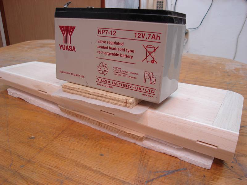

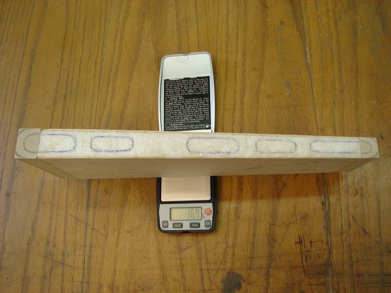

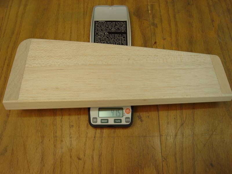

Hi Roly
The measurement is 100mm, according to the marks on the fuselage.
The purpose of the holes to prevent under pressure when you want to pull out tne carbon tube,
As you will see later, the ends off the carbon tube will also be pluged with dowels.
Isaac Najary

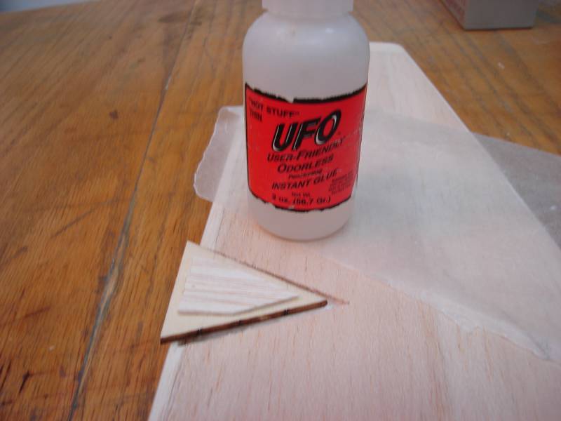

Hi Juan
In the past I used the dowel&bolt method but I prefer this method because it is stronger and you don't see the bolt on the upper side of the control surface.
The trick is to saturate the foam with large quantity off CA, about 1CC, together with the gluing of the plywood. that make the foam in this area like stiff block that harden the control surface and prevents flutter.
After I screw the bolts I unscrew them drip little CA in the screwing.
Isaac Njary

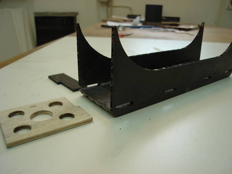

Old 11-12-2007 | 12:13 PM
  #40
Joined: Apr 2003
Posts: 725
From: Vikersund, NORWAY
Default RE: Electric Osmose Building
Hi Najary
can I ask you to take some few pics off the fuse before you start to glue in the oieces ...from the radio \ engine room ?
Is the from Ca installed a "floor" in the fuse like the one in the Genesis placed right under the wing tube!
Rune
Old 11-12-2007 | 03:14 PM
  #41
Joined: Sep 2007
Posts: 36
From: Johannesburg, SOUTH AFRICA

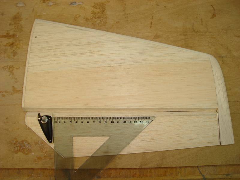

Hi Isaac
If you haven't already, may I suggest you double check the stab incidence lines as mine are off. The left (looking from the back) is lower than the right by approximately 1mm, but is clearly obvious when you put a straight dowel or similar through the hole for the stab tube.
Regards
Roly
Old 11-13-2007 | 11:26 AM
  #42
najary's Avatar
Joined: May 2003
Posts: 1,201
Received 37 Likes on 32 Posts
From: Ramat Hashrone, ISRAEL
ORIGINAL: Rune
Hi Najary
Rune
Hi Rune
I will take some pics off the fuse before I start to do anything.
Yes the "floor" should be placed under the wing tube.

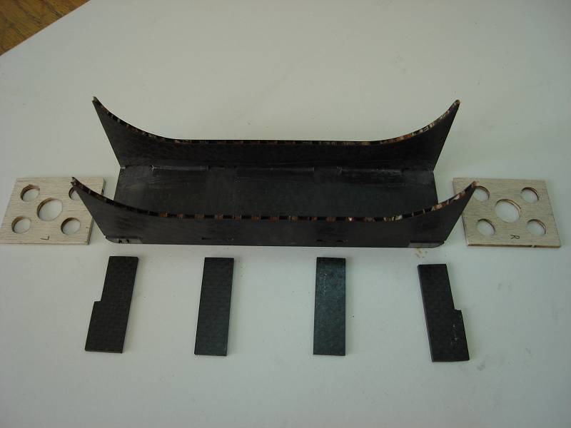

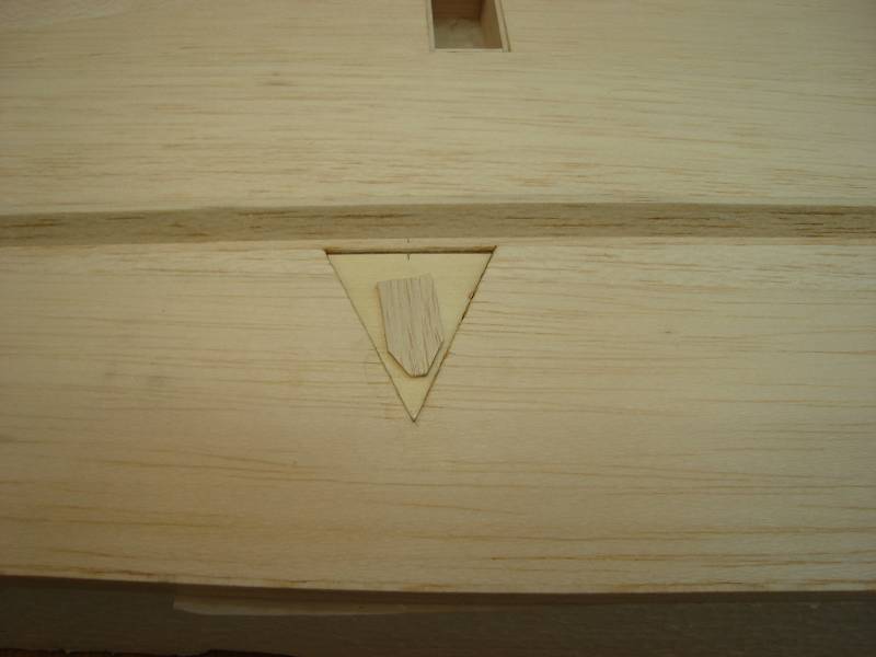

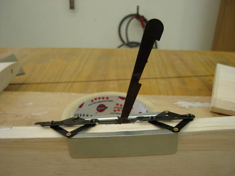

more
ID:	804235   Click image for larger version
ID:	804236   Click image for larger version
ID:	804237   Click image for larger version
ID:	804238   Click image for larger version
ID:	804239   Click image for larger version
ID:	804240   Click image for larger version
ID:	804241   Click image for larger version

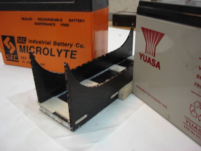

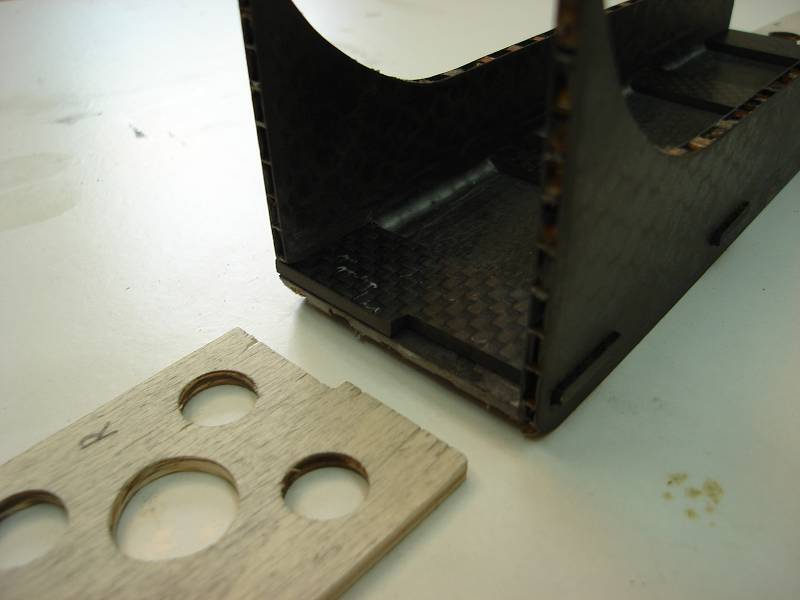

more
ID:	804256   Click image for larger version
ID:	804257   Click image for larger version
ID:	804258   Click image for larger version
ID:	804259   Click image for larger version

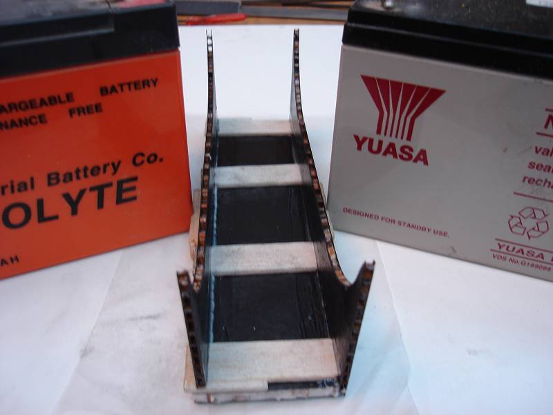

more
ID:	807841   Click image for larger version
ID:	807842   Click image for larger version
ID:	807843   Click image for larger version
ID:	807844   Click image for larger version
ID:	807845   Click image for larger version
ID:	807846   Click image for larger version
ID:	807847   Click image for larger version
ID:	807849   Click image for larger version
ID:	807850   Click image for larger version
ID:	807851   Click image for larger version
