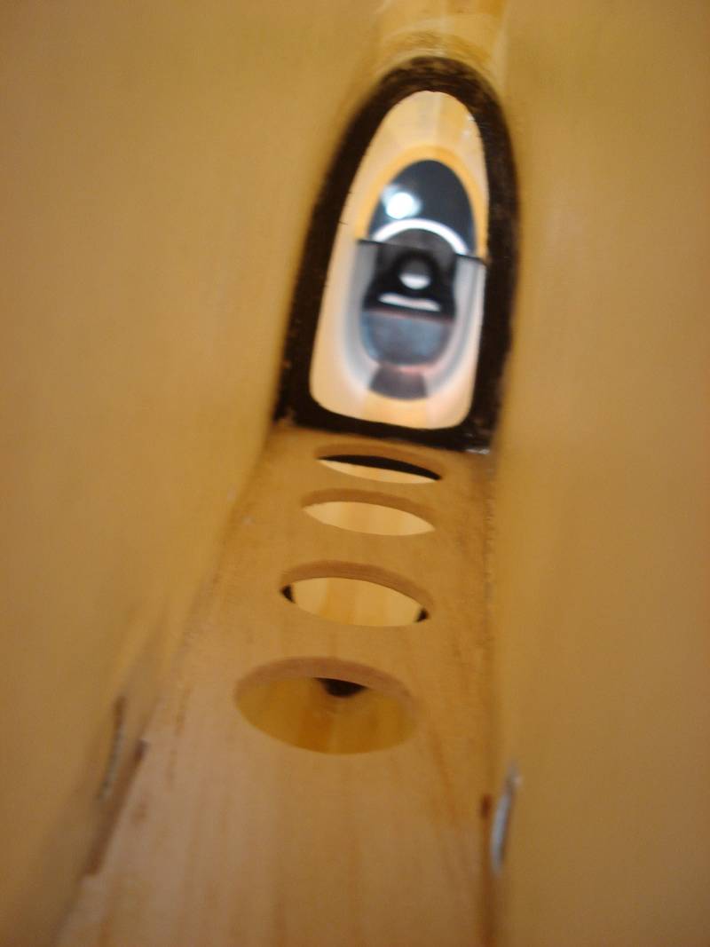

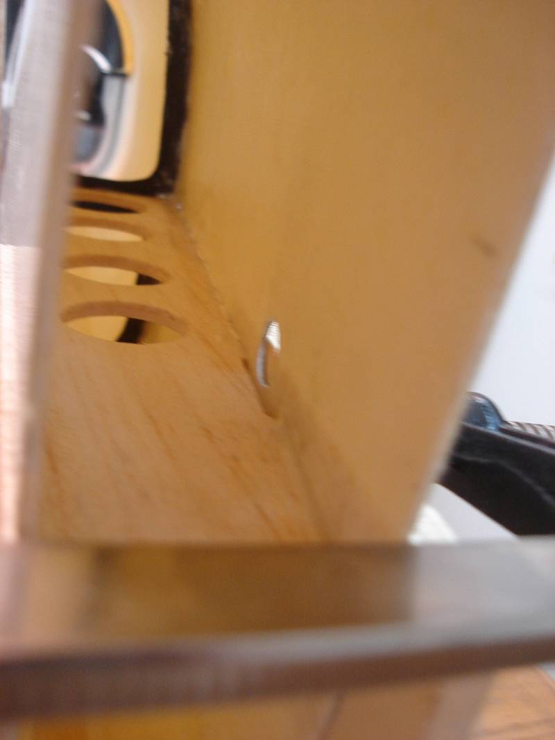

Default RE: Electric Osmose Building

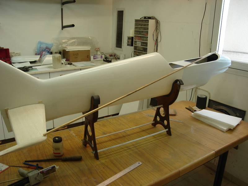

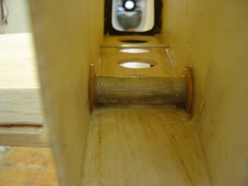

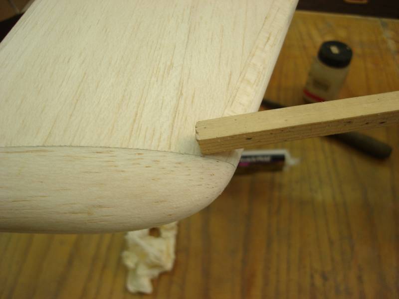

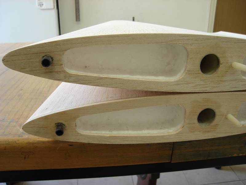

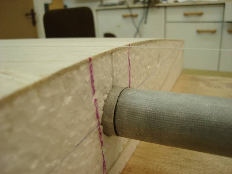

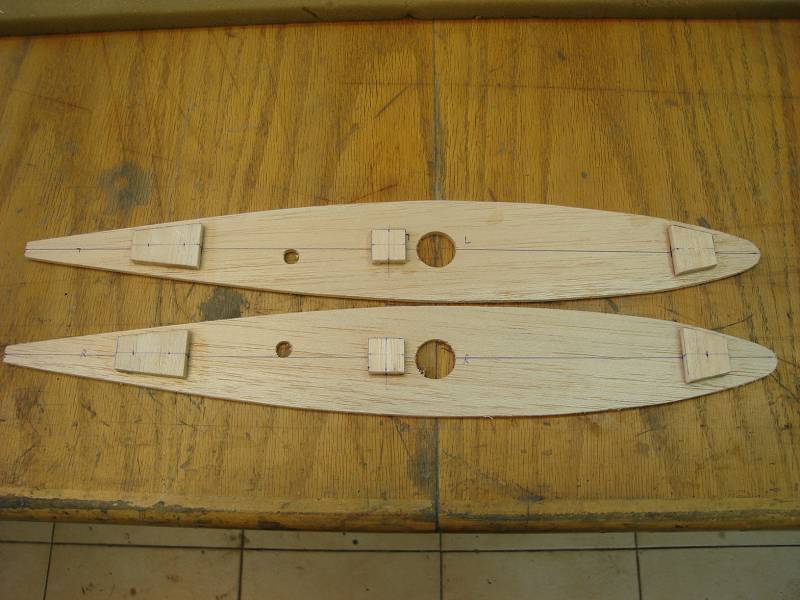

The plan is to remove the wing adjusters (Save 15.6 gram) after the completion of the wing adjustments.
The wing adjusters could be reassemble any time for further adjustments.

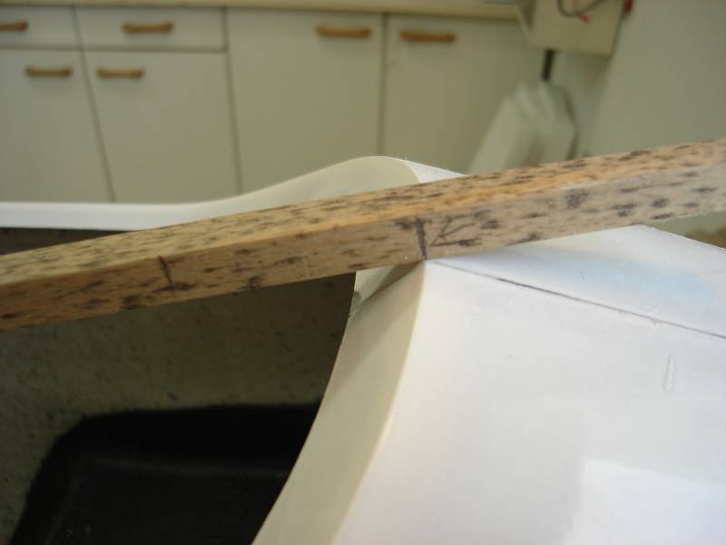

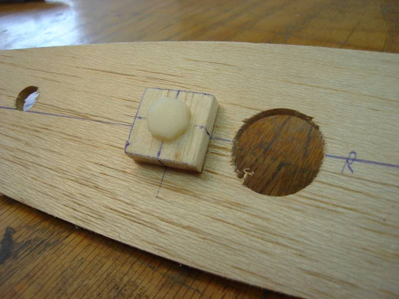

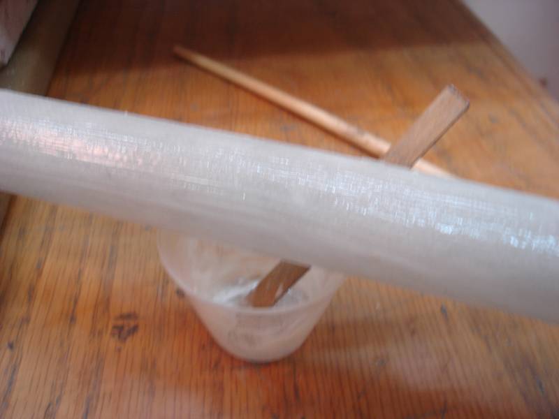

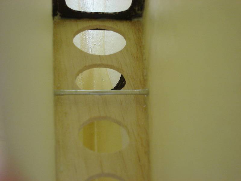

Saving 5 grams

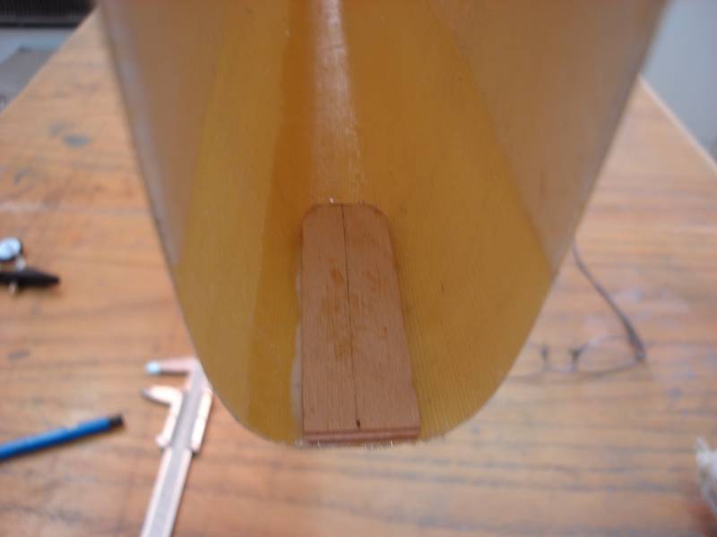

more

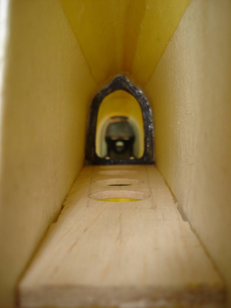

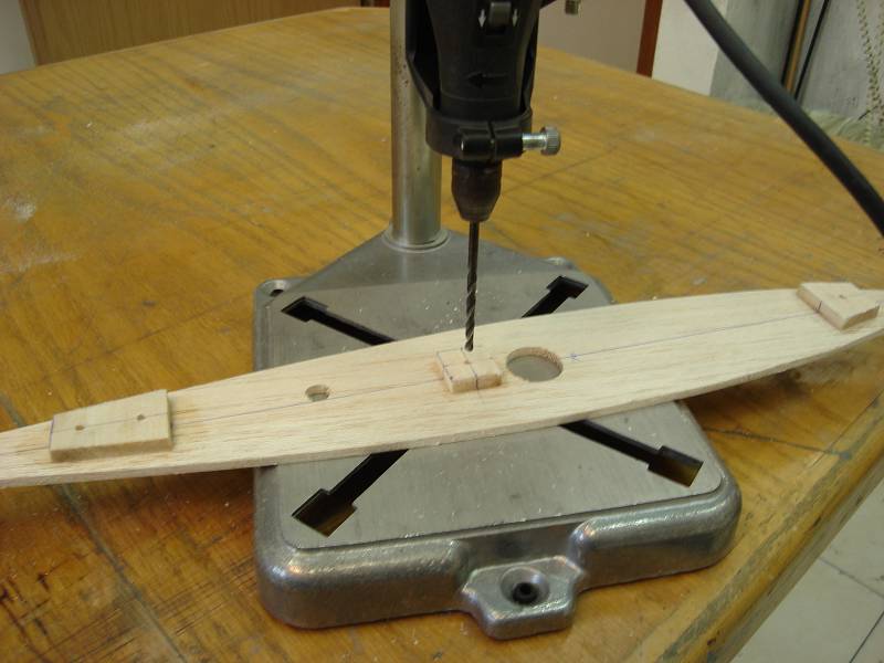

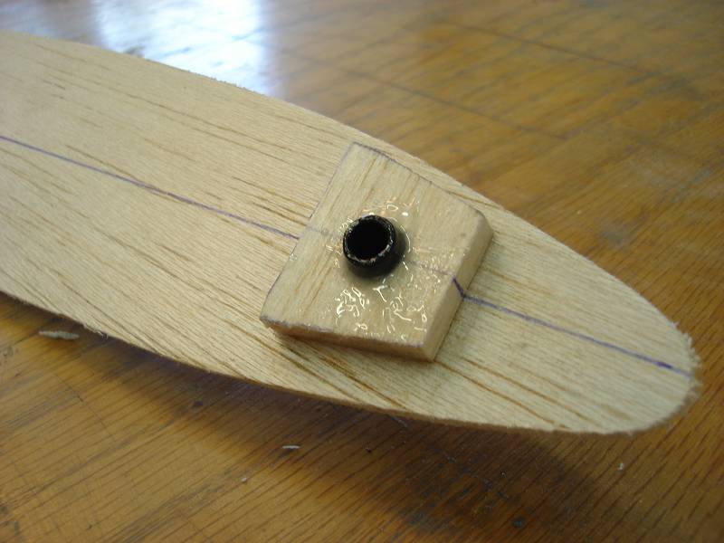

more

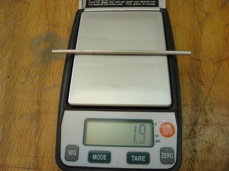

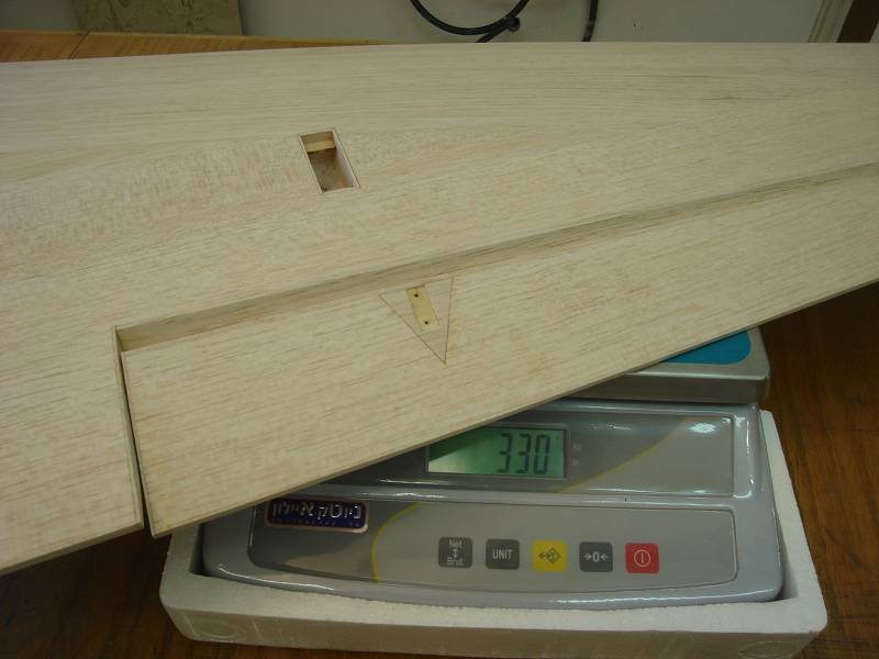

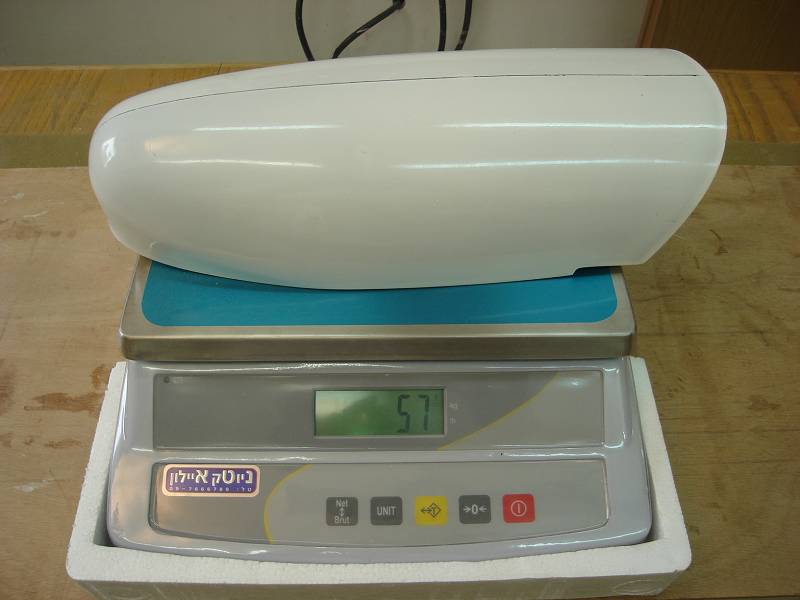

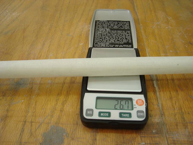

Here are the weight data of some parts

more

Saving 5.1 gram - replacing the 1/8" steel anti-rotation pin which comes with the kit, with 3mm aluminum rod.

hi nice work and fine pic..
do you have any ide ,, have many gram you have taken out of the kit at this point??
reg Torben PJ
ORIGINAL: Torben Parsberg
reg Torben PJ
Hi Torben
This is a kind of philosophy question (Is sanding the wing sheets Counts ?)
Generally every time I do something to save weight, I take a picture of the scale before and after the process.
Hope it helps
Isaac Najary
