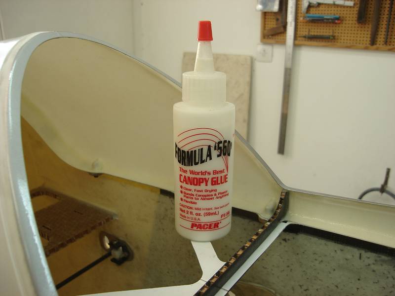

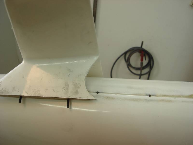

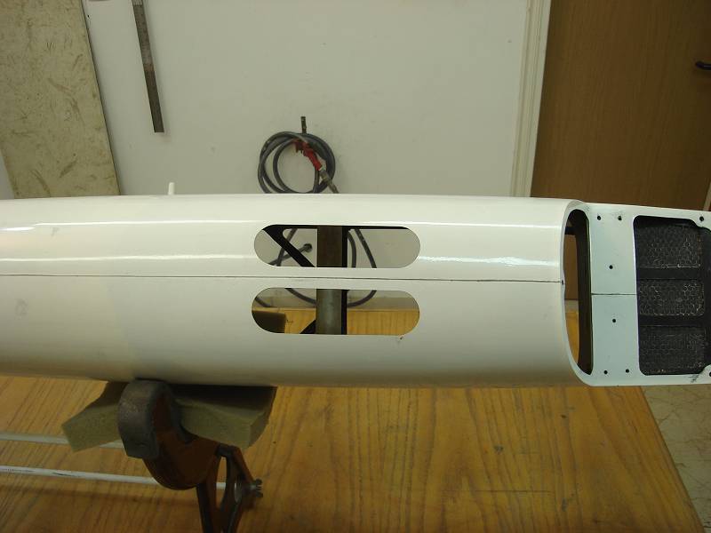

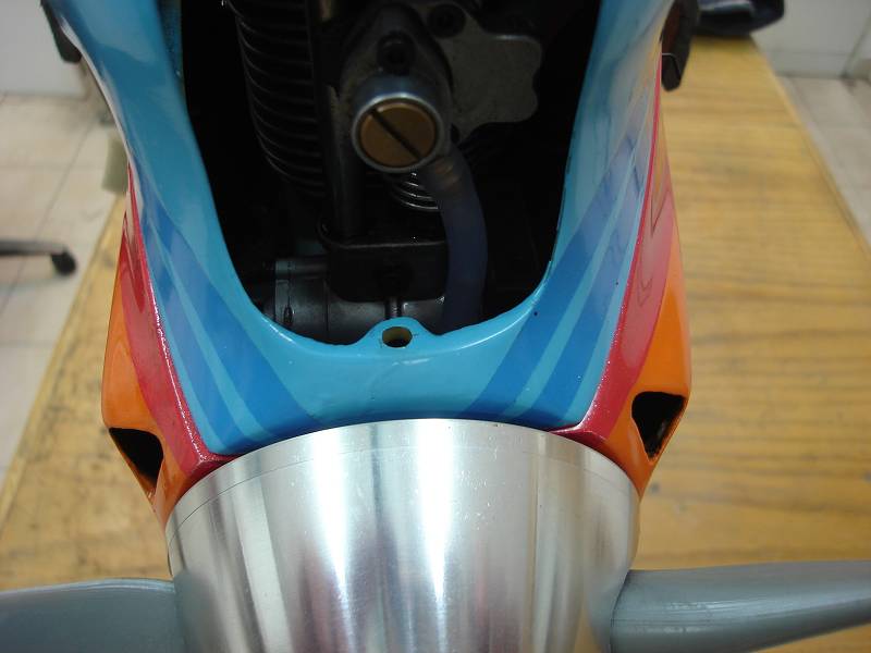

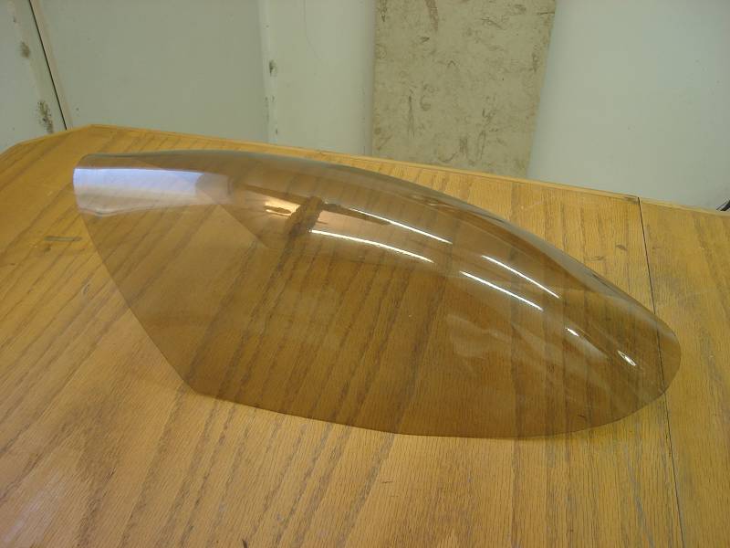

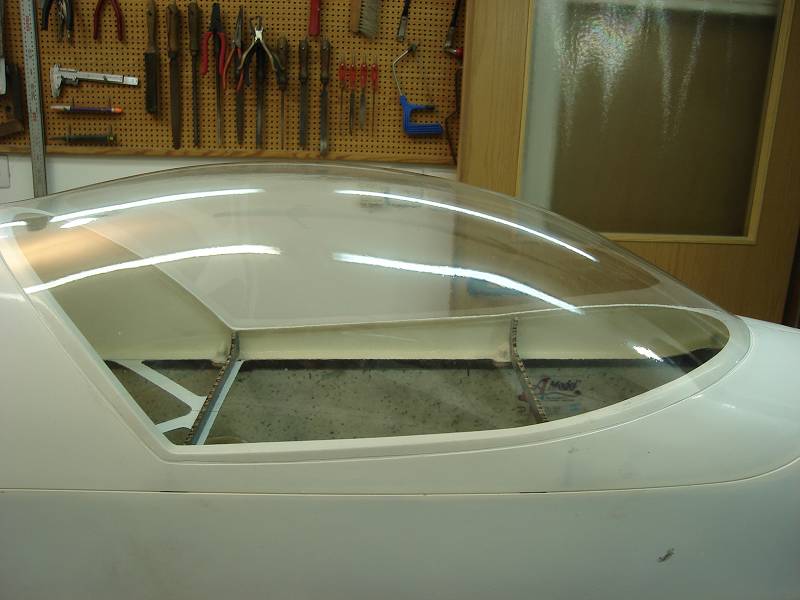

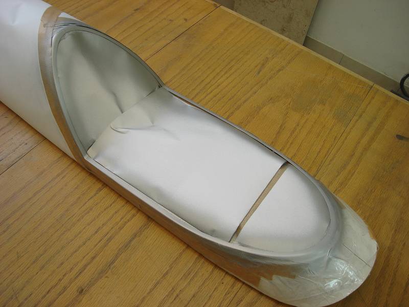

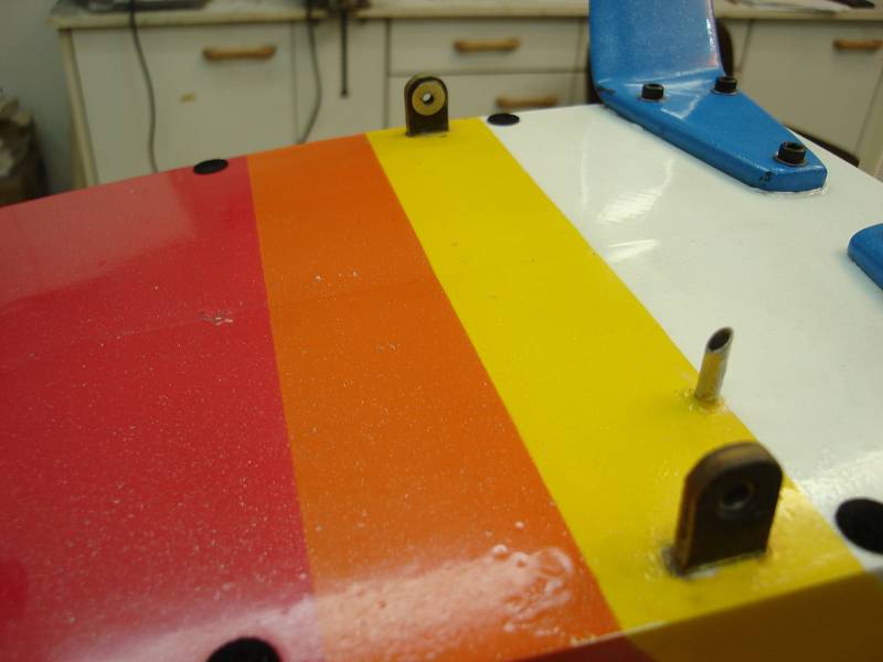

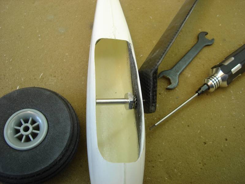

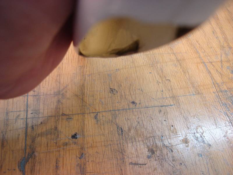

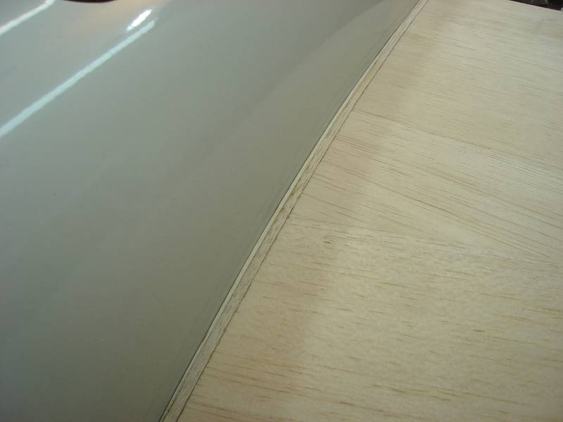

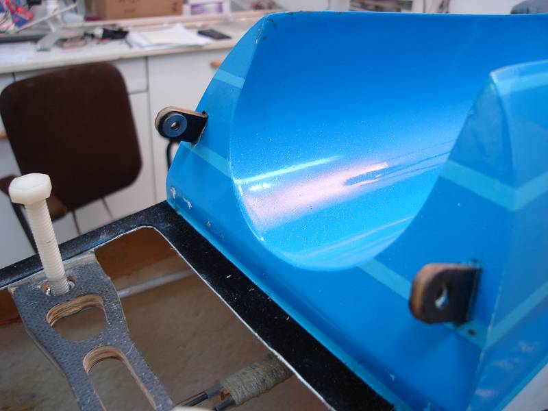

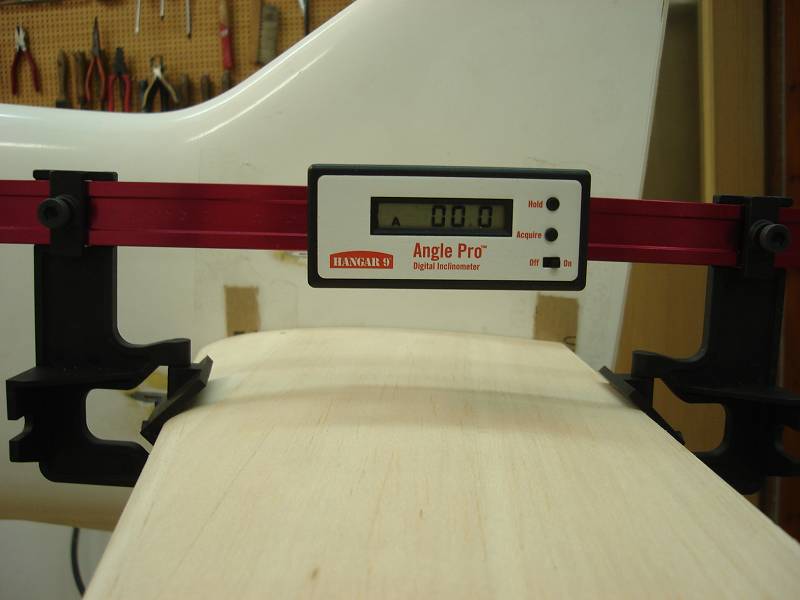

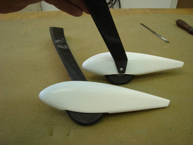

Hi Juan
For IC plane I will use ONLY bolts, 3 bolts for the belly pane and 4 bolts for the canopy.
Here is what I did on my Oxalys
Isaac Najary

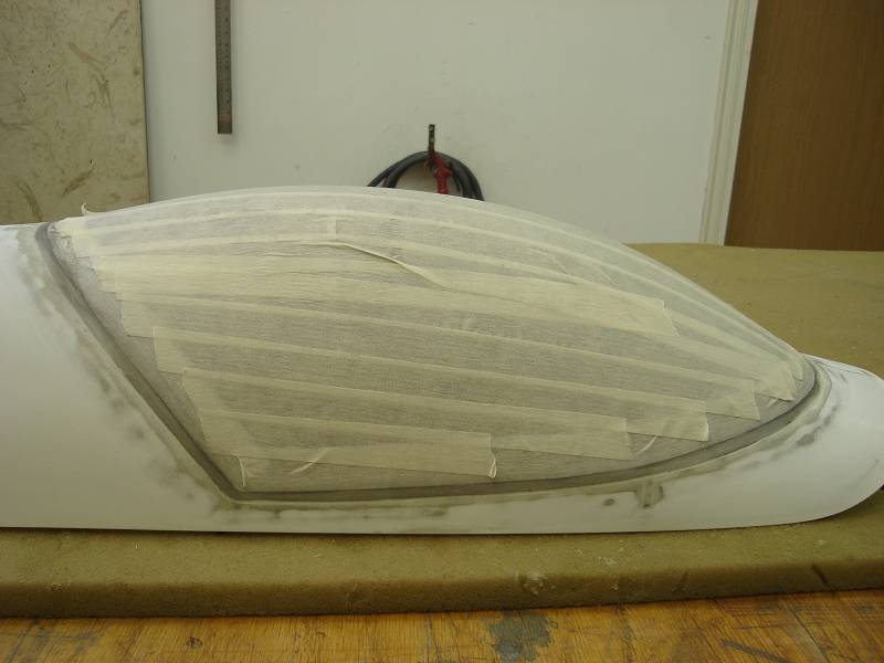

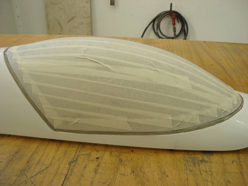

more

Old 01-03-2008 | 05:50 PM
  #154
ram_z's Avatar
Joined: Feb 2005
Posts: 183
Received 2 Likes on 1 Post
From: Ness-Ziona, ISRAEL
Default RE: Electric Osmose Building

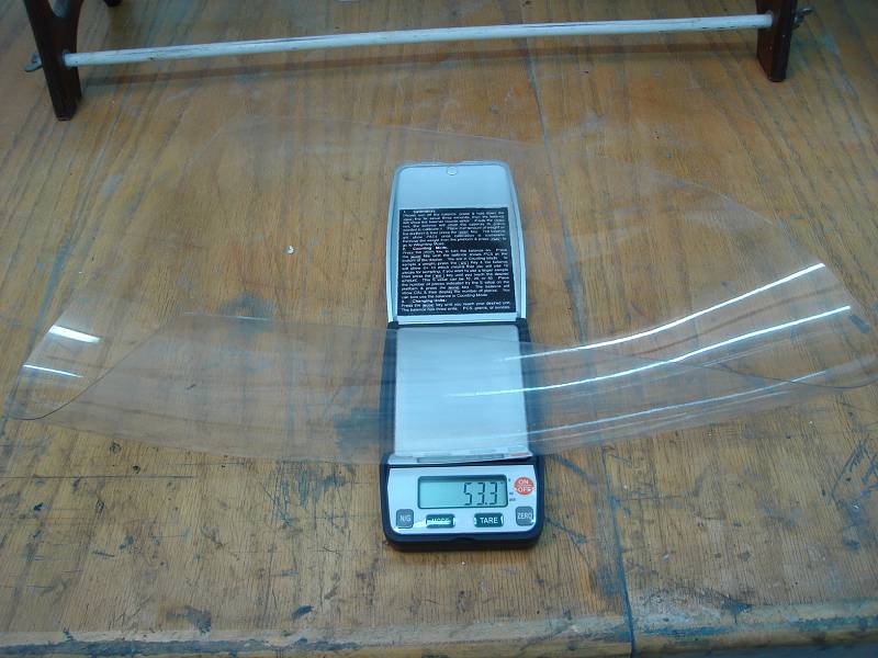

Hi Itzik
What is the final weight of the canopy after paint?
That photo is missing

ORIGINAL: ram_z
Hi Itzik

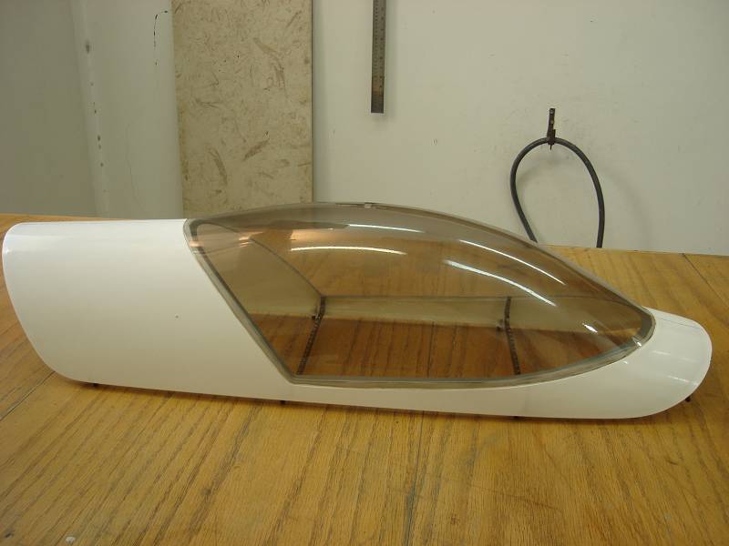

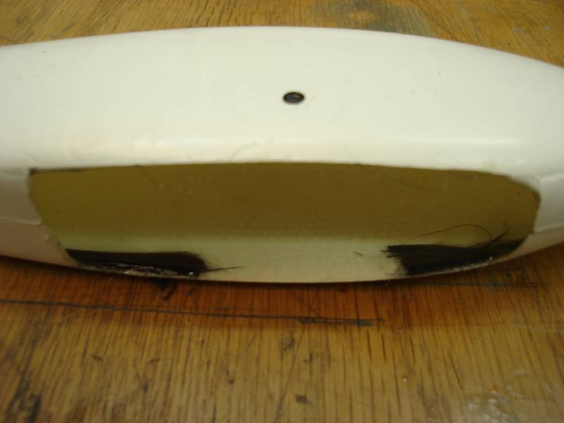

Hi Ram
Here it is.
Isaac Najary

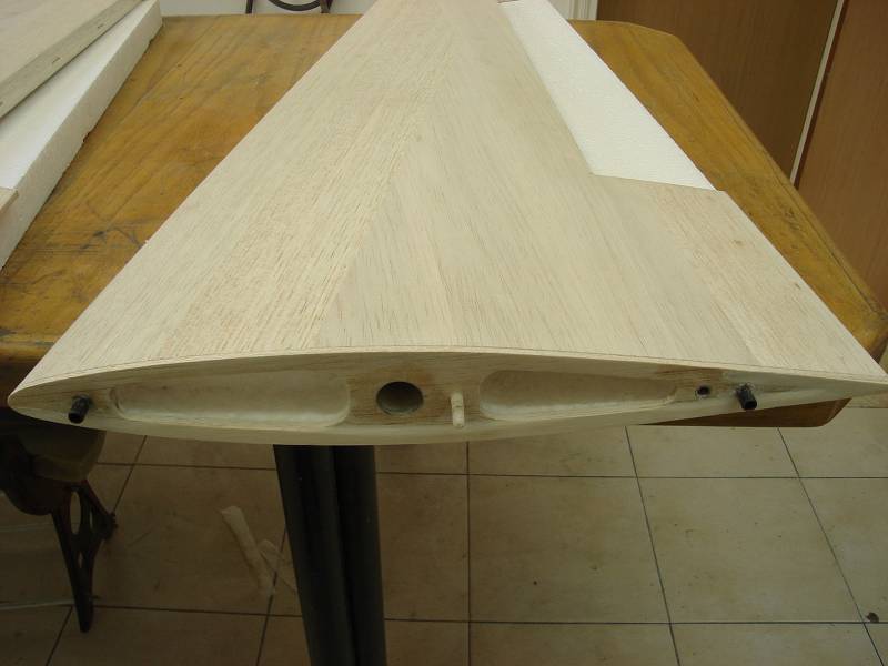

Hi Roly
Here is the link to the manufacturer of the honeycomb:
http://www.acp-composites.com/
These are the materials I use:
LP-21 1/8" Graphite/Balsa 225g 12" x 12" $28.00
LP-31 Glass/Nomex Panel 1/8" Thick x 12" x 24" $30.00
LP-37 Glass/Nomex Panel 1/4" Thick x 12" x 24" $30.00
LP-40 Carbon/Nomex Panel 1/8" Thick x 12" x 24" $41.00
I am going to use the ThunderPower Prolites 7.4 V 730 mah (TP730-2SPL) and PowerBox Digi-switch:

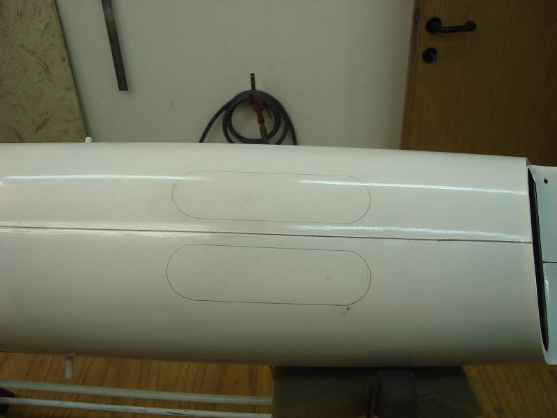

Old 01-12-2008 | 04:20 AM
  #171
amram's Avatar
Joined: Sep 2003
Posts: 358
From: Holon, ISRAEL
Izik,
I have a question:
What will happen if after cutting the 2 holes instead of the weight drops 2 grams it increases by 2 grams? How will you glue them back? ;-)
And a serious one: Aren’t you concern about affecting the fuselage structural strength
by cutting these ventilation holes so rear on the fuselage itself and not like we did on the ballypan on our Oxalys?
As expected at the beginning: This is a Masterpieces post.
Any F3A Pilot any where in the world should <START HERE>
Amram
Old 01-12-2008 | 08:24 AM
  #172
najary's Avatar
Joined: May 2003
Posts: 1,201
Received 37 Likes on 32 Posts
From: Ramat Hashrone, ISRAEL
[quote]ORIGINAL: amram
Izik,
I have a question:
Amram
Hi Amram
This is the stiffest place of the fuselage (under the wing tube), I cut the bottom of the fuse, no the sides of the fuse, so I don't think it will affect the structural strength.
Isaac Najary
