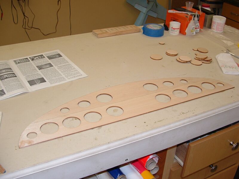

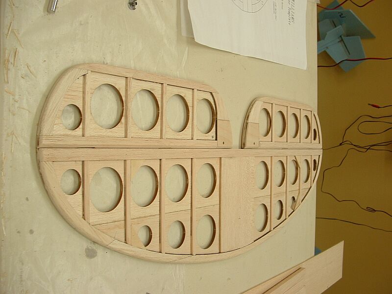

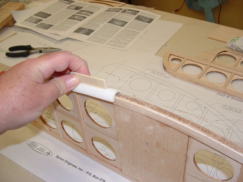

Well the build is progressing. Got off track with spring Honey Do's [&o]
The Horizontal Stab is pretty straightforward. The Keel components are butt glued then the TE 1/2 in balsa followed with the leading edge balsa parts. I glued the 4in wide center balsa after marking the cut line for the LE section. Cap strips added. I just need to add the 1/8 ply supports for the stab flying wires.
Pete

Elevators are also per plans. I did cut the LE balsa too long but was able to notch it out and properly place the E2 balsa and lite ply parts. The TE balsa was placed and then the cap strips. I lined up the strips based on the corresponding stab strip.
Pete

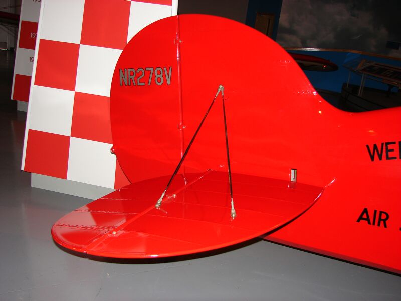

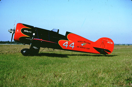

Found some more photo's these are the Modell 44 Wedell-Williams was built by Jim Clevenger
Pete

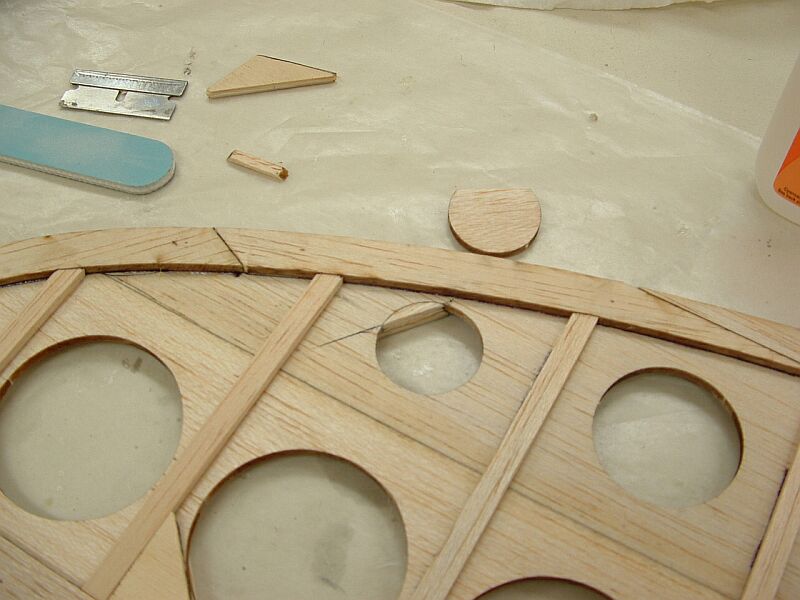

Added the 1/8 ply plates to anchor the Stab flying wires. Used the balsa circle scrap as filler where the plates overlapped the lightening holes. Rough sanded the elevators and started the Rudder.

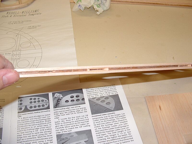

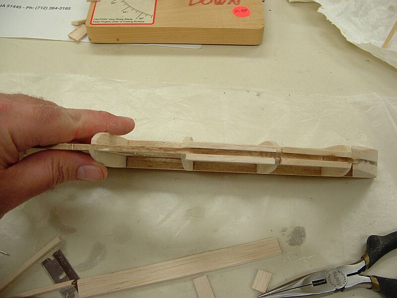

Finished the Horizontal stab and elevators as well as most of the Rudder. To get a consistent shape I used a piece of pvc pipe cut it's length with sandpaper glued on. Same done on the elevators. Drill pressed the holes for the blind nuts. Table saw for the bevel and set the hinges leaving no gap. The blind nut needed to be trimmed where it was overlapping the bevel.
The Rudder ribs were missing so they were made from scrap stock and placed. Top and bottom edge balsa added and the rough airfoil shape sanded.
Pete

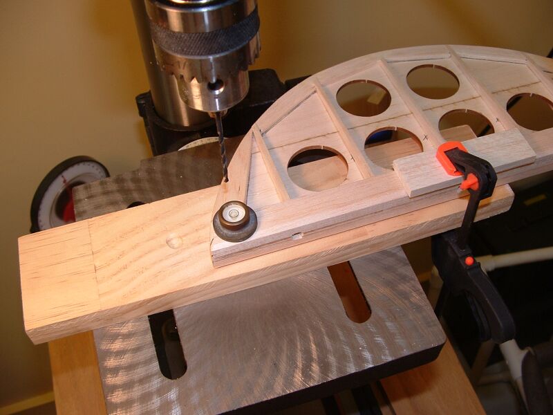

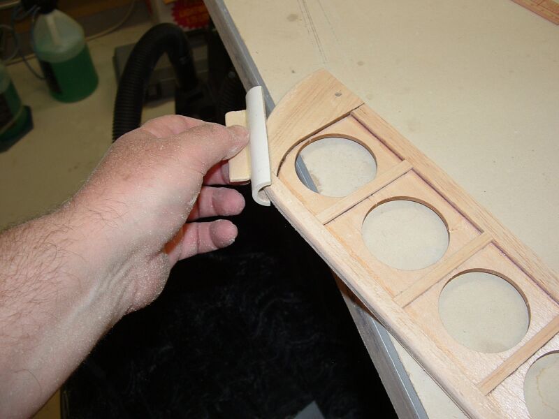

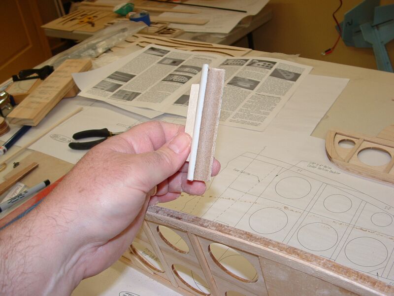

After going over the photo's of the #44 and 121 tail section I'm deviating from the plans to make the model more scale. The elevators and rudder are not tapered to the trailing edge as the plans call for. They are uniform in thickness with a rounded edge.
Look back on the prior post of the elevators. The dowel in the kit was drilled off center so I fabricated another, The position marked and drilled then epoxied in place. I added 1/8 ply on each side of the TE to thicken it then rough sanded to shape. Filler added and will sand and round the edge. Another item are the flying wires the #44 plane has 1 anchor point the #121 has 2 so I'll have to commit to a final version soon.
Pete
