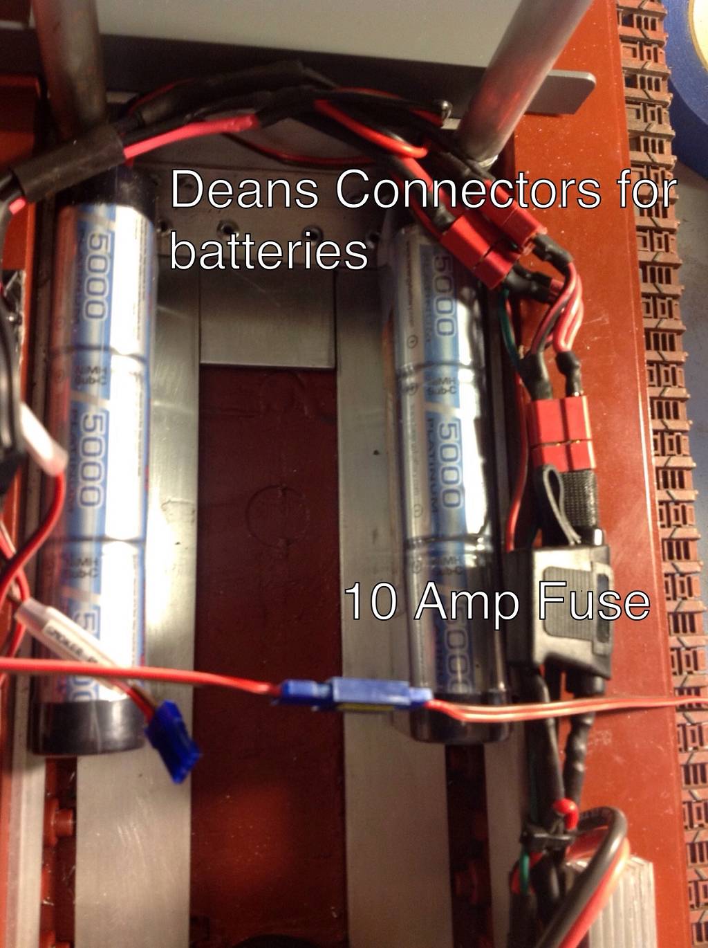

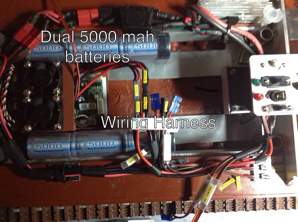

The King Tiger layout has a custom aluminum frame with a front and back bulkhead. The front bulkhead separates the 480 cans and Mato gears from the remainder of the interior. The back bulkhead provides not only the structural rigidity that the Heng Long is lacking (especially when the battery box is removed), but the mounting point for the Control Panel that houses the switches and charge ports.
A word of warning, the Control Panel was neat to build - except I forgot that the turret would interfere with the access cover.
I mounted the two 5000 may batteries toward the front of the KT to keep the tank balanced.

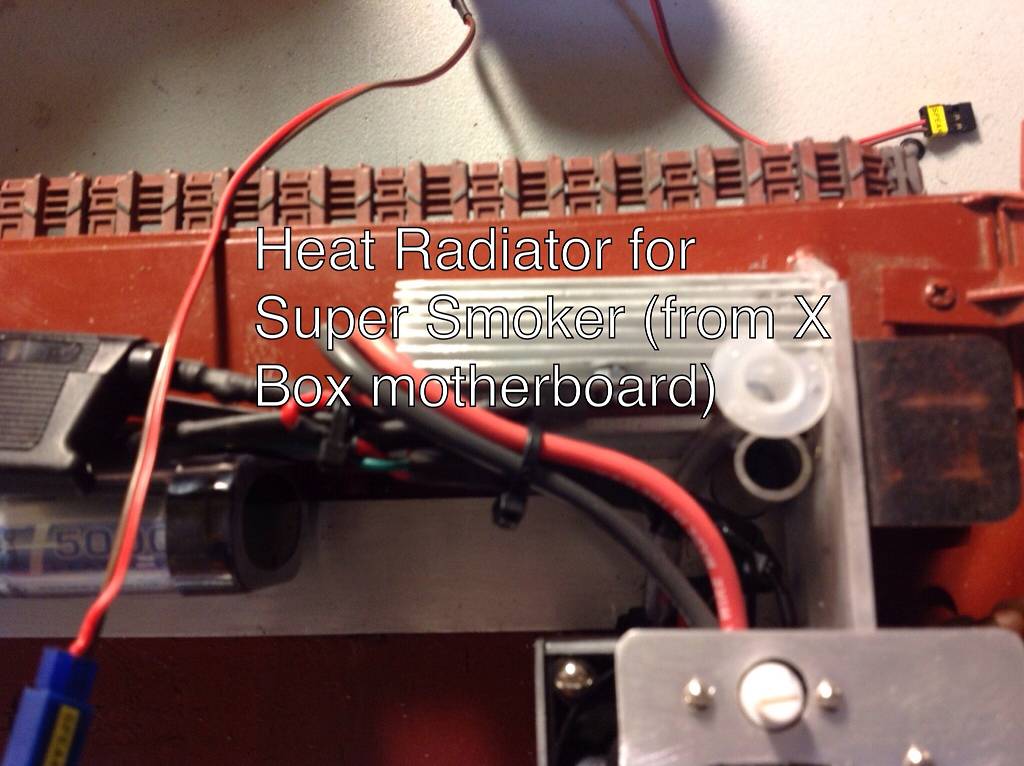

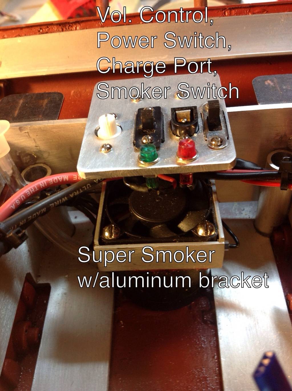

I used a heat sink from a broken X BOX that my son had and I cut it down and mounted it for additional heat dissipation from the Super Smoker. The Super Smoker puts out a lot of heat and in the Phoenix area, heat can be a most challenging issue.......
The fuse box and 10 amp fuse is also mounted on the top rail of the KT. I have had several issues with blowing the 10 amp fuse, but I am hesitant to go with the next size up which is a 15 amp fuse. There was a Spirited discussion on another post about how fuses work.

The Control Panel is an aluminum cut panel mounted on the back cross brace with the Super Smoker mounted underneath it. Make certain that the bottom of the panel is sprayed with a insulating material so you do not have a short.

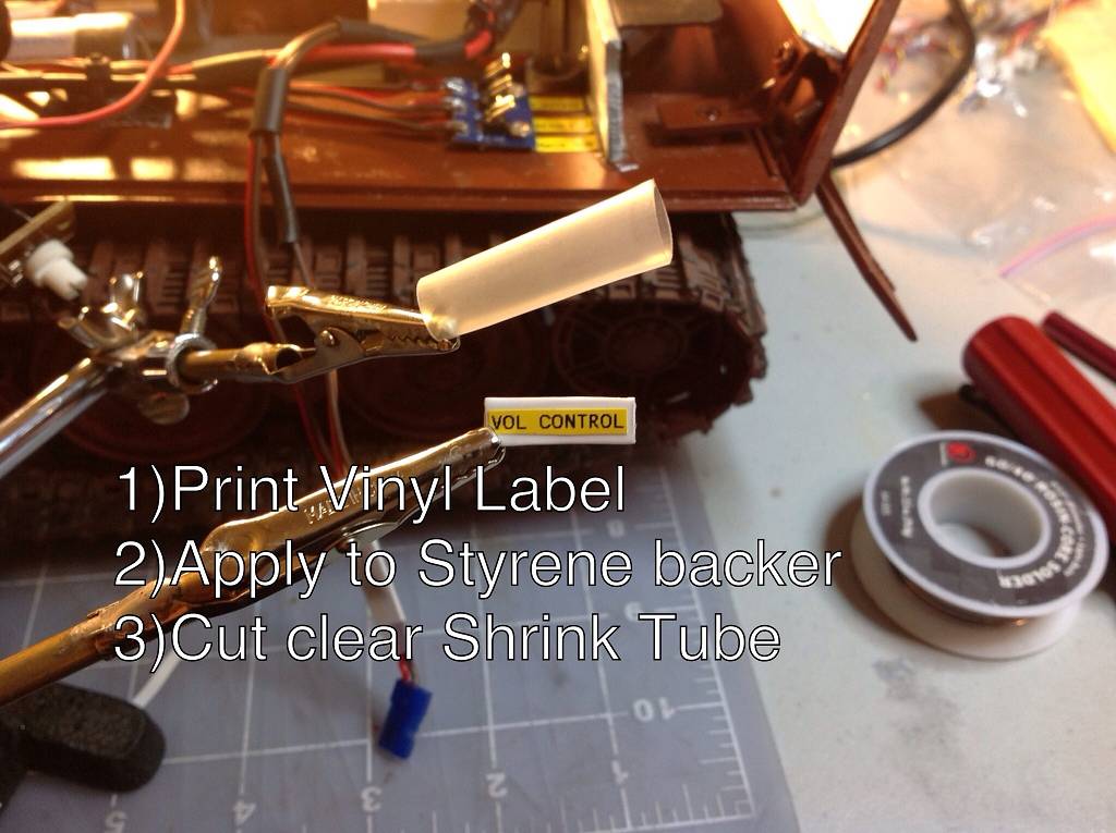

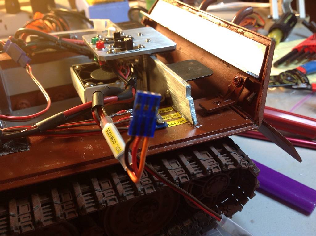

A key issue for me in wiring is to properly mark ALL WIRES.
I bought a Home Depot vinyl printer that is great. To mark the wires (servo lead wiring), I cut a piece of styrene to use as a backer, print the label and I then cut a slightly larger piece of clear heat shrink tubing. By carefully placing the styrene board and the heat shrink (sometimes I have to use a dab of glue to hold it) and applying heat, it makes for a very durable and professional lable.

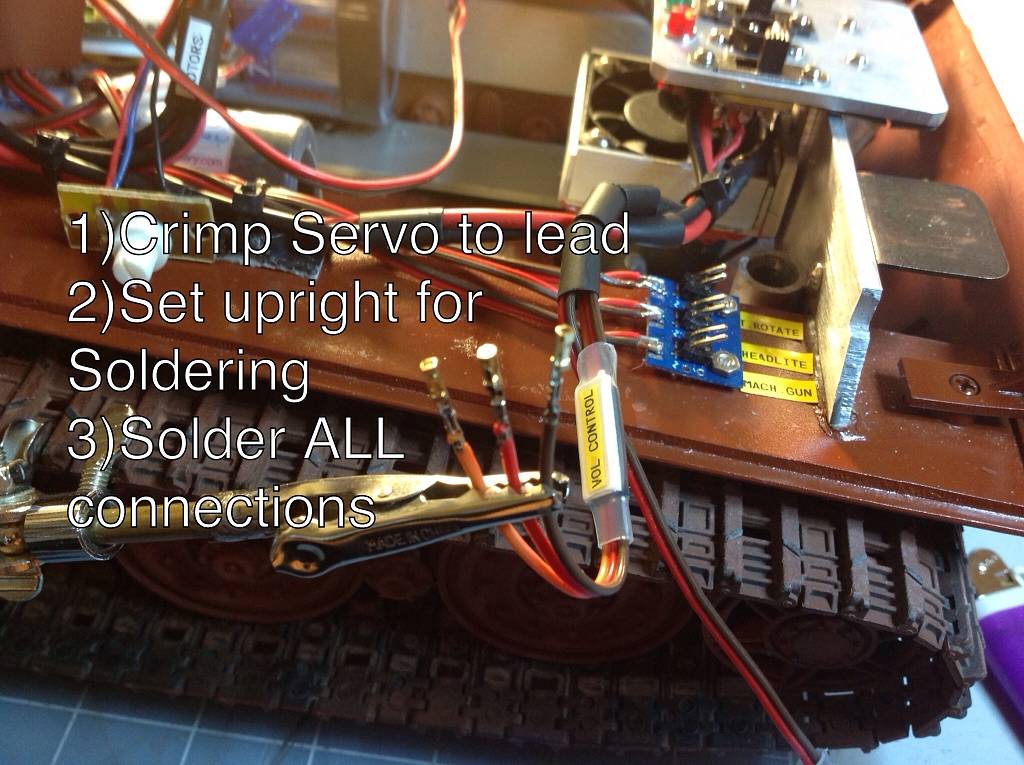

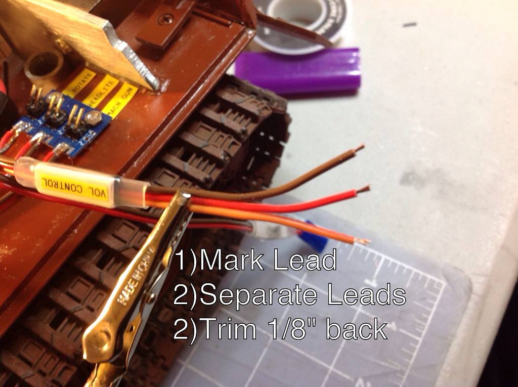

When I started this project, I have never built a tank before (outside of crashing helicopters, I hadn't build a model in 20 years). A key issue was what type of wiring I was going to use.
After reading about wire sizes, resistance, etc., I decided to use a quality servo wire for all the wiring except for the batteries and fuse block where I used a heavier gauge wire along with Deans Connectors.
Hanson Hobbies has a great selection of all sorts of connectors.
After ruining (many) connections, I finally found a process that worked for me.
1)Make your label AND APPLY it before you start the servo leads and connector.
2)Separate the wires by about 1",
3)Cut the end of each servo wire by about 1/8" -,
4)Use the correct servo end, place it in your servo crimper and let the insulation on the wire slightly enter the end of the connector and crimp hard,
5)Place the servo connector Upright and carefully solder the end (make certain that the solder does not flow Up into the connector's end),

Make certain the Servo Connectors are wired correctly.
With the plastic servo housing that has the connector tab "openings" facing up, slide each connector up and into the housing.
Make certain that you use the same wiring schema.
I use SIGNAL, POWER and NEGATIVE.
If you are wiring for a simple power run, you can still use the servo housing, but skip the first section that would normally house the SIGNAL lead and insert the POWER and then NEGATIVE lead.
By making the first servo connection "female", you can make the attaching servo connection by using the "male" ends and slide in the larger plastic housing. You can directly label these types of connections.

Here is my modifed Tamiya recoil and 35mm camera flash system.
The entire Turret top is held in place with strong magnets so all the flash, barrel motor etc are mounted, velcro and snapped
in place on the turrent floor so and all tech items can be quicklyrepaired, changed out and removed in the field!

I'll like to share a small tutorial section I made with photos for those who are interested.<div>Some parts are supplied by me and therefore not found when you buy them yourselves.</div><div>
</div><div>E.g: L-bracket and steel wires.</div><div>
</div><div>Nonetheless, I hope this helps some of us who are having a hard time with the installation.</div><div>
</div><div>Installation is done based on a stock heng long panzer iv IR,S&S.</div><div>Servo elevations and servo recoil included.</div><div>
</div><div><span style="font-family: '.HelveticaNeueUI'; font-size: 15px; line-height: 19px; white-space: nowrap; -webkit-tap-highlight-color: rgba(26, 26, 26, 0.296875); -webkit-composition-fill-color: rgba(175, 192, 227, 0.230469); -webkit-composition-frame-color: rgba(77, 128, 180, 0.230469); ">http://gassembly.wordpress.com/2013/02/14/how-to-install-the-tk22-board-on-a-stock-heng-long-tank/</span></div>
