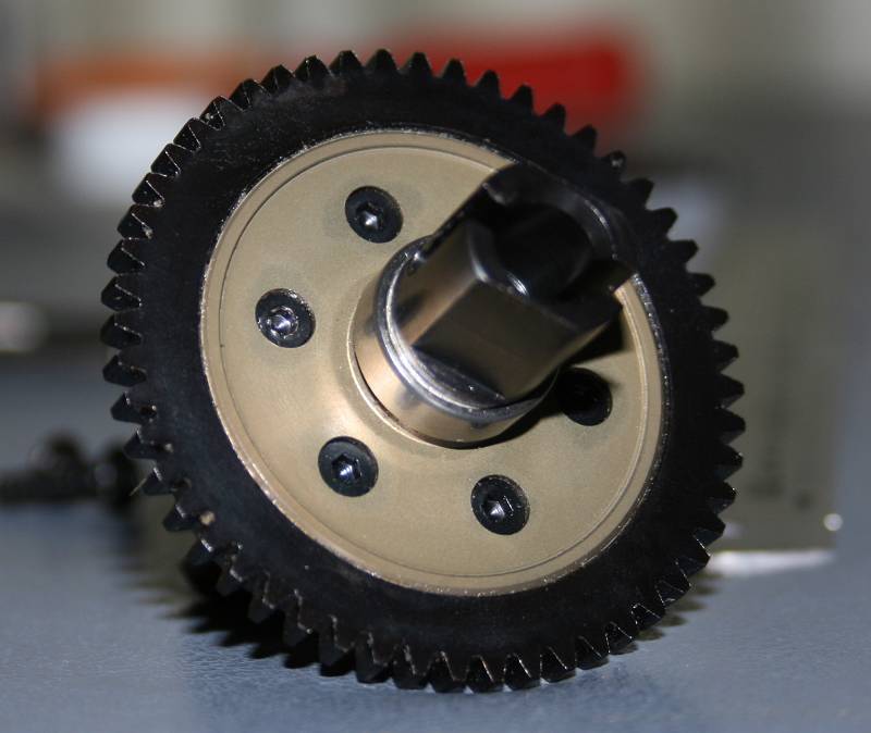

I have rounded off one of the hex head screws on my spider diff, does anyone have any ideas on how I can get this screw out?

Welcome to the Hyper ST Pro "spider diff" club. I rounded off two of my screws the first time. My buddy rounded off all six. They really lock the screws down. You will have to dremel the screws out. Cut a slit as if it were a flat head screw and turn it out. You will cut a little into the metal diff, but it will be fine. It really sucks!!

what u can do is get a small flat grindeing wheel that goes with a dremel and grind a line thru the top of the head for a flat head screw driver..carefull not to grind the crown gear to much.
you can drill the screw , then use a screw retractor...be carefull
did you use locktight in the screws??if so the before you try turning the screws heat the screw up with a soldering iron to heat the lock tight up..just put the iron ontop of the screw head..
failing all that , send it to me

Thanks for the help I will try cutting a slot in the head.
I didnt use loctite, it happened when I was tightening the screws after I had changed the diff oil. I couldnt belive it, brand new truggy.
The metal used on the screws seems really soft.

yeah i had 3 strip on the way in, had to back them out with pliers. its like once in a while they aren't as deep as the others so the hex slips and kills it. i have the engine to put on, glue the tires and a couple more colors on the body and she'll be ready for a LONG day at the track tomorrow, well worth the wait. i might get the hyper 7 to 8.5 conversion done too if i go quick enough.

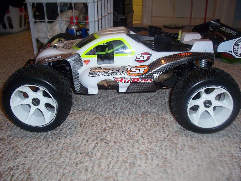

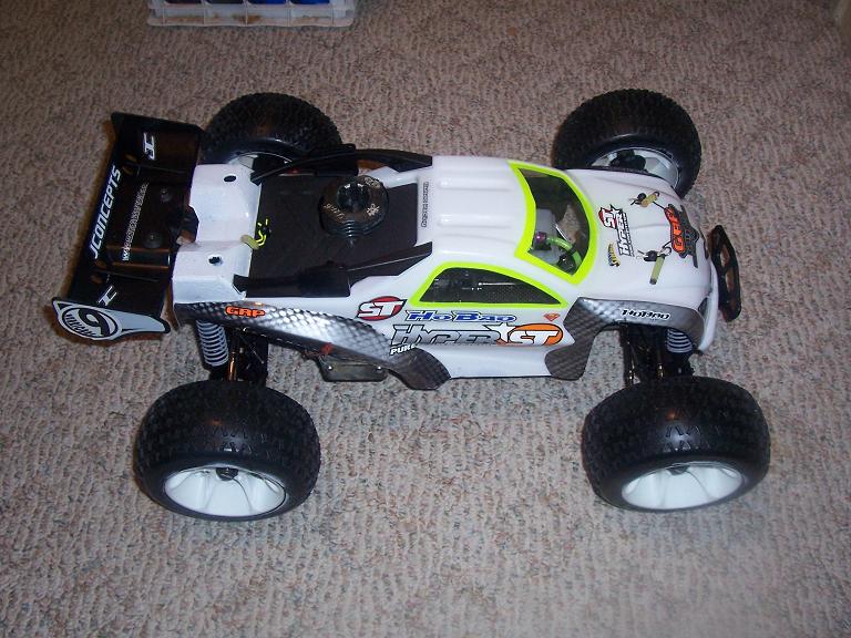

got her done late last night, took about 6 hours total with paint, tires, some small mods and engine. i took it to the track today and it drives so smooth, just point and trigger. the stock tires are really good, i have the proline mt molded foam inserts in there, nice fit too. i ran the first tank and did the usual, check temps, adjusted trim and tuned engine. then disaster, my "tank" of a truggy would not turn to the right. i picked it up and the screw on the left knuckle fell out, no big, longer screw with nut and problem solved. started it up and after 1/2 a lap it would not turn left, right knuckle screw this time. then in the next 1/2 tank botht the screws fell out of the steering turnbuckle. none were locktited cause these are on-off type screws. they all have nuts on them now and stay tight, easy fix. i ran 4 more tanks and the truck was solid, few flips, bad landings, many pipes. the only change i need to make for tomorrow is thicker fluid in the shocks, i used 45 rear and 50 front after drilling 2 screws on the pistons, i'll go to 80-70 for tomorrow. i used a spare hyper 7 diff in the center (identical to the front and rear) with a 46 tooth spur and 13 tooth clutch. i'll have a 12t tomorrow too. another thing i like is the inside is so clean, track was still damp from rain on monday. here's some pics, i stuck with the white primary color as the st just loks really good in white.

I see you used the spare hyper 7 diff. I know you said it would fit and have been watching one on ebay but now since you have it in there and it does fit for sure I will click BUY IT NOW!!! Hope I hear from you that it does not push coming out of the turns on power at all!! That is the only problem I have and I know its because of that spider diff!
