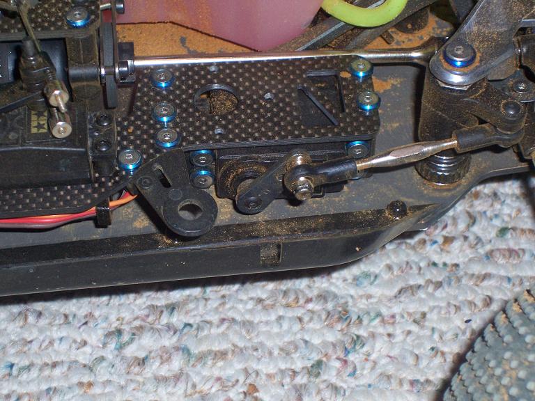

i did a small steering mod to the front arm today, seemed to help plenty. just dremmeled a bit where the nut goes into the knuckle. at full turn the nut was rubbing a spot on the arm so i grinded the hole thing off. there isn't supposed to be a nut there but the screws kept falling out on me.

ORIGINAL: j_blaze
I had that happened, but I used loc-tite and it never happened again.

ORIGINAL: jaywax
ORIGINAL: j_blaze
i didn't want to locktite it in and then strip the screw trying to get it out, these screws are stripping easy on me, may be old tools. its kickin' with the nut though, loving the truck.

mate .ive just had a close look at what your doin here and well it aint going to do much..
when you lock your wheels this far, the steering nuckle hits the lower arm but if you look at the inside of your wheel rim its hitting the steering rod..so no matter how far you turn the wheel it still hits the stock tires..thus no advantage in steering
sorry,..but are you useing the stock wheels tires???if not then disregard what ive said

ORIGINAL: wrat
you're right, but where its at now the grp tires don't hit the arm, i'll have to check the stock tires though. if they do it could ruin the wheel or the arm[]. turns great though, i use the 15mm extensions on the grp's, they have no offset.
