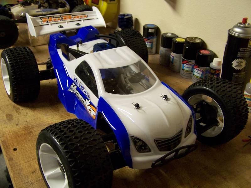

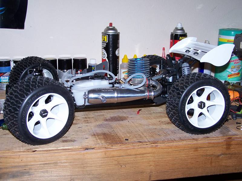

I couldn't wait! The day I got it I stay up from 8pm till 2am putting it together and then brought it to work with me and instead of doing work all day I was building it on my bench! lol Here are some more pics of the radio tray and brake setup. I also got a motor from a friend today for me to use for now until I decide on a new one. It is a .28 from CEN. Hope it will be good. Cannot mount it yet because I have to get some spacers to space it up because it hits the chassis. I guess these mounts are set up for a bump box.

Just bought a Hyper ST Pro for my first build and, after reading the instruction manual, I came up with a question about the use of the taping screws in the assembly of the front shock tower and rear shock tower. I suppose, they are used to go through the CNC towers into the plastic gear boxes to bring them up nice and tight. Or, are there regular machine screws in the kit I should be using?
Vnmsgt great looking build.
Thanks.[sm=confused.gif]

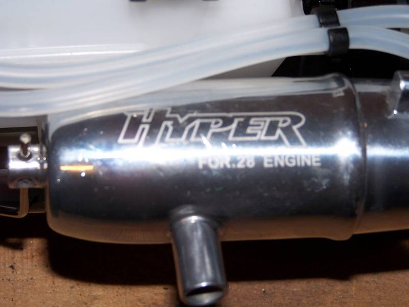

YES TAKE APART THE SPIDER DIFF!!! I did on mine that I just built and it had about enough grease as me spitting one time[X(]. Hardly any at all. I removed what was in there as if there was any anyways and put diff fluid in. If you run it with that amount of grease I guarantee you will blow up that diff very QUICKLY!

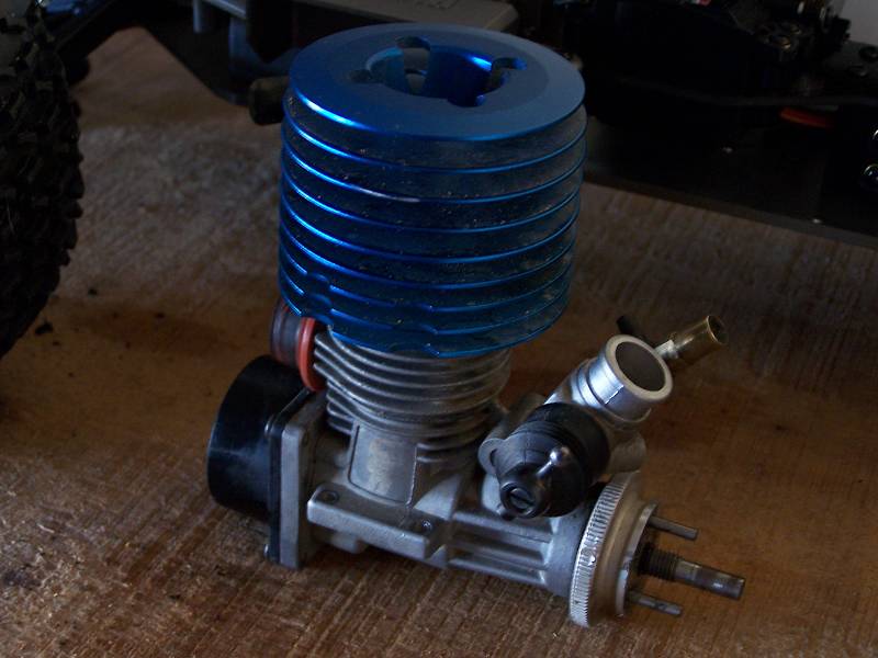

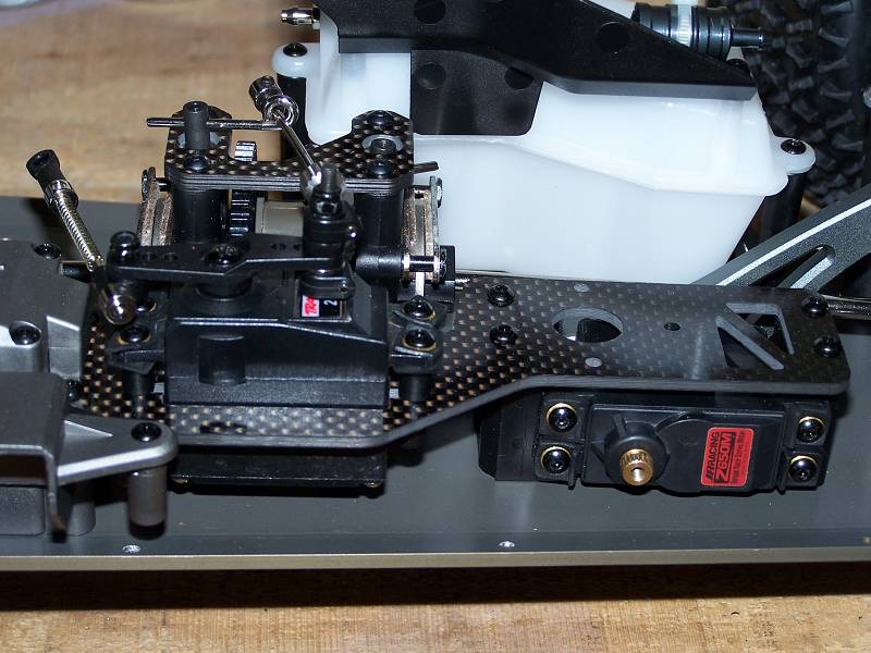

Almost done!!! Just bolted in the motor and pipe and fuel line and was testing the servos and brakes. Had to shim up the motor for the mounts that came with it because it is set up for a starter box and I am using a rotorstart. Just used to nuts to move it up. Found out I put the top of the center diff mounts on backwards and holes for the brake cams were too far away for the brakes to work. Other than that it is going good. Hope to have it running tomorrow night. We'll see.

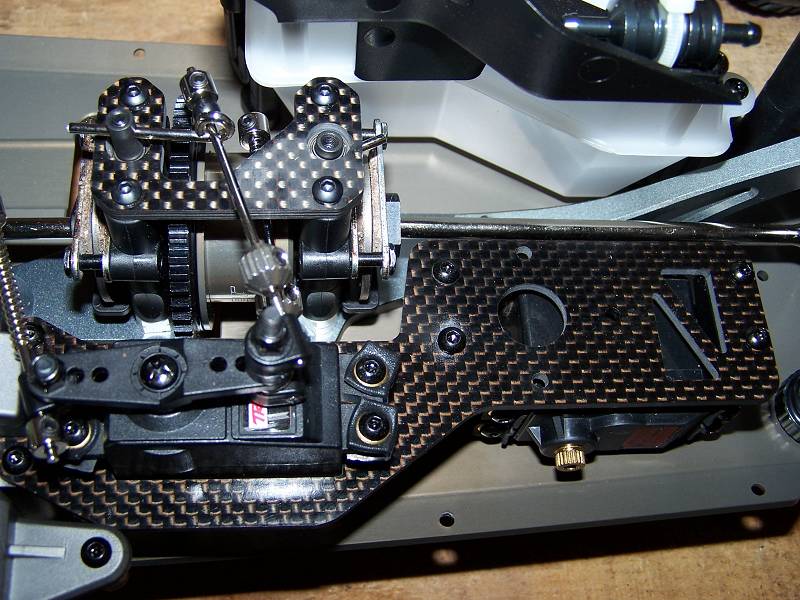

Forgot, Here are some more pics.

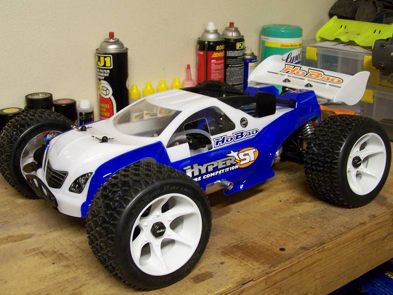

You should be able to taste this pretty good! lol FINALLY DONE[sm=redface.gif][sm=redface.gif][sm=redface.gif]!! I am going to take it for a shakedown run tomorrow night. But for now here are some pics of it finished with the body on!
