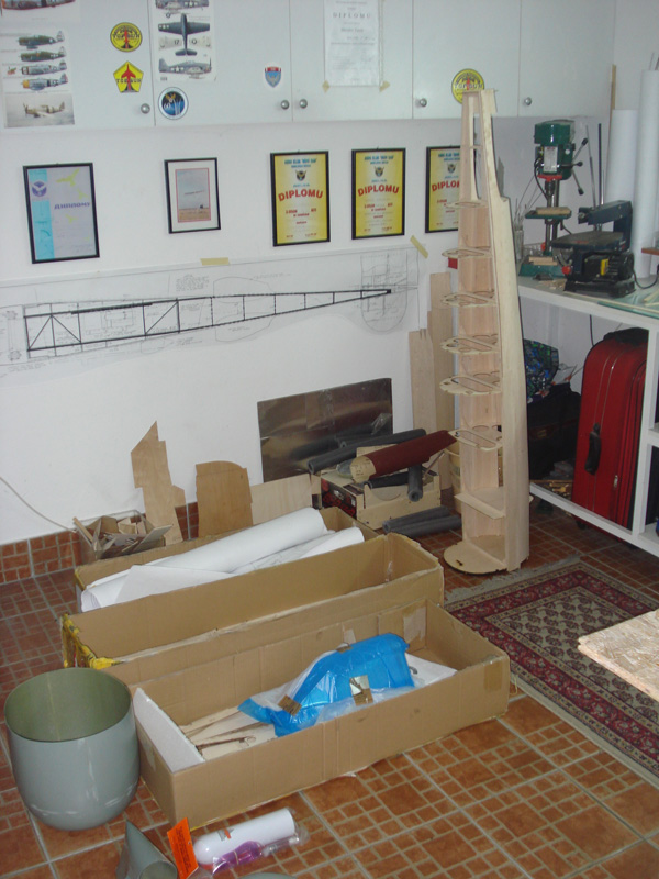

As the title says, this will be my next Meister Scale project... Plan was to made Meister Focke Wulf, but I get opportunity to buy parts and plans for Meister Zero, and I don't want to miss it.
Story is interesting, because I bring, from my Top Gun trip this year, short kit, plan, cowl, and some other parts, to my friend, who want to made this model.

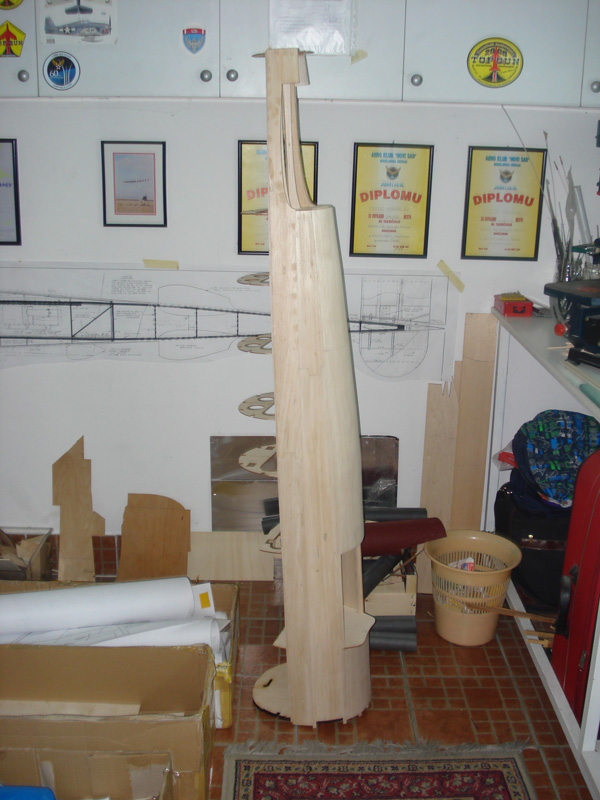

He start working on fuselage, and made very nice job on it, but few day ago he called me, and sad that want to sell everything.

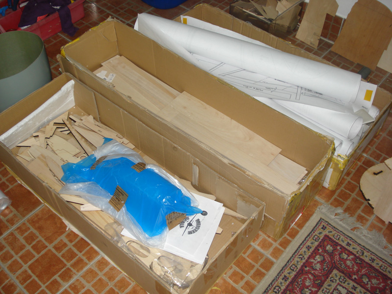

In meantime he bought a lot off balsa, I think it's enough for this project, and for price he ask, I take all from him...
This building will be interesting, because Wayne and Garry made Meister Scale Zeros also. Only difference between our models is I will made Zero with wooden fuselage.
I will made a lot of pictures, of all building steps, same like on my Meistre P 47 topic ( http://www.rcuniverse.com/forum/m_10794600/tm.htm ), but for first steps in fuselage building process, please visit Zero page on our Serbian Forum:
http://www.rcfly4um.org/index.php/topic,9574.0.html
That is part of building I wasn't made, but it can be interesting for modelers which want to made Meister Scale Zero with wooden fuselage.
Today my friend come to me bringing fuselage and other parts...
