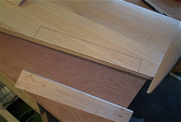

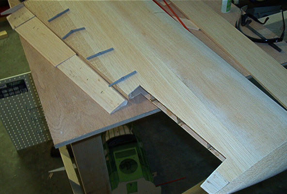

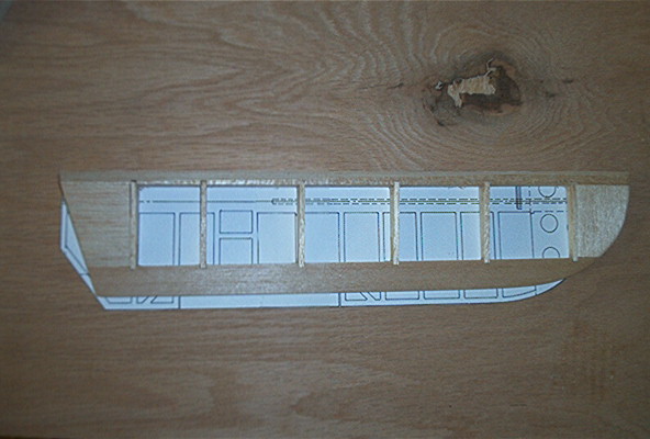

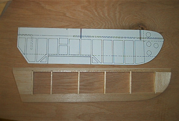

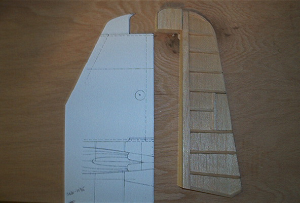

Thaaanks iiiat! I think I saw a picture of your tail wheel set up on here, nice work. Anything beats having the tail wheel come off the rudder in my opinion, even if you just make it non-retractable in the scale location. I'm not to worried about the CG on this plane, I know that the nose has been lengthened quite a bit and I'm not going to mess with that, good idea to mount the throttle servo up front. So you didn't even have to have the battery under the engine? I think I'm going to use my trusty Dave Brown feather weight wheels, scaled out of course! I'm adding a full cockpit, but it's very light weight.
I've been working on the wing mostly, did finish construction on the rudder, need to cut into the fin and get the hinge line right.
Marked out the ailerons and cut those out, this is going to be fun because I'm using scale hinging on them. No servo in the wingtips, I'm upgrading to bell-cranks so everything will be hidden. For the flaps they will be hinged with giant robart hinge points on the bottom. The length of the flaps are all wrong, but I just want them to work good and slow the plane down.
You can see that the true size of the elevator is actually bigger than the ones supplied, just have to take an inch off the tip of the stab. I'm using scale hinging on the elevators with a hidden control rod, this is easy to do with PC board material for hinges. I'll post more pictures as I get all this done.
Dion

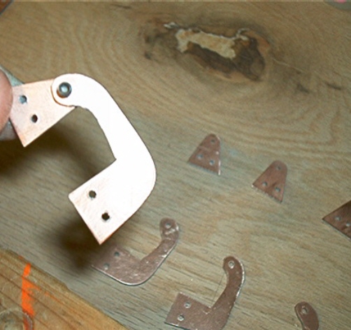

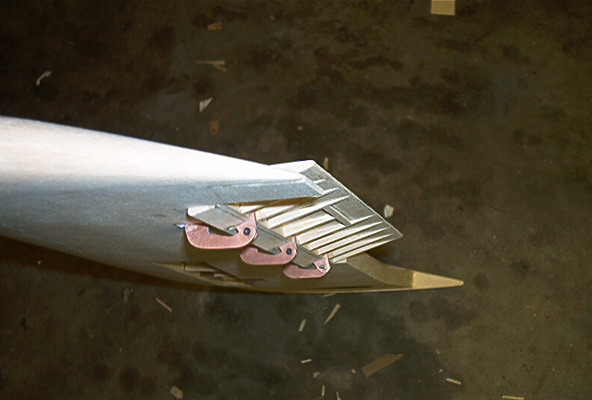

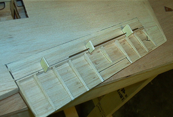

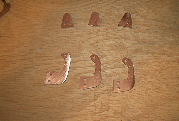

Look at those Hellcat aileron hinges (full scale), they were cool. Big and bulky, stuck right out in the wind, looked like the rest of the fighter.
I cut the hinges and drilled the appropriate holes. The small hinge part that is attached to the aileron is then tapped out so that a 2.56 bolt can be used to hold the ailerons on.
I used ply hinge guides to make sure I had perfect alignment of the hinges in the aileron while the glue dried. Then you can attach the other end of the hinge and use it to Dremel out the other slot. I glued the ailerons to the wing earlier and sanded them for a perfect fit. Remove them after the hinges are installed.
The hinges are now installed and work great, both form and function, now that’s cool! The pushrod will be attached to the top of the aileron and then a small 1/64†ply strip will be used as a gap filler on the top of the wing.

Yes, this is G10 epoxy with about 2oz coper plating. Very strong stuff! Fun to work with too, you can make and do so many things with it. Glad you like my bash!

G10 / FR4 is an epoxy-impregnated fiberglass laminate with excellent electrical insulation characteristics. G10 FR4 meets UL-94 requirements and maintains high dielectric stability and strength. It is used primarily in electrical and electronics applications but also finds use where high mechanical strength is desired.
I use the non-plated board for stuff that does not need solder, like the servo arm on my retract tailwheel. Yes it takes solder very well and it holds too, it's really amazing. I could have used the non-plated stuff on my hinges but I only have a limited amount of that and I'm saving it for another project.
