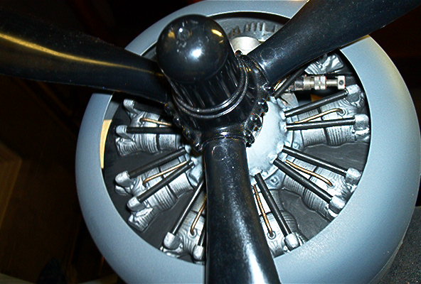

For those that don't know what the old Royal Radial looked like, here are some pictures. It does not have the rocker arm housings, I added those by cutting a balsa stick in about 1/4" sections and gluing them on. Lightly sanded and painted you can then use 1/8" plastic tube for the push-rods. Of course you know that the engine should be mounted to a sheet of 1/8" ply. The last picture is the radial I painted.
Dion

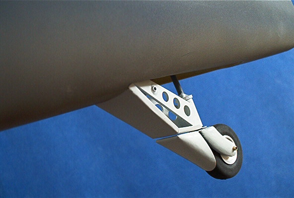

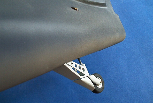

I need some help with a tail wheel decision, look at the first picture and tell me what tail wheel to use! Just kidding, actually I did consider the Robart one but it's to short, so I made a scale one. It's very lite, made mostly out of PC board and aluminum flashing, the only brass is the wheel mount tube.

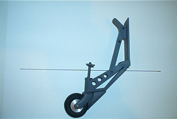

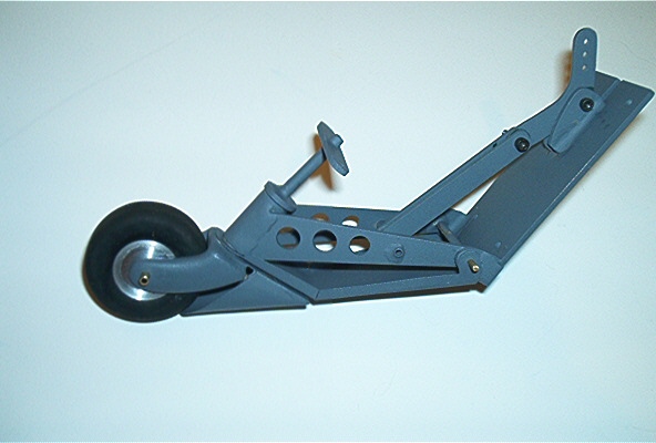

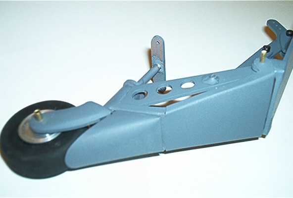

I cut the tail cone off and then cut a generous opening for the tail wheel. It can be tough working inside a finished glass fuselage.
Using the outside shape of the fuselage as a guide I cut a plywood template for the tail wheel mount. I pulled all the plastic pushrod out far enough so that they won't interfere but not to far, I may be able to use some of them.
I attached the tail wheel to the ply former and I managed to get all of that in through the tail wheel opening for a test fitting.
I had to go outside to take a picture of the internal fitting of the ply former, but you can see it's a pretty good fit.
Dion

The tail wheel mounted to the plywood comes in at a hefty 1 3/4 ounces, think that'll work? It's just a 1/8 thick ply bulkhead, should be fine. I'm going to make the tail cone removable so that I can get to the linkage and remove the tail wheel if needed.
