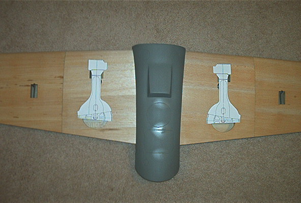

Dion I got the same one on ebay , not bad at all , are you going to modify the airlerons to scale size ? I think the real ones were larger and deeper into the wing
Old 01-08-2006 | 06:25 PM
  #463
dionysusbacchus's Avatar
My Feedback: (25)
Joined: Dec 2002
Posts: 2,490
From: McQueeney, TX
Default RE: CMP Hellcat
Yea, it's the ebay one. I am going to install scale ailerons and hinging just because it's easy and looks cool. Also it will allow me to hide the push-rod.
ORIGINAL: LDM
Dion I got the same one on ebay , not bad at all , are you going to modify the ailerons to scale size ? I think the real ones were larger and deeper into the wing
I wanted to chop the wing to see how it looks so I cut the flap trailing edge off with the wire.
Then measured in 2 7/8" and cut the wing on my band-saw. This will put you at the second ply rib.
Next I cleaned off the Ply center section rib and glued it back on to the wing. I saved the dowel supports in the leading edge and re-installed them.
I cut 5 3/4" off the aluminum joiner tube.
More to come...

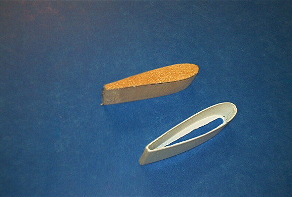

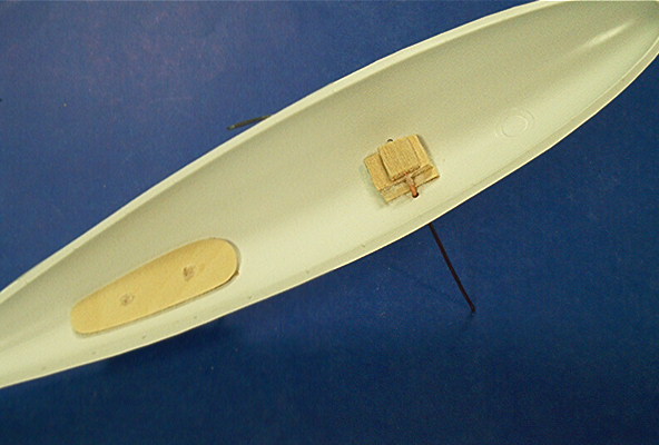

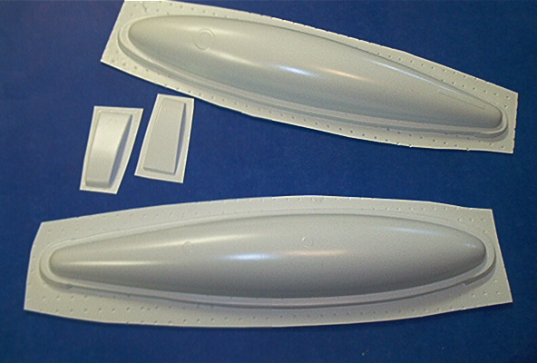

Got the drop tank installation almost done, I've got an appointment so I'll just post what I have for now. First the basic pieces. I glued the pylon together and opened the top completely and the bottom about 1/4" and inserted a balsa plug.
I attached the pylon and then drilled 2 1/8" holes, inserted 1/8 dowel and cut one off flush. Also I have a 1/8" piece of ply on the inside.
I used 1/8" soft copper wire to make the front supports, backed those up with a small piece of LT ply and some balsa.
Drilled the holes in the belly and installed it.
It will not be dropable but it will be easily removable. I still need to finish the installation and add the straps and some other details, I'll do that later on tonight.
