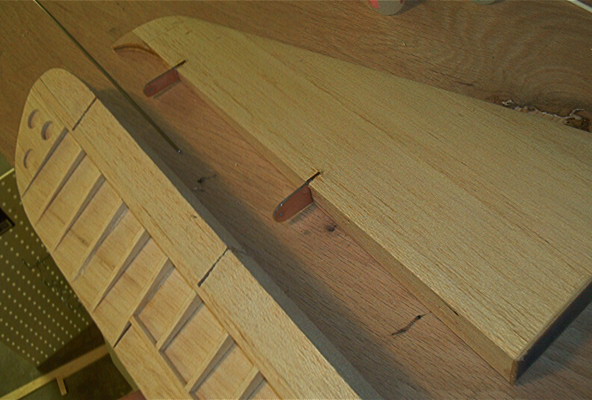

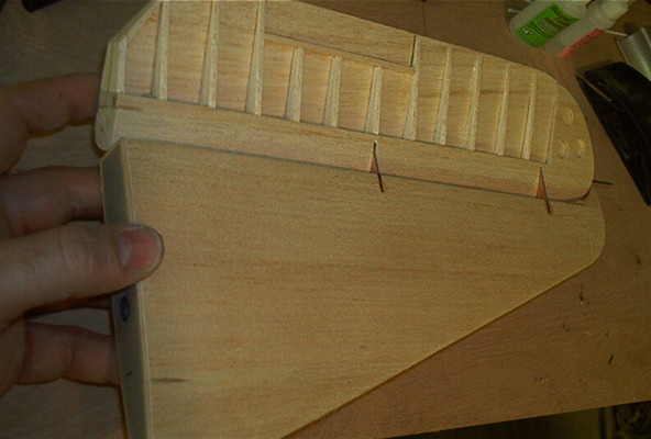

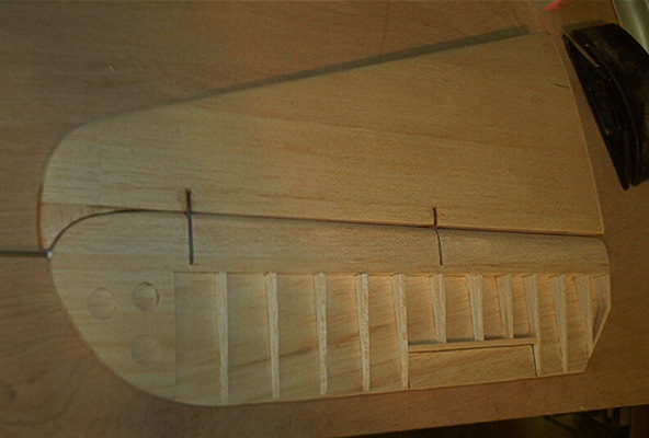

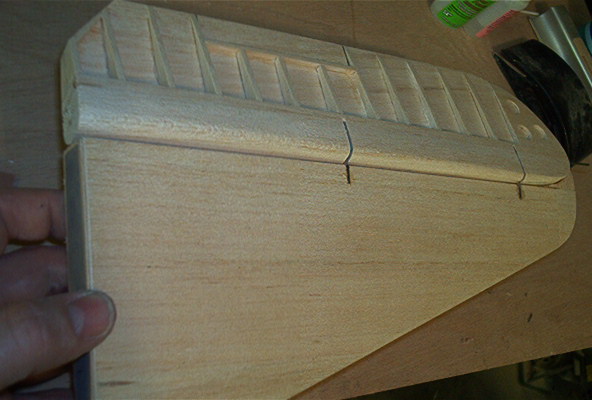

anybody else tested a different glue on the inside of CMP fues's ??
I haven't done a lot to the fuselage yet, but some of the formers were coming loose. I glued them with thin CA and a dash of Micro-Balloons. Get some Balloons in the groove and drop some CA over it, don't know if it'll hold with engine vibration but we'll see.

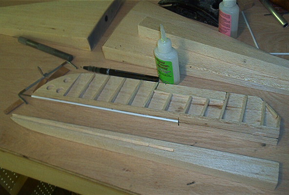

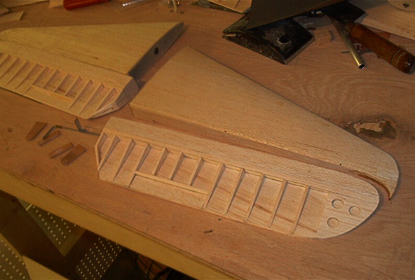

Finished the scale hinging for the elevators.
First picture shows the completely new elevators and hinges.
Next you can see how the leading edge of the elevator was made in two pieces and just tack glued together for shaping and sanding. I popped them apart and cut a grove for the 1/8 plastic tube. When that's finished glue the pieces permanently back together. Then cut the hinge slots.
After the slots are cut install the hinges into the elevator by inserting the metal rod. Then glue the hinges into the stab for perfect alignment.
Then you can see how they work, very smooth operation!
Dion

Dion,
Nice work as usual. How do you keep the rod in place?
Pete

Hi ya Pete! I'll just bend it over at the end and bury it in the elevator and hold it there with some glue. I'll get your drop tanks out this week Pete, I've been building this thing and doing a lot with the Boy Scouts, just got back from a camping trip!

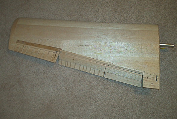

I have to finish the wing before I can install the stab and elevators although I have all of that finished and the mechanism figured out. It will have all the control linkage concealed. One thing on the fuselage and glue used to install the bulkheads, it looks like no sanding was done to the inner surface of the fuselage before they were glued in. That is a big factor in glue adhesion in my opinion.
When it was time for me to start on the flaps I was initially going to leave them as they were, but after hinging them they looked totally unsat! So I marked the scale size area on the wing and cut the whole back of the wing off! lol I know, when will it end right? Can't say really, but I feel like I'm getting close! I used the stock torque rod, just had to cut it down a bit. The flaps are connected with a pin, glued to the inner flap and slides in a hole on the other flap.
I installed the bellcrank and it works really nice, no hatches on the wing, just cover it with balsa and forget! I'm going to cover the wing trailing edge with 1/64 ply so that the flap on top looks very small as compared to the bottom.

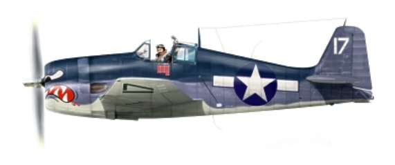

Thanks for the input all, I appreciate it! Richard that picture really makes it clear, thanks for posting it. I settled on the CJ gear, I called them and they will take the Corsair struts as part exchange. Got a great deal on the Corsair CJ's so even if I did have to pay $30 I'm still way ahead.
As soon as the gear come back I'll finish up the wing and glue the tail feathers on. I'm going to use this opportunity to demonstrate my ultra light and easy finishing system using thinned resin and thinned spot putty as a filler. Can't wait! This is going to get real fun![8D]
Anyone have a favorite Hellcat paint scheme they would like to share?
Dion

ORIGINAL: dionysusbacchus
I like your color scheme, but in overall glossy sea blue.

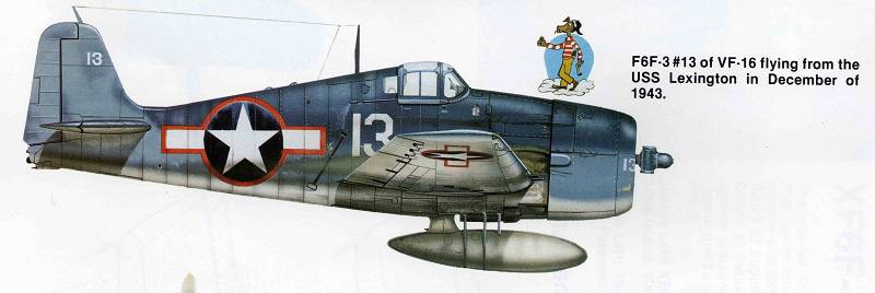

Dion:
How about this scheme.
Tri-color F6F3.
Terry
