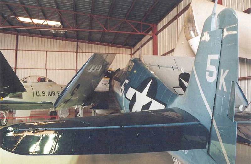

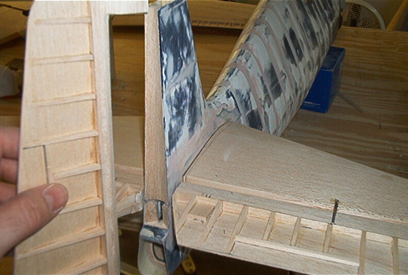

Dion, canopy showed up yesterday today was the first chance to take it out of box. Excellent. Spot on. Can't wait to get it painted and on the airplane..... only problem is now I need to find a worthy pilot.....
Dion, you're not considering doing a Hurricane anytime soon are you? There are some guys over on the KMP Hurri thread looking fora new canopy.....
Andy
Andy, Can't wait to see your plane with the new canopy, be sure and post some pictures!
A big NO on the Hurricane, sorry! I don't want to offend anyone but that is one ugly plane, I'd never consider building one, ever.
For those that might want to know why we are cutting the fillet off the fuselage, look at the picture of the full scale one!
Next my fuselage after cutting off the offending areas!
Hal pointed out the error I made with my measurements, so I'm just going to use the stock stab. I'll join it as one piece and slide it through the hole in back after I fill everything.
Dion

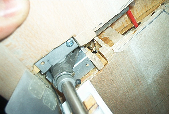

Here is a question for those who are using CJ retracts in their hellcat: when you mount the gear into their ply retract housings, the air nipple that is on the side of the retract( not the air fitting thats on the end of the cylinder but the other one) is too close to the ply rib, making the airline wanting to crimp together. How did you overcome that? I'm thinking that you took your dremel to the rib and cut a recess hole?) Pictures would be great if you have them !!
Thanks!!

ORIGINAL: JohnMcGowan
Thanks!!
John
Hi old buddy! I'll answer that with what I did. You need to just Dremel out a hole in the rib and run the air line through the wing to the center section. From the root side just work a hole in the balsa rib with a Philip's head screwdriver (don't have to be pretty) if you don't have a long drill bit. Hope this helps!
Dion

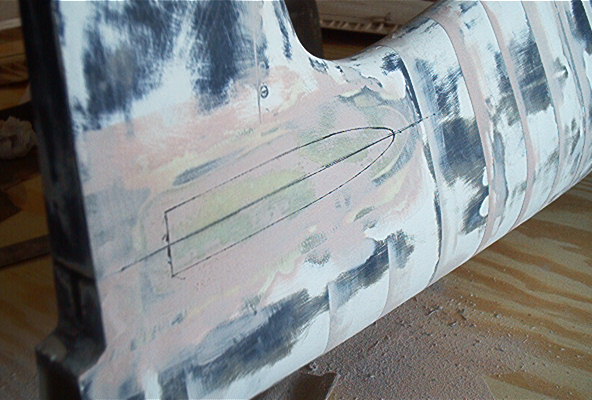

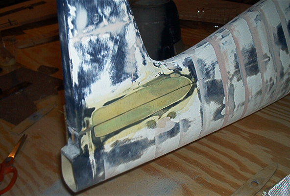

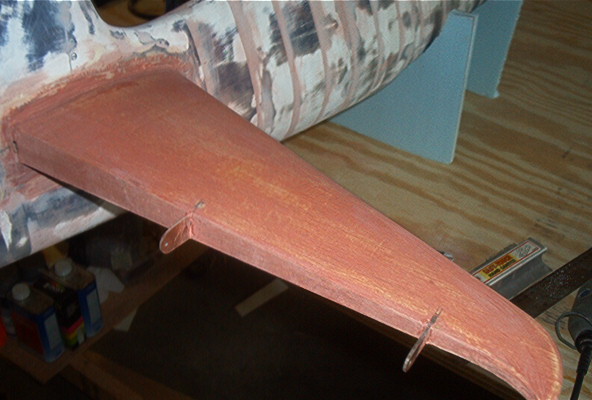

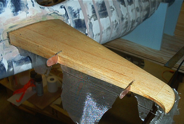

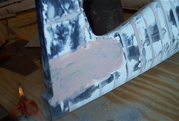

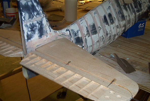

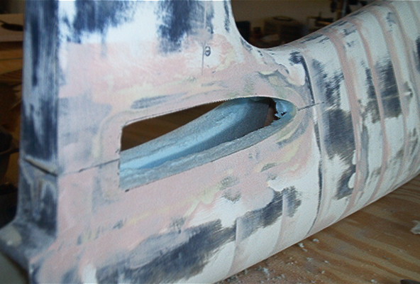

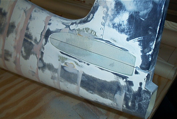

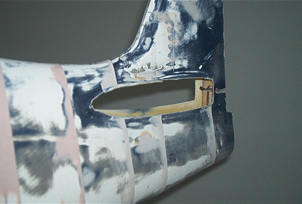

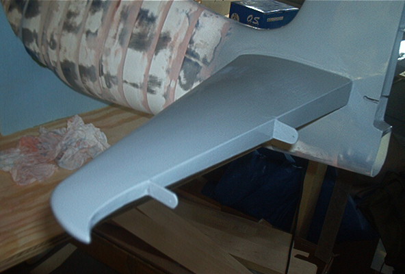

Been working on this thing, several different parts at once, so progress seems slow. I filled the tail with some blue foam and sanded to the fuselage contour.
Next I covered it with some heavy glass cloth.
After that I filled the whole area and sanded it smooth.
After marking the stab incidence and airfoil outline I cut the hole. Hal was a big help with this!
Stab was then glued in, elevators now work!
The last picture is of the rudder and how I carved out the fin. Still have to make the hinges for this, but a big thanks to Hal for the idea. The fuselage is almost done!
Dion

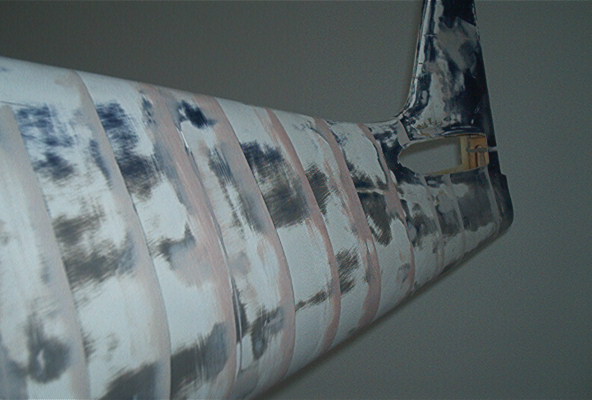

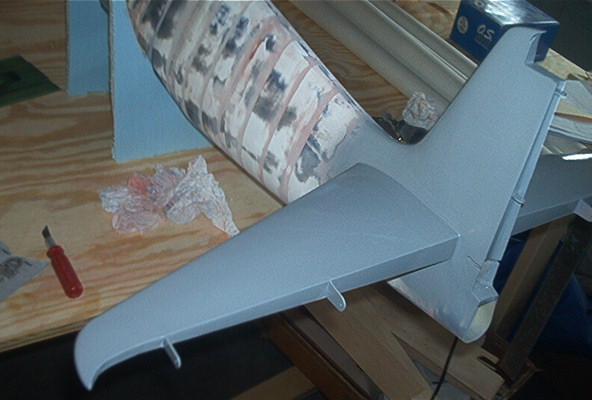

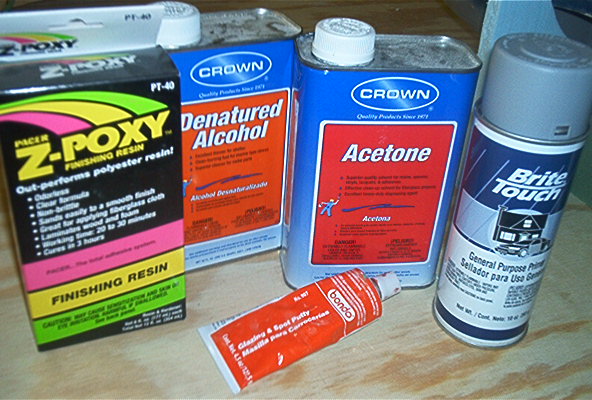

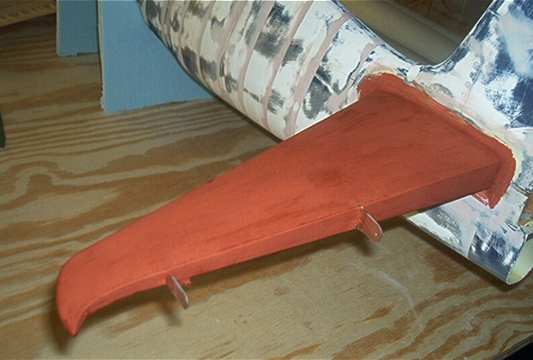

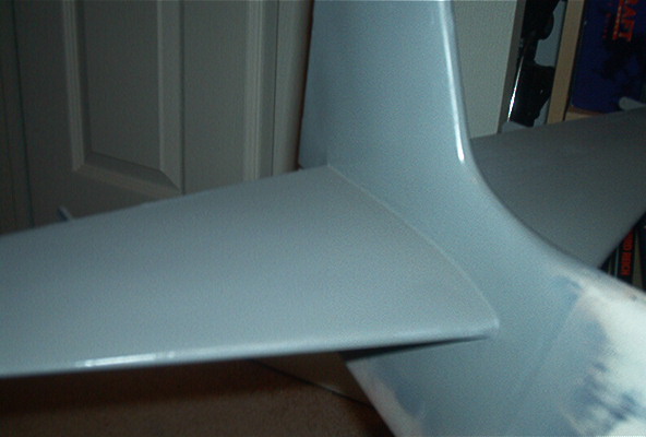

More progress....
This is the lightest, strongest easiest type of glass finish I’ve found. Z-Poxy thinned with Denatured Alcohol. Once you try it you’ll never use anything else, say goodbye to credit card squeegees, toilet tissue trying to soak up excess resin and getting epoxy all over yourself and everything in your shop!
These are my finishing materials: Z-Poxy, Denatured Alcohol, Bondo Spot Putty, Acetone and for primer I use Brite Touch.
First mix your epoxy and thin it with the Alcohol, this is not a scientific percentage, just around 60 percent resin to 40 percent Alcohol will do fine. If the resin starts to thicken just add more alcohol. All you want is enough resin on your plane to bond the glass to the wood, no more! Adding a second coat of resin is ridiculous and will only add weight and work, nothing else. Once the alcohol evaporates, all that is left is a very thin coat of resin, no other sanding or work is needed, your done with the resin! Just trim the cloth and do the other side. This is a very ding resistant surface, once resin is soaked into the balsa, the balsa becomes very hard.
Next we need to fill the weave of the cloth, this is done with some of the easiest stuff to sand in the world, Bondo Spot Putty. Thin this with Acetone to make it just a little thicker than the consistency of milk and just paint it on. It dries super fast and will be ready to sand smooth in no time, just use some 320 grit sandpaper.
Go over any bad spots or nicks you may have missed with un-thinned spot putty and sand smooth.
Give it a good coat of primer and then sand smooth, ready for final detailing and color!
Dion

Question for you experts out there: when finishing a foam core wing, would you simply fiberglass (using the process Luke described above) or would you sheet with balsa first then fiberglass? (one possible answer is "use fliteskin". I looked into it. Fliteskin would be about $200 for the wings I'm building. That's too much). What weight fg for wings?

Thanks and no problem! I use the standard 3/4 ounce glass cloth, it does a great job of holding all the wood together! YES, this technique can and should be used on an all wood plane, I highly recommend it!
The flight skin is pretty expensive, it really doesn't save that much work in my opinion but I like using it to make all kinds of other stuff. Using my method above, glassing a wing is a piece of cake. Sheet the wing with whatever balsa the kit or plans call for, then just glass it with 3/4 ounce glass cloth the way I did my stab.

After lurrking around this thread for several months, you guys have inspired me to get a CMP Hellcat too. After a 25 year career in Naval Aviation, I have a bit of a bias toward Navy warbirds (although I do have a P-47).
My Cat is on its way from GlowRC and should be here later this week. I have also ordered the great looking canopy, cowl, and dummy radial from Luke. Now all I need is a set of retracts, an engine, and free time to build.
By the way, I found this print of a Hellcat with side number 83. I'm not sure this is the model for the CMP paint scheme, but its similar. ( http://www.aviationarthangar.com/f6fhellcat.html )
Thanks to all for the great ideas and tips. Keep 'em coming!
John
