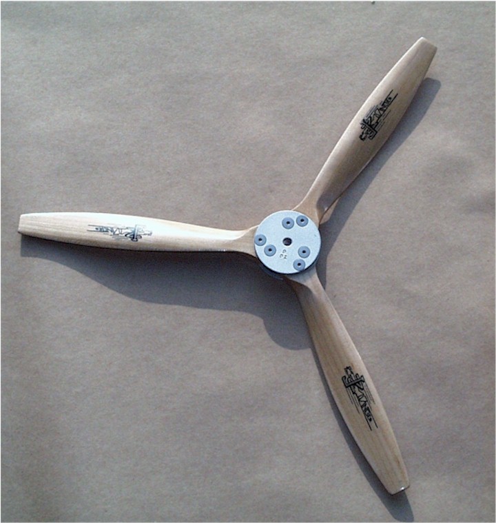

FYI, Zinger has a line of three-blade props that don't cost an arm/leg and which fit right into the engine sizes which this Hellcat uses. The center hub is 2" diameter.
http://www.zingerpropeller.com/index.htm
Jim

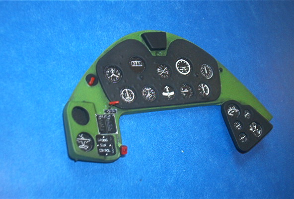

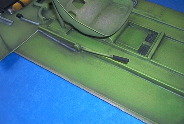

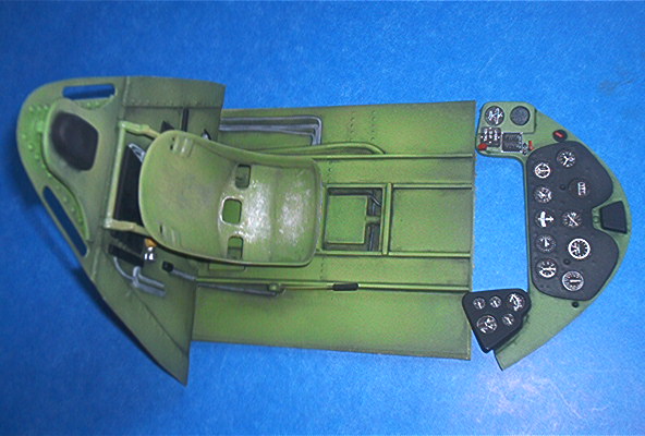

Stopped work on the fuselage for a bit to do some more work on the cockpit kit. First picture shows the parts I have now, I molded the instrument panel separate because it makes it easier to paint and it’s more realistic. I added a hydraulic handle to the floor and some other small details. Next is the finished instrument panel, notice I added the checklist and landing gear up down placard. I’ll show more pictures of the whole thing because the color got messed up on my last ones. The instrument panel looks so good in the plane, every Hellcat needs one! It really stands out because of the almost total lack of overhang on the antiglare shield. Again I’m molding this one out of .015 styrene and it weighs almost nothing, although the seat is molded in .040.
Dion

Mighty nice Luke!!! Have you determined what size pilot( full figured ?) you are going to be using yet since you are doing a full cockpit? What size do you think will fit?
Also, I got my stuff today- thanks again!!
John

Another home run. Looks great! Did you make the instrument decals too? Put em up for sale!!! puhleeze! LOL

For those of you who can get it, The Military Channel is airing a program on the Hellcat. 30 mins of everything you ever wanted to know, old color footage, gun camera, production footage....It's Hellcat Heaven.
Luke, NICE WORK on The COCKPIT! I keep looking for the cockpit "Buy it Now" button on your products page...my click finger is twitching....

nice work on the Hellcat bash Luke.
that cockpit looks great, too bad its too small for
my Ziroli Hellcat .

Thanks John and you're welcome I'm not saying anything about a pilot yet!
Thanks! Yes I make the instruments! ....and... YES, I'll sell them! Happy now?
LOL! I got ya covered C.P.! Won't be long!
my Ziroli Hellcat .
Yea, just a tad small! As everyone knows I'm not a fan of the Ziroli Corsair but if I could look at the plans of the Ziroli Hellcat I might be able to make a cockpit kit for that one, it's not a bad looking plane. Got a lot of other projects I got to do first though!

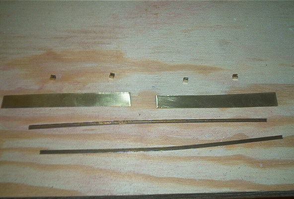

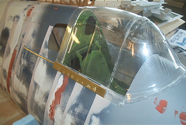

Sliding canopy time, have to get this installed so I can finish priming and sanding the fuselage. I came up with a way that is as close to scale as I could get, it functions very much like the full scale canopy rail system. Full scale used rollers in a track, this could not be duplicated exactly. I used a length of HO scale track rail on each side, it looks very scale. With this system the bottom rail of the canopy will bulge out a bit just as the full scale one did.
Make your brackets from 1/8†bras square stock, cut a slot in a length of it first then cut out 4 pieces about 3/16†in length each. I soldered them to a strip of thin brass sheet, about 1/8†from each end of the brass sheet.
Next mark out the track line on the fuselage and cut a small slot with your dremel and a small disk bit. The track rail will snap into the slot and be somewhat held in by the flange at the top of the rail. The larger bottom flange on the rail is the one you want hanging out of the fuselage.
I drilled some holes in the brass to help with glue adhesion, Cut some strip of 1/32†ply spacers that are the same size as the brass sheet pieces. Glue these to the inside of the brass sheet as shown in the picture.
Next cut 2 slots on the bottom corners of your canopy, the brass sheet rail guides are glued to the outside of the canopy.
I left my canopy intact and slid in on from the front, gluing the front of the canopy to the fuselage. This makes alignment a snap, just use your dremel to cut the frame when the glue dries.
To finish it I’m going to install a strip of Flight Skin to the brass and also I’ll add 2 vacuum formed fairings to the front of the tracks. It also needs a ply frame added to the opening frames to stiffen them.
Dion

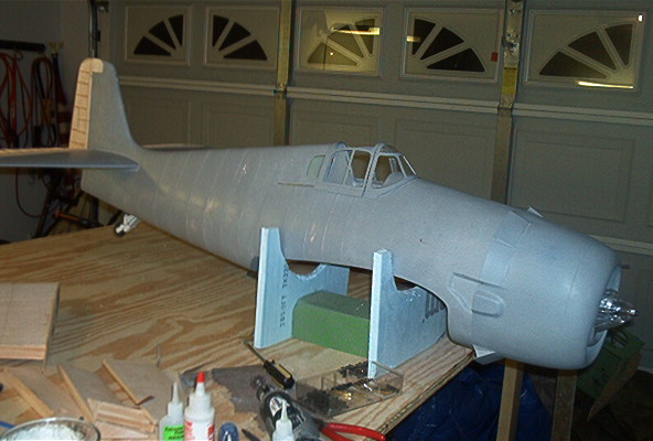

Well to keep this thread alive a little I'll post some pictures so you can all keep up on my build/bash/ARF! I've been doing the plumbing, hooking up the rudder, elevator and installing the tail wheel. The slow stuff that makes it look like you aint done nothin!
Just some general shots of the fuselage, notice the panel lines. I'll finish the radio installation before I add the final panel lines, hatches and rivets. Look at the outline scale jugdes! For an ARF it sure looks good!
I used some PC board to hold the rudder torque rod stable. One area I'd like to comment on is the tail wheel steering, I'm not running any plastic tubing or any cable. Most people over do this area especially on the smaller models, adding to much weight. I just use fishing line and that's it! If it breaks big deal!
The canopy is cut out so that just the frame is left, then I glued in the clear part. This will strengthen it for the sliding operation.
Keep those projects going people! Let's see some pictures![8D]

Thank you all for the praise, believe me though, I'm as exited as you guys are about how this thing looks! I thought I saw a Hellcat under that factory finish! Daren and Tom... lol!
I will make the cockpit available to whatever degree you want to make your cockpit. You can still cut the fuselage and add a few small formers and do a partial cockpit with my canopy and not mess up the original paint.
Lou, I'll get some drawings together for you so you can add the wood mods to your project, no problem.
Received Luke's canopies, and they look superb. I'm impressed. Shame on CMP for supplying the kit with a crappy looking canopy in the first place. .....Just a few minor mods, such as canopy, retractable tailwheel, and probably shorten the wing. I won't go into the extreme since I want to get it up in the air as fast as possible. Afterall, I'm more of a flyer than a builder
Thanks Richard, I'm sure you'll love the way she looks with the new canopy. Those will be easy mods, you can still use the stock finish on all of them no problem. Richard is a great flyer, love those video's! I've moved more to the building side of the hobby in recent years, it used to be about 50 flights or more a week for me back in the day, but not anymore. It's a great hobby and it has something for everyone that loves aviation.
Man, I can't wait to paint this baby![8D]
