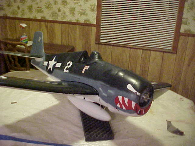

Aero D, Yes used Model Masters Dark Sea Blue on top then Intermediate Blue in the middle with Rustoleum flat white on the bottom. Don't know on the fuel proof part I have always cleared mine after it was all done. Now on the covering I stripped mine all off and glassed it plus did a lot of mods like take 6" out of the middle to make it more scale, like Luke has shown us way back in this thread. This is the second one of these Hellcats I have built so if you are wanting to use the stock covering and it is cloth then it will hold up and it is worth painting. Now if it is a clear plastic film that was then painted it sucks. This was what my first one had for covering but this one came with fabric covering. On clear you can use Top Flite Lustre Kote flat clear with good results which I have done before. I now use Dupont automotive paint that is flat.
Hepdog, no the tank is not dropable on mine. I am sure that it is possible but I have cables that go on yet but are not on the picture which will make it very hard to drop.
Randy

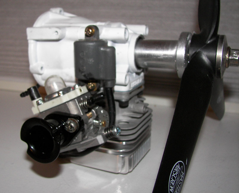

Spring is finally coming back here to IL and I'm kicking the project back into gear. Just finished the modified Zenoah G-23 with a Trevor Simpson 34mm big-bore head kit. It now has 13:1 compression and I think it makes it a G-34...
This poor Hellcat.... (this could be really ugly)

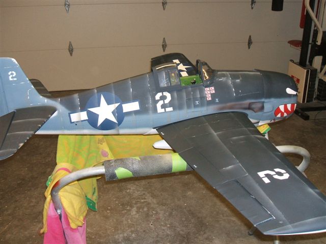

Ok this is where I am at now. Putting it back together. We are just like the Chopper and Hotrod guys we put them together to mock them up then tear them down then put them back together. Oh what fun! Have not finished painting the gear yet but that will be tomorrow. Have all the parts now ready to assemble two tailwheel retracts. My friend Doug is doing a Cat also so I figured soldering up two would not be much more work. He did cut out all the PC board for me so now the easy part of building. Here are some pics it is now weathered and cleared. No more painting except for the gear and doors. Well I hope to have it finished by this next weekend but it might be the following weekend.
Randy

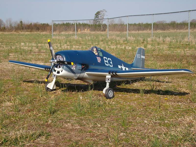

I finally maidened my cat today. She was a good girl with no bad manners. Only a couple of down clicks and she was trimmed out. Unfortunately the wind kicked up from the south and we had a stiff breeze across the runway. Hopefully on sunday afternoon there will be another chance. So far I am very pleased withthe way she flies. Flares in for a greased landing. Good warbird

I like your cat a lot. She looks great. You gonna like the way she flies. Its an easy flying warbird, you'll see. Here are some pictures from today's maiden.
