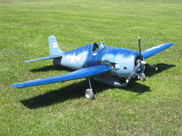

Maiden update-
We finally got the perfect weather on Friday in Chicago for flying. I can't say the detailing was finished because as you can see in the photos I'm missing the sliding canopy and wheel pants purchased from Luke. The hellcat actually made two flights this day. One was completely unintentional during the first full throttle push of the modified Zenoah. This thing has a ton of torque and I had a Wright brothers-like liftoff and landing. We gave it a go and the plane took off easily but was definitely out of trim. I decided not to retract the gear on the first flight and I had an in-flight issue where one wheel axel vibrated loose and I lost a tire. Its safe to say I will lock-tight those things next time. Anyway we took a vote and decided to land gear-down and attempt to slow it down as much as possible. I thought gear-up the drop tank might catch and it would start flipping etc. The landing turned out to be as bad as I thought however I did seem to me$$ up the retracts and I did break the drop tank back in two-pieces (sorry Luke)
It should all be easily fixed an back up next month.

BTW, I can't thank everyone enough for convincing me through posts to strengthen the wing spar area after having cut it to put in the Century retracts. I don't have a good picture but I built-in a non-scale access panel on the top-side of the wing so that I can easilly get at the top of the retracts. Its hard to see but its a defined square on that first pic. This is a great way to check the spar and mounts after a landing like this.

Thanks Luke, And no worries on the drop tank. It broke at the glue seam and should fix up nicely.
BTW, did anyone find a better solution over the stock mechanism to bolt down the wing? I fought the stock nuts which have the teeth to bite the wood (can't remember the name of those for the life of me). I even replaced them with a larger diameter pair with longer teeth from the hardware store and I'm still not happy with the setup.
There has to be a better/easier way-
Jim-
Jim-

They are called "blind nuts". I can't really think of a better way to mount a wing that is one piece. If this warbird had plug in wings that might be easier to figure out. When you have an inclosed fuse there has to be a way to mount the wing that you access outside of the fuse. Maybe an internal attachment point that you acces through a hatch. I can't really think of a better way. If you find one please let us know.
