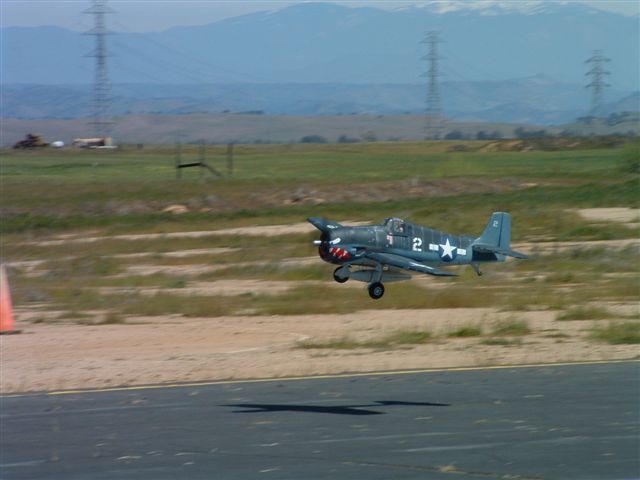

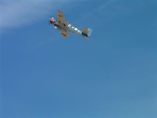

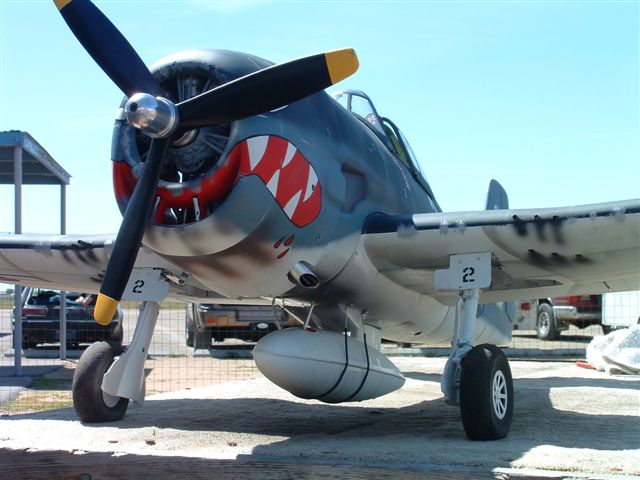

Ok maiden today all went well a few glitches but two good flights. Can say that cutting 6" out of the middle took all the float out of it. With full flaps had to stay on the power and came in kind of hot. Will see how the next flights go and see if I can come in any slower but it starting dropping like a rock when I backed off the power. With the Saito 150 it is very fast and at full throttle it was very stable and clean. Here are some pics from today a friend took.

Randy,
I’m very pleased that all went well, it will take some flights to get used to it for sure. What was your final weight again? You have completely scaled that thing out, so it’s flight characteristics are understandably more demanding. Did you try to slow it down at altitude to get a feel for the stall? Also slowing it down and dragging it in with the prop may be a good technique for this one. The wing is so thick, it seems kind of funny that it would not slow down, even with flaps. Do you think it might have been some nerves helping that along? I’m curious about your further flight tests. If nothing else the darn thing looks really good! I and very impressed with your work, very nice, it looks like a Hellcat.

First off, Randy, absolutely gorgeous hellcat. Glad your maiden went well. I now have several flights on mine and start to get used to her. She is a great flying bird. Very stable in flight. I didn't cut my wing like some of you did. So, mine is still a floater, sort of. But even with the wider wing span she needs some good speed under her wing. Yesterday I flew her through a loop that turned out more like a number 9 when she snapped on me coming off the top. She tumbled several times on her own and gave me a good adrenalin rush for several seconds. A week ago I decided to land her in tall grass after one gear wouldn't lock in the down position. I must have slowed her down too much when, all of a sudden, she dropped like a rock the last couple of feed. Ended up with a slightly crunched front end, which needed some reinforcement behind the firewall anyway. It's all fixed now and nothing to notice. I sure can imagine your Cat needs a good amount of speed with those shorter wings coming in for a landing.
Nice job Randy, looks great! With my piloting skills I'm glad I didn't cut the wings off!

Thanks Luke and Virgian, Not sure on final weight I don't have a scale yet in my inventory something I need to get but I am guessing at about 12# but that is just a guess. It didn't show any tip stall feeling but I am going to check that again at altitude just that when coming in at level flight with full flaps I backed the power off and it dropped like a rock had to add power to keep level flight and just controlled height with throttle. Came in much like the real thing. Not that it wasn't controllable just a lot different than any thing else I have flown. I will get used to it I am sure it is just different. I can say that with the mods it is not something for the intermediate flier. You can not just come in for a normal flair like so much of us are used to. All in all it was all good and had a ball.

Just to let you know I added no extra weight to mine, was all done and went to check CG and it was right on. Saito 150 which by the way is lighter than a 120 and the 180 is even lighter than the 150 they just use the same block and bore it bigger which takes metal away. I have the battery all the way up at the firewall and only servos behind the CG is the rudder and elevator but they are only about 2-3 inches behind. Flap and Aileron servos are basically on CG. I am using a air cylinder for the tail retract but that is also on CG with a Fiberglass rod to actuate. Also used fiberglass rods for rudder and elevator and pull pull on steering. I feel mine is built just about light as possible I would of just had to add lead to CG if I had gone with a lighter motor. Guys don't shy away from the scale look it is more difficult to fly but not terrible, but it isn't for the novice. I flew my stock one for two years with well over 75 flights and felt it landed like a baby. If I had to do over again I wouldn't of done anything different. Thanks for the idea on the mods Luke turned out great and flies nice. Takeoff was normal I just let it runout and get good speed up before liftoff and landings are a little fast but you do have to keep on rudder with the gear being closer together. All in all I am very pleased and I am sure it will only get better I only have two flights so far.
