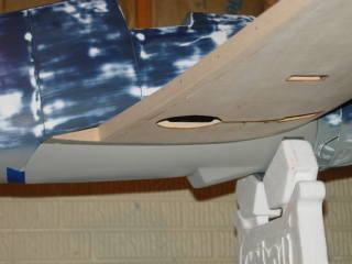

Default RE: CMP Hellcat
I started fitting the bottom wing fairing. The aft edge had to be sanded down to get a good fit. The fairing fits good at the leading edge, but the trailing edge has a quarter inch gap that need to be filled. I'm sure this is due to the fact the wing has been cut down. Final fitting of the fairing will be done after the wing has been glassed.

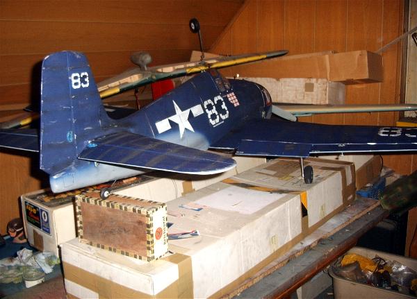

My was flown well with the C.G. which is given by the manual instructions.
