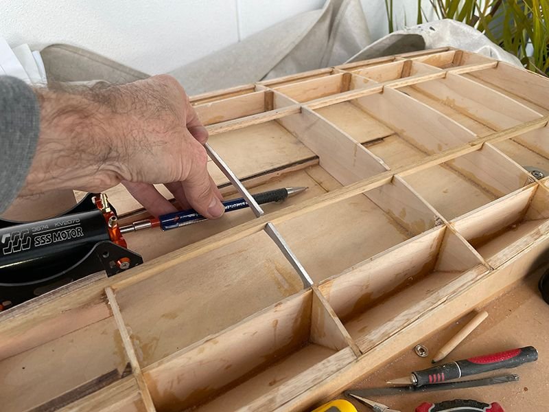

I'm starting to think about mounting the strut/motor etc.
I have the depth of the strut on the plans so I think I know that, and I know that the prop needs to be partly under the transom front to back, but what angle does it need to be on? In the plans it's on a huge angle (see below) but everything I see elsewhere has the strut basically flat with the running surface.
I assume then I mount the motor per the mount (which has some adjustability) and go straight out of the hull from the motor, and bend up to the level of the strut?

This is what I'm thinking about for the motor. Trying to get it as far forward as possible.
This isn't the traditional method for this mount, but since it's got a tunnel this will allow me to mount it out of the tunnel but use the tunnel for the motor to sit down in.
How does the angle for the stuffing tube look?

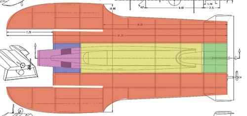

This image shows the different deck pieces per the plan. The red sections are split where I've drawn a white line, as the centre section dips down at the front. The red is all one piece though. The purple section is higher so that makes sense, but the blue and green sections (and the yellow section, though that's the hatch of course) are all on the same plane. The yellow is meant to be fixed, but I think part of it will have to be openable to allow access to the strut.

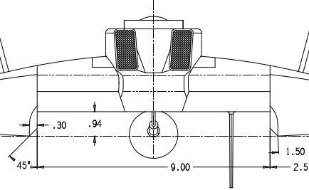

- The boat needs to turn right, am I right in saying I mount the turn fin and the rudder on the right?

#116
That's weird, considering I took it from my build thread. Let me try again:
https://www.rcuniverse.com/forum/att...3&d=1375582323
Let's see if that works.
Now, as for your colored deck layout, let me go over it as this isn't a big issue, regardless of how it looks:
RED, one piece each. Make sure you cut them both oversized since the part that drops down in front between the sponsons will be longer than shown. Same thing for all of the deck edges, they will require more material than shown due to the arcing shape of the deck
BLUE, hard mount it to the hull, just like the red. Make sure to extend this area back to where the purple and yellow meet up and become flush. This is important for sealing the hull with tape when you are running it later, that is unless you install an internal water resistant cover and tape it up instead.
PURPLE, YELLOW AND GREEN, make this all one piece. The purple could be hard mounted to the hull if you want, it's really your choice. As far as the yellow and green, you will want to make that all one piece and permanently attach the cockpit, engine cover and exhaust pipe to it. What you need to remember is that the tighter you make things, the harder it will be to work on later. If you look at the picture of my scale Elam Plus in post 5, you can see the cowl covers everything except the very rear of the boat. Unlike your boat, mine has a metal cover that matches the heat shield on the full sized boat. This was not the case on your boat since there was less decking between the exhaust and the rear of the boat so it wasn't needed.

- The boat needs to turn right, am I right in saying I mount the turn fin and the rudder on the right? Turn fin goes on the rear of the right sponson as far out as you can get it. This is for stability as the closer to the hull you are, the harder it is to get the fin to hold the boat down. As for the rudder, I would almost install it as shown. My preference would be to have it directly behind the engine bay wall as that area, depending on the rudder mount used, is more stable than other locations My Pak hull has the rudder in that location, but for a different reason. I wanted to be able to pull the rudder to turn the boat as it's easier on the control rod. Pushing a rudder to get it to turn can, if the rod isn't very strong, cause the rod to bend or flex while turning, reducing how much control you have https://www.rcuniverse.com/forum/att...4&d=1375582324

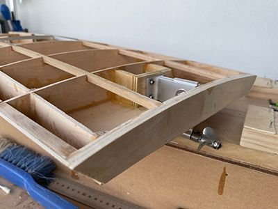

This is the brace I made for the batteries to fit under. The hull is so short top to bottom that I figured aluminium was the only way to get some strength in there without adding too much weight. Batteries can now slide under each wing.

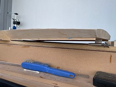

This is the strut mount. Now I just have to figure out what angle and depth to set it at......

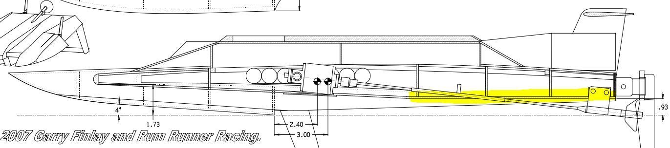

The boat is flat only at the rear, around the prop, and then it ramps up. Am I right in saying that the boat should plane on the same plane as the flat bit? So if I set up the boat level with that rear flat bit, I can then set the centre of the prop to be in line with the bottom of the sponons? What's your thought on the strut angle?
I think I just answered my own question, the plan shows it just as I was explaining. The yellow is the flat bit I was talking about. I'm using a flex shaft so the angle of the strut obviously won't be that extreme.
#122
To begin with, the strut tube should be parallel with the area you highlighted in yellow. The point that the bottom angles up from is, in most cases, referred to as the bottom break. All dimensions are calculated in comparison to the rear bottom, behind the break. Since the diagram shows 23.6mm(yes, I converted it for you), that is where the sponson bottoms should be at the transoms and where the center of the drive shaft should be below the bottom. To get that depth, you will probably need to angle the motor down a bit more than shown so you can get a smooth curve in the stuffing tube. The boat may be too short to use a full "S" curve but that's not a huge issue with this boat
