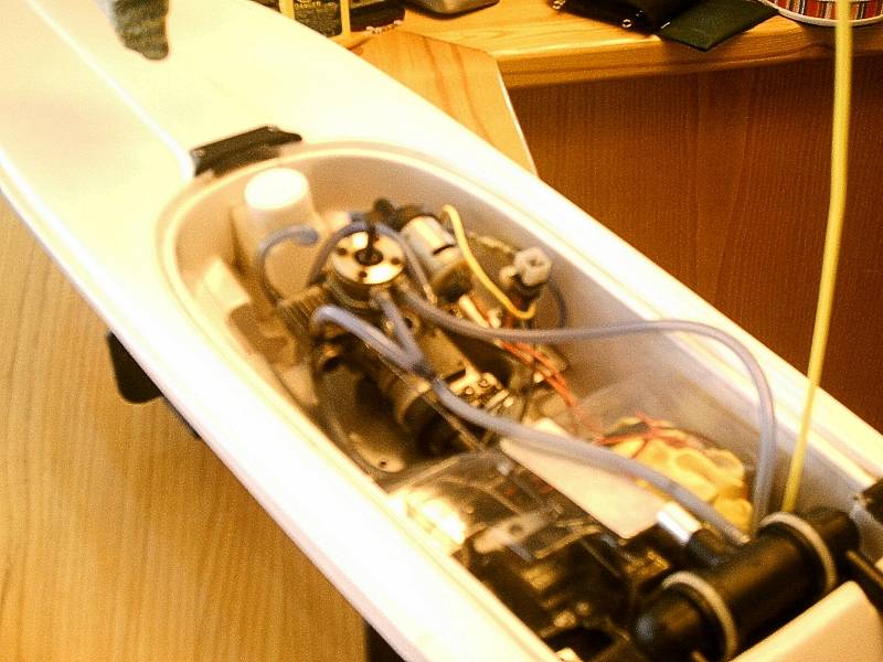

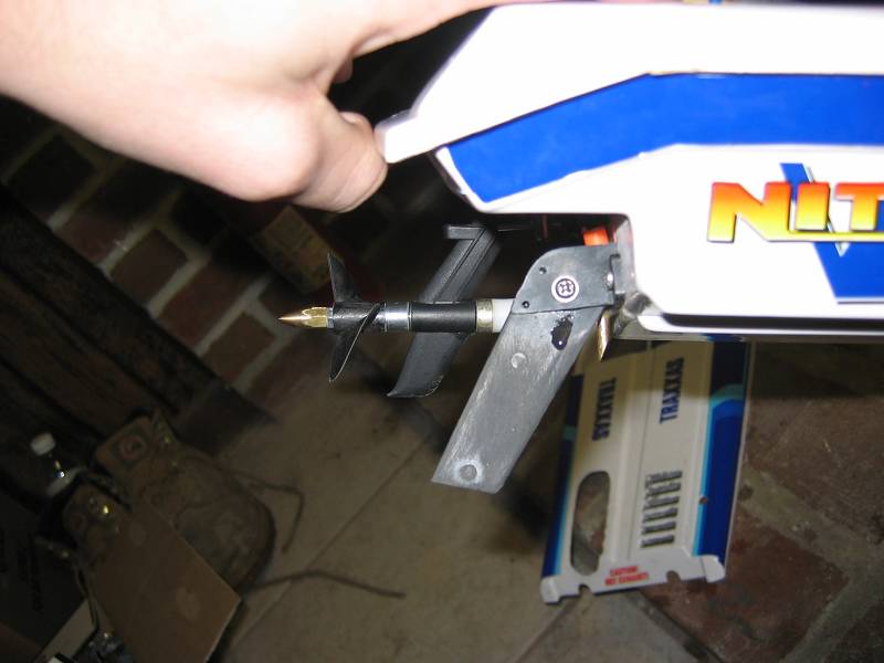

Here they are, no running pics yet, I'll try and get some but i usually run alone, woulda loved to have that flip on video. anyway let me know what you think of it so far(far from done)...thanks...

vertical3-D, nice mods, like the mac pipe look aggressive fast...
btw,where i can buy .25 magnum carb? it's a rotary carb,right?..thanks

yeah rotary, went right in with a sligh adjustment on the throttle linkage, kinda tough to sqeeze them bu the cooling inlet/outlet on the head but it doesn come in and out trust me,I'd check tower hobbies they may have it, also make sure if you can that its the right size, mine is from an older motor, dont know if they would have changed them but i dont think they would, i like them, good carbs, plus i hate traxxas carbs. and the pipe is a definate upgrade and good reason to fix the cooling and make it right, also take note to the placement of my turn fin, note its perpendicular with the hull on that side and lined up with the strake(i dont know hwo it handled stock but this way works pretty good)still can spin if pushed though(outdrives, i love to hate them)...I really hope ppl start getting into the modding of these, the boat recieves a bad rep. because of a few flaws in design that can be fixed easy enough...

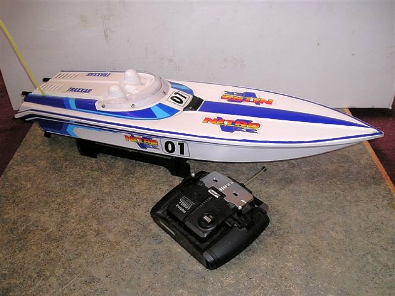

i too have the nitro vee. well not yet. sometime this week. the only one mod i have on it right now is a brass prop. i believe by looking at the pic is a 3 blade one. here is a pic of it. yes it needs repairs but in due time. and yes lets us nitro vee drivers keep this alive. and get more modding ideas.[8D]

BOAT FINALLY SHOWED UP>>>> the before pics are already on here. i will update with more when i can.
so far all decals are off it. i will be buying an airbrush, along with met gold paint and gloss black. custom
made graphics are also being applied after paint. right now as she sits she is white as if she came right out from original box...also i made the mistake by saying she has a 3 blade prop on it. she is 2 blade.

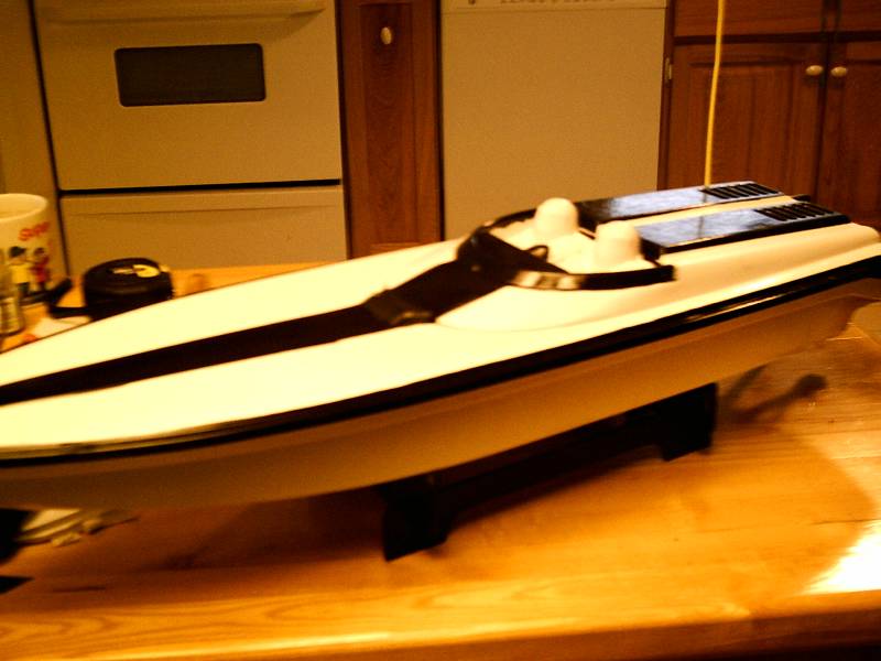

well here she is with just the trim done...

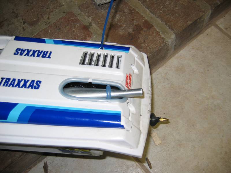

I take it that you took the exhaust coupling off there as it is on in the before pics, you may wanna think about a tuned pipe for it, I really like my macs 2.5cc pipe, it was 28 bucks at tower, takes a little work to mount it, you can see how i did mine in the pics i have one here....glad to see at least someone is talking about these boats....

what did you mean, did you wanna know what else is the first things to upgrade...the pipes are 28 bucks from towerhobbies, and when you switch pipes it gives you a reason to redo the cooling system, which i also heavily suggest doing...

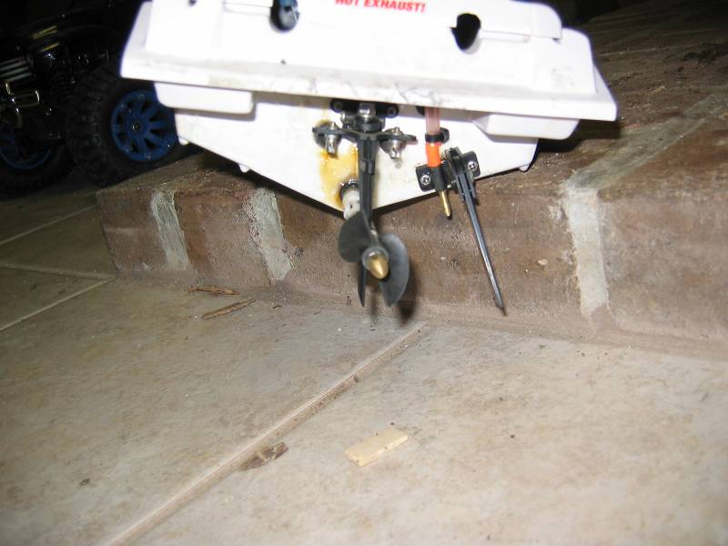

hey now that i know your online. how did you get the existing water intake off and still use the existing bracket? or can i cut just where it goes thick and put in brass tube into that part? also no i have not run it yet, mine is done now with paint. but i still wanna get the cooling tube done. mine i just painted the deck of it , the deck is mettalic red (wich looks more like mettalic burgandy) and the trim of it i painted gloss black. the fins on bottom of boat are also painted gloss black, but the bottom of boat remains white. the figures are not6 done yet but they will be. i repaired the bottom of it where the patch was with 2 part epoxy. sanded to best i could then i painted the marked spots white again.

my cooling piece broke off where it gets thick, right where it is in the pics of my boat, then i simply ran a drill of proper size to match my tube through the thick part...then simply slid the tube in and adden a dab of epoxy on it to hold it in...

a tad bit too late for the responce man i figured i would give it a shot. i cut off both tips on the mount. then used my dremel with the biggest size bit i had for it. worked great too. then i used crazy glue to stick it in place. bonded in a second so i had to be quick squeezing the tube in the hole. but its done now and all back together. so now i sit and wait to find a tank .... then when i do get one i will put engine and elecs back into it. throw 5% nitro in and try it in bathtub, hopefully she starts no problems....as i have no idea when she last started. she did have after run oil in it so it should be ok....

No, I didnt run it with the duals, its more like an airplane muffle than a tuned pipe, these little engines are small and high strung so they can beifit from the pipe a lot....I did see a guy that used a tuned pipe, then from that ran it through an aftermarket pipe for the nitro vee which had dual chrome tips slash cut of(these where on ebay for a little while so maybe there is one on there), But I was more for the performance and the tuned pipe has a nice exhaust tone(if you like screaming nitros)...im sure its alot louder than stock so if noise is a problem then id say dont, no probs with the electronics yet, there is decent room though in the pics it looks like its laying on them, the support at the back of it holds it up, I also have now made a wooden plate that covers the back where the exhaust holes were, looks better now than it did, once i paint it( maybe tonight....i hope) ill get some pics up and you can see it...im not quite sure what you mean about watter on the side?...It gets some in when it runs but the servos sit up off the hull and the reciever is bagged(battery sits above the bootom of the hull too)..look into a rechargable pack, cuz the RTS will eat through AA cells every few outings, worse if its not tuned right...also for the water, i dont worry bout it really jsut empty the stuff thats in the out after every run...I flipped it and it still stayed afloat till it drifted in, though it took a good 5-10 minutes to get it started(i think i got water in the fuel for something, but i got it then and it has been fine since...actually it idled for at least 45 seconds upside down till it starved of fuel...they have foam in the front to prevent total sinking but a fishing pole to retrive it or an electric boat to push it in isnt a bad idea(if its choppy or windy, cuz RTS does nothing when its belly up like a dead fish)...anyway ill get more pics when its painted

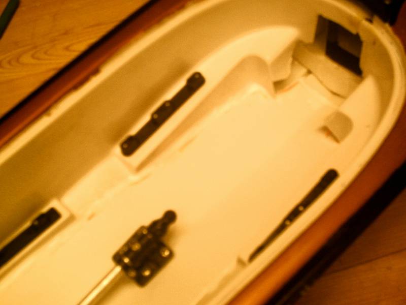

well now i am in a real bind, i found out that nitro fuel got under the whole floor between the bottom of boat and where engine is. so i cut out the bad parts, luckily my mounts are all fine.. ii have some thin plastic squares about 6x6 inch and maybe 1 cm in thickness. so now i am goin to make a new floor for this. gonna make sure that nitro dont get under there again. i used windex to clean the nitro off and wiped it bone dry. also had cracks that i found from where it was damaged. i then coated these cracks with crazy glue as to prevent them from opening if i hit a wave or something., when i get done making a floorpan i'll hopefully have my digi back. so i will post the boat as it is now and then also with new floor plate.as for the pipes at the back i might have a custome made set with chrome on it.duallys at that...
Old 02-07-2006 | 05:59 PM

1 cm thick, holy crap thats thick stuff, id say something around .1 inch would be good, i dunno what that is in mms though,maybe some sheet styrene(almost my entire dumas tug is made from this stuff and its tough)tower has it as well...
Old 02-07-2006 | 07:18 PM
NITRO_VEEDRIVER's Avatar
Joined: Jan 2004
Posts: 760
From: sudburyontario, CANADA
Default RE: The unofficial Home of all that is Nitro Vee...
if its in sheets then i guess thats what i am using. anyways its done now. used weldbond to seal it in place. no nitro goin to get through there now!. also fixed where the tank goes over the plastic insert so now i know i will be safe....goin to take some pics now. post after i am done....
