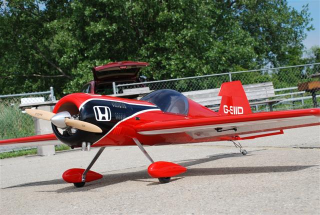

I am thinking of getting this plane . However instead of buying a new engine I was wondering whether you folks think that I could use my Fuji 64EI ? It is definitely heavier than any of the current crop of 50 cc engines. It weighs 3.8 lbs bare engine and 5.1 lbs incl muffler, ignition , prop flange and bolt. tks
#381
Joined: Aug 2004
Posts: 357
From: Woodbridge,
VA
I suspect not; I have been running a 3mm TOC 53 Sukhoi that weighs in at 19 lbs (2 receiverbatteries and a canister set up) and she flies soooo smoothly through stalls that it is a joy to land. I am not much of a 3D type but the airplane handles manuevers at that weight very nicely.

Of course increased wing loading always has an effect an any plane. The Sukhoi is well equipped to handle the load, though, the originals had 1410 sq. in. of area and the next batch will be 1440 due to increase of wing span to 87".

Every one of the planes by any manufacturer on the market is designed to accept a wide array of usable engines. Weights differ substantially between one engine manufacturer and another in engines of the same size and class. Not one of the planes is designed around a specific wing loading and all of them will fly very nicely with a couple of pounds difference between them. The Sukhette is also one that is not limited to a single weight. Too many worry far too much over minor differences in weights when in truth sometimes the plane that weighs a few ounces more flies better than the lighter one. In tumbles the heavier plane performs better.
The difference in wing loading between the Fuji and another engine is not a factor. Your engine will be just fine.

If everyone will please pay attention to the details that this fellow posted, you will see that the numbers are not all that extreme.
He says the bare engine weighs 3.8 lbs. The TOC-53 weighs 3.6 and a DA-50 is 3.1, so the difference is not all that great. It seems that the weight pickup is in the muffler, so I do suggest finding a better exhaust system to save a little weight.
Overall if the total weight is 5.1, this puts the engine RTF about 1 pound above the TOC-53. This is definitely well within the bounds of good sense.
It's hard to find a place to use some of these engines, it will work fine in the Sukhoi and even better if you can find a lighter muffler. In fact it might be quite remarkable, all that power should make performance pretty interesting.
