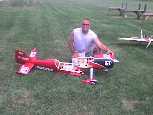

plowed mine in today, perfect 3 point landing dead stick about 30 ft up in a slow climb. only problem with my point landing was that it was on the gear and the nose lol. broke the motor box completely off as well as shoving the gear 2" upward into the fuse and some wing pocket damage. no wing or stab dmg nor any to the fuse behind the front half of the tank plate. having a friend repair it for me at his leisure.

That is really sad to hear, hope you get it up again soon and that you have something new on your build table to keep you going until then,

Buggar?????, hope you can fix it, if not buy another one at least you know how to build it LOL, plus you would have lots of spares.
If you do decide to build something different let us all know will ya.

Sorry to here it Don.... any idea why she went dead stick? DL50 right? A flame out at the wrong spot can put any of us in the repair hanger if there's anything left to repair! Good luck with the rebuild.

well I got the engine cleaned up today and went through the carb .... no blockages or gunk or anything. I was trying to figure out how to test the Ignition for spark, any ideas?. As abruptly as she quit it seems like it lost spark , gonna take a look at my smart-fly optical kill also although the Indicator light was still working when I checked it at the field so I was just assuming that it still worked properly. I kinda think the ignition is the problem .

Don, unscrew the spark plug out of the head and reconnect the spark plug boot, hold it by the boot or the wire, with the ignition on, spin the prop, you should see the spark jump across the plug gap. The plug is grounded to the ignition box by the boot and wire so you dont have to hold the plug against the cylinder to make the ground. You should see the spark jump pretty easy if not, dim the lights. Let us know what you find.

You could put your tongue on the end!!!!!!!!!
Living on the edge??? Just joking. Will be interested to see if it is the ignition!!
