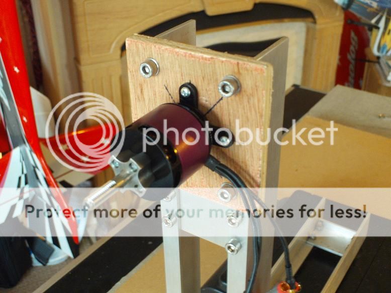

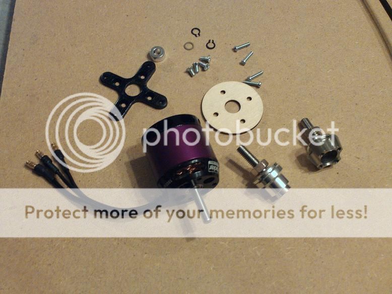

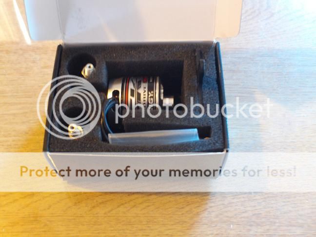

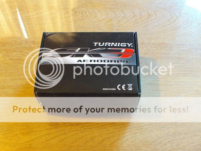

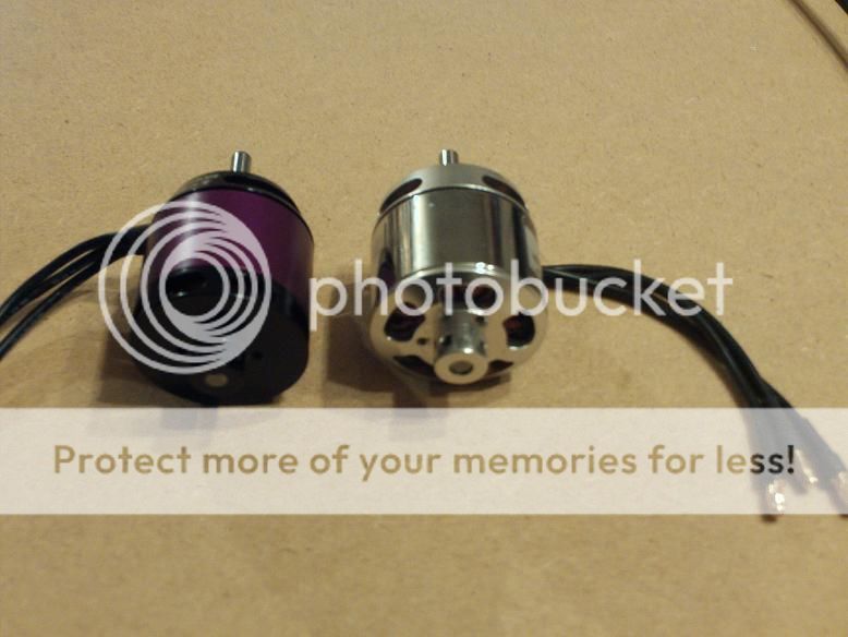

<span style="font-size: small">Here is a systematic and rigorous test of the Hacker motor:</span></p>
<u><span style="font-size: medium">MOTOR TEST:</span></u> <span style="font-size: medium">Hacker A30-12 L, </span>Kv 1000 Supplied by: West London Models Price &pound;66.20 ( =$ 101.53)
<span style="font-size: xx-small">(-price is same all over Europe; in USA is much cheaper $66.99 -only 2/3 of price in Europe)</span></p>
Motor Weight:143g (Hacker data)
Rated Kv: 1000 (Hacker data)
Operating current: 40A; Max current: 50A; Max power: 500W; Internal resistance: 30 milliOhm; (Aeromodel / Hacker data)
External dimensions:diam 37mm, length 42.8mm (Hacker data)<span style="font-size: small">(-some same-size motors are called&ldquo;3742&rdquo; on basis of external dimension)
</span>Stator size:diam 30mm, length 20mm <span style="font-size: small">(-some same-size motors are called&ldquo;3020&rdquo;on basis of stator size)
</span>No. wire turns: 12 (12T); Stator arms: 12; Magnet poles: 14; Length of magnets: 20mm (i.e. same as stator length)
Shaft diam:5mm

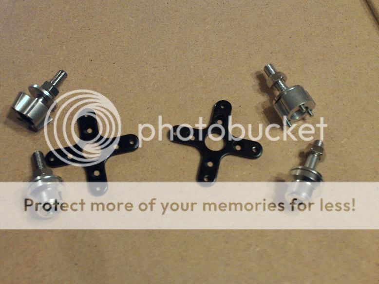

X-Mount (black) weight: 5.1g; Prop adaptor (bolts to hub on rear housing) weight: 17.9g; Prop driver (collet-type which attaches round shaft) weight: 16.0g</p>
MANUFACTURED BY: SUNRAY TECHNOLOGY: http://sunraytechnology.com/
Retailer / Re-seller website:
http://www.hacker-motor-shop.com/e-v...514&amp;p=6514
&amp; https://www.aero-model.com/8_66_879/...-12L%20V2.html</p>

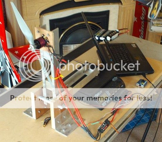

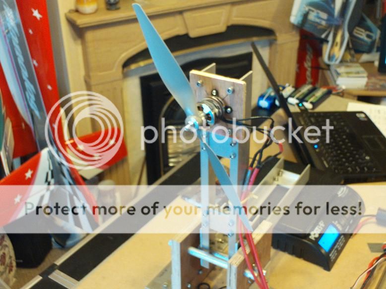

<span style="font-size: xx-small">Measuring equipment used: Eagle Tree V4 data logger with brushless RPM sensor and micro-thermistor temperature sensors (for measuring voltage, current, motor RPM and motor temperature); Additional optical tachometer; Additional infra-red thermometer. ABCON Digital scales for measuring thrust.
I used a GT-Power Watt Meter to check the current readings on the Eagle Tree data logger, especially for low currents &lt;1A. A GT-Power Servo tester device was used to control a ZTW 70A S-BEC speed controller, which was connected to motor.
I used fully charged, 30C to 45C, 2S and 3S LiPo packs as the power source.

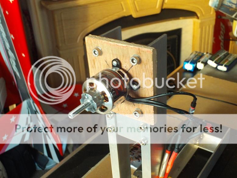

</span>On the Motor Thrust test stand used, the lower horizontal arm pushes on the scales to measure grams of thrust (see photo). The props are therefore mounted on motor so that thrust is generated in a direction away from motor and stand (i.e. with front face of prop facing the motor and test stand).</p>

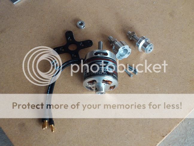

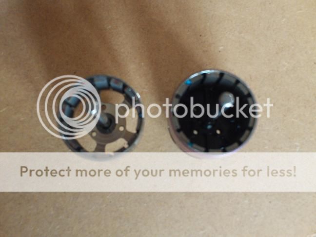

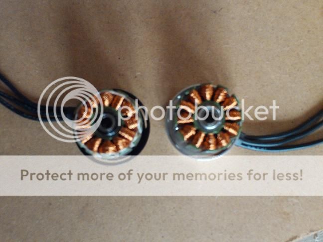

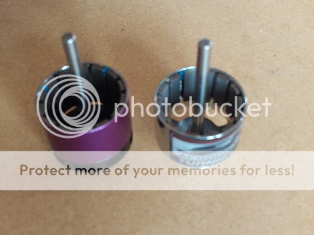

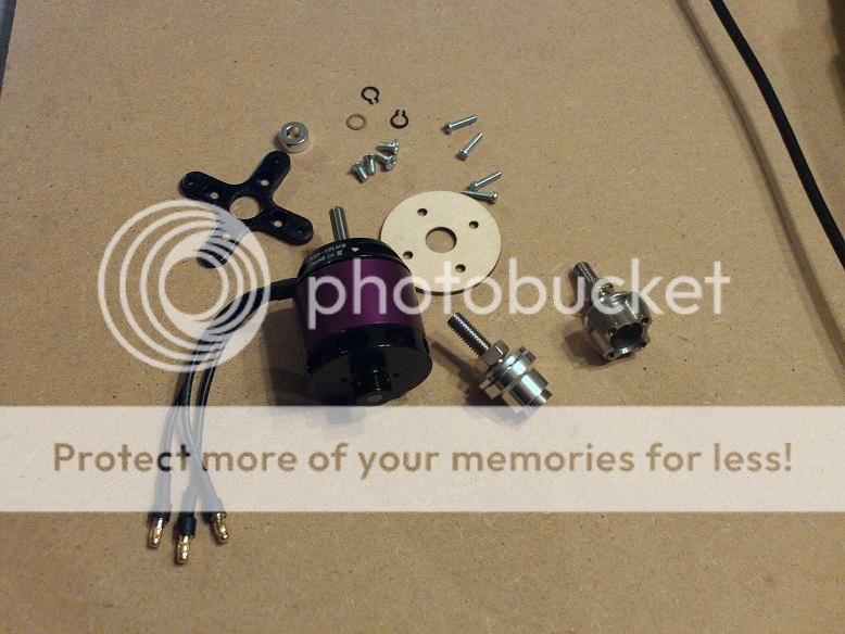

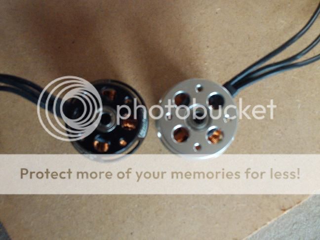

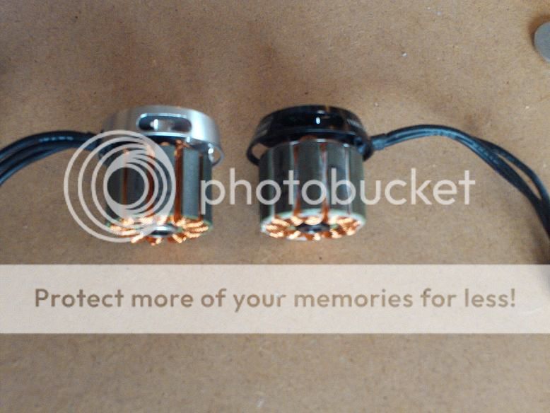

Description of motor:
The Hacker A30-12 L motor, with wires and 3.5mm connectors, weighed 150.3g. The motor has a 12-arm stator (Retailer states: wound with 12 turns, 12T) and 14-magnet poles. Externally, it is 37mm diameter; the main motor body is 39mm long, and with the 11mm diam hub on the rear housing, it is a total of 49mm long (see pics). The supplied hub prop adaptor fixes around this rear hub with 4 small cross-head bolts (also supplied). The actual rotating can (i.e. the purple cylindrical part with magnets fixed to its internal face)is 22mm long, and the black rear motor housing extends backwards from this for 7mm. Motor came fitted with 3.5mm male connectors. The 4 mounting holes on what I will call the "front" motor housing are 3mm thread at 25mm centers (these are for fixing the X-mount). The motor has a 5mm shaft, of which 19mm protruded from the "front housing" and on which the supplied collet-type prop adapter can be fitted.
-One of the "give aways" of being a Sunray Technology-made motor is a brass washer and retaining black horse-shoe circlip on the shaft just outside the front housing -and of course this motor has this feature.</p>
Standard procedure:I mounted this motor using its black aluminium X-mount (which was bolted to the "front" motor housing) onto the 8mm plywood plate of my motor test stand (see photo). I bolted the supplied hub prop adaptor to the rear housing of the motor (this has a threaded 6mm shaft) -see pics.</p>
Standard Motor Test Procedure:
First, I ran no-loads at 11.1V (3S Li-Po) and at 14.8V (4S Li-Po), at full speed, and measured current (I), voltage (V) and RPM (no prop adaptor was attached).

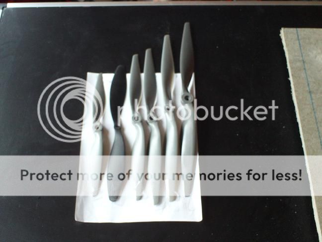

I then ran 6 different props at full speed, in ascending order of size, using both 3S LiPo and 4S LiPo, and measured I, V, RPM and Thrust.
After charging the LiPo's back up again, I then ran the same 6 props, now in descending order of size, to check that the results were reproducible. The second run gave almost identical values. I wanted to get this completely right, with no errors -and so I actually made 4 runs in total; The results of each run were almost identical to each other.

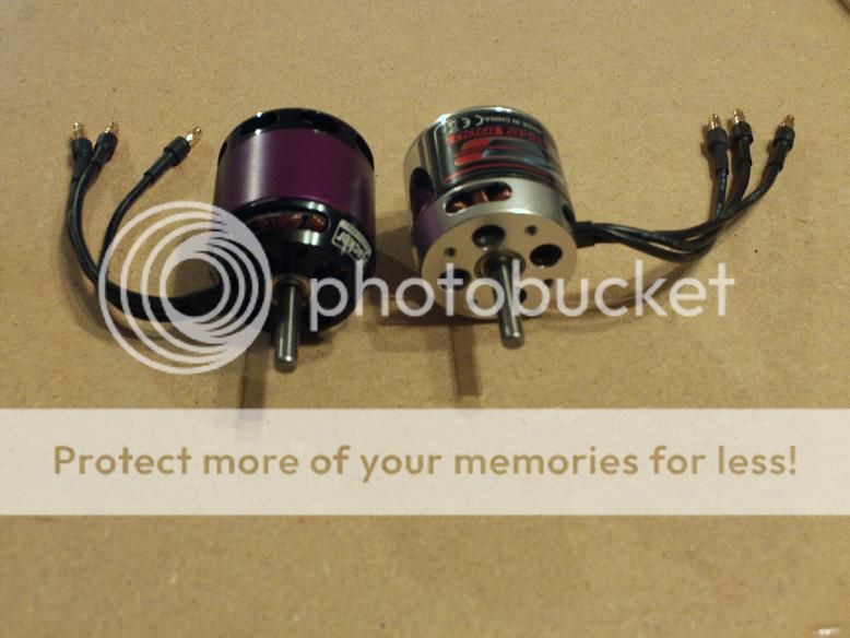

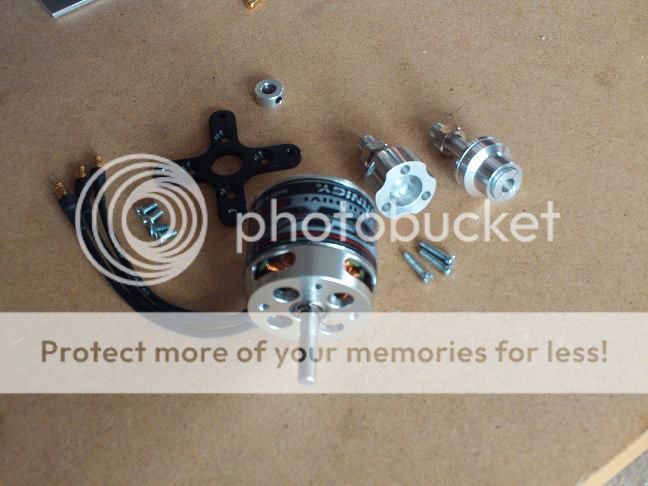

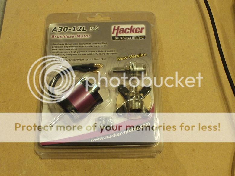

Pics show:1, Motor Thrust Test Stand used; 2, Hacker A30 motor packaging; 3, Hacker A30-12 L motor and accessories; 4, Hacker motor mounted on Test Stand; 5, Rear housing of Hacker A30 motor, showing hub and 4 mounting holes for hub prop adaptor 6, props used for this motor test
</p>

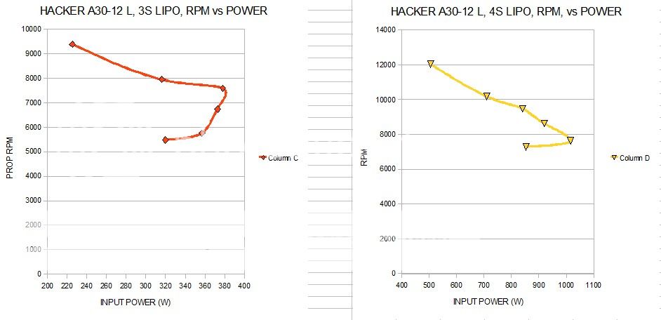

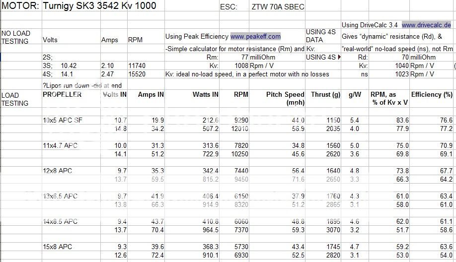

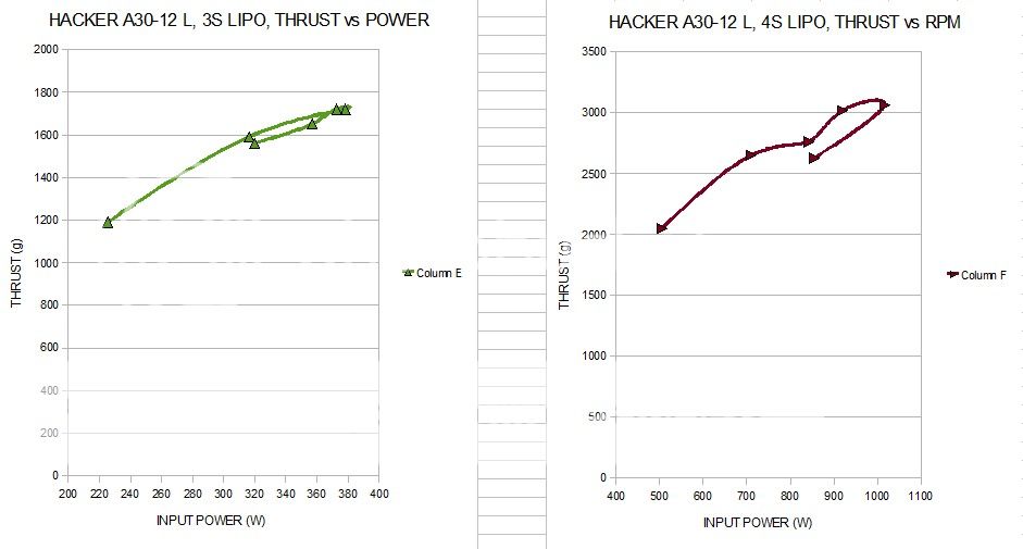

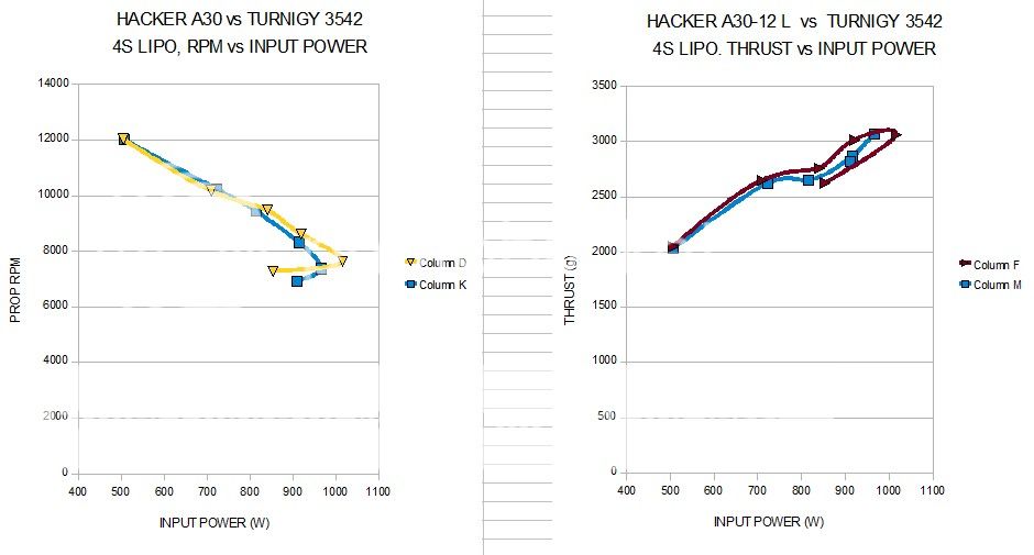

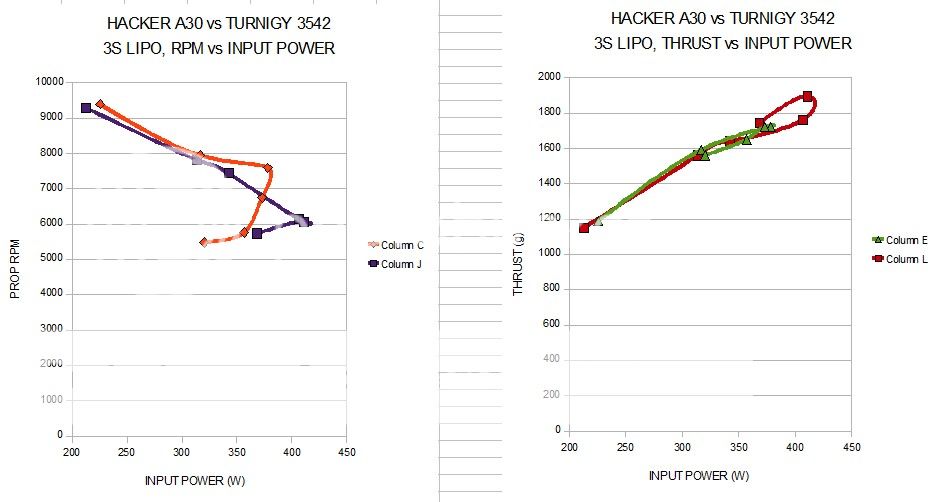

<u><span style="font-size: medium">Results:
</span></u>The motor ran smoothly with all the props tested (even though current and power, in some cases, certainly exceeded the 50A / 500W Retailer max rating).
Results are shown on the attached data sheet.
-For each prop, the lower voltage reading is for 3S LiPo, and the higher one is for 4S LiPo as the voltage source.</p>
Kv: I used two methods for calculating Kv. First, I used www.peakeff.com to calculate Kv and also Rm ("static" motor resistance); I used the 3S LiPo data values for smallest and largest props, to give the largest difference in load).
Second, I used DriveCalc to calculate ns ("real world no load speed") and Rd ("dynamic" motor resistance); DriveCalc also gives a Kv value when data is entered for a new motor (For DriveCalc, I used 3S LiPo test values for 3 different props, at very different loads).
PeakEff gave a Kv of 976; DriveCalc gave a Kv of 977, and ns of 962 -all these values were very close indeed. PeakEff and DriveCalc also gave identical values for Rm and Rd, of 58milliohms.</p>
Current draw: When 3S LiPo was used as the voltage source, none of the props tested exceeded 50A. The 10x5 prop drew a current of 20.9A, and the 14x8.5 prop a current of 37.8A.
With 4S LiPo, almost all the props drew more than 50A (the max current rating)&hellip;! Even the 11x4.7 prop drew a current of 51.5A, and the 14x8.5 prop generated a current as high as 77.6A..</p>

<span style="font-size: medium">PLOTS FOR Hacker A30-12 L:
</span>RPM vs POWER &amp; THRUST vs POWER plots for the Hacker A30-12 L motor</p>
1. The plots are shown below. The points are joined together in the order of increasing diameter for the 6 props tested.</p>
2. 3S LIPO, RPM vs POWER: This shows that RPM fell as prop diameter increased. Input Power increased to the 12x8 prop (the point furthest to the right), and then Input Power fell slightly with the three larger props as RPM continued to fall.</p>
3. 4S LIPO, RPM vs POWER: RPM fell (and Input Power increased) as prop diameter increased. For the largest prop (15x8) Input Power fell slightly as RPM continued to fall.</p>
4. 3S LIPO, THRUST vs POWER: Both Thrust and Input Power increased up to the 13x6.5 prop(the point furthest to the right). With the 2 larger props, both RPM and Power fell from the peak with the 13x6.5 prop.</p>
5. 4S LIPO, THRUST vs POWER: Thrust and Input Power increased as prop diameter became greater, up to a peak with the 14x8.5 prop (the point furthest to the right). With the larger 15x8 prop, both Thrustand Input Power fell from this peak.</p>
These plots of motor performance are effectively a &ldquo;fingerprint&rdquo; for the Hacker A30-12 L motor.
</p>

<span style="font-size: medium">MOTOR TEST: Turnigy SK3 3542-1000Kv:
</span>Motor Weight:141g (HK data)
Rated Kv: 1000 (HK data)
Max current: 45A; Max power: 670W; Internal resistance: 31milliOhm;(HK data)
External dimensions:diam 37mm, length 44mm(HK data -despite D37, L44, HK still call it a "3542" motor) (-some retailerscall ita&ldquo;3742&rdquo; motor)
Stator size:diam 30mm, length 20mm (-some same-size motors arecalled a &ldquo;3020&rdquo; motor on basis of stator size)
Shaft diam:5mm
X-Mount (black) weight: 5.1g; Hub Prop adaptor (bolts to hub on rear housing) weight: 10.2.g; Prop driver (collet-type which attaches round shaft) weight: 11.3g</p>
Retailer / Re-seller website: HobbyKing:
http://www.hobbyking.com/hobbyking/s...ner_Motor.html</p>
Measuring equipment used: -Exactly same as for Hacker A30; No need to repeat.</p>
The Turnigy SK3 3542-1000Kv motor, with wires and 3.5mm connectors, weighed 141.1g. The motor has a 12-arm stator (Retailer states: wound with 12 turns, 12T) and 14-magnet poles. Externally, it is 37mm diameter; the main motor body is 36mm long, and with the 11mm diam hub on the rear housing, it is a total of 43mm long (see pics).Thesupplied hub prop adaptor fixes around the hub with 3 small cross-head bolts (also supplied). The actual rotating can (i.e. the chrome cylindrical part which hasmagnets fixed to its internal surface) is 22mm long-exactly the same length as for the Hacker purple rotating can.The rear motor housimng extends back for 3.5mm from the can(see pics). Motor came fitted with 3.5mm male connectors. The 4 mounting holes on what I will call the "front" motor housing are 3mm thread at 25mm centers (these are for fixing the X-mount). The motor has a 5mm shaft, of which 21mm protruded from the "front&rdquo; housing and on which the supplied collet-type prop adapter can be fitted.
-One of the "give aways" of being a motor manufactured at the Sunray Technology factory -is a brass washer and retaining black horse-shoe circlipon the shaft just outside the front housing -and of course this Turnigy SK3 motor has this feature.</p>
Standard procedure: Same as for the Hacker motor; No need to repeat.</p>
-Exactly same as for Hacker; No need to repeat.
I wanted to get this motor test completely correct, with no possibility for error. So I actually made 4 runs in this motor as well, so that I could be totally confident of the results. All 4 runs gave readings which were almost identical. Therefore, I am very confident of these results.
Pics show: 1,2, Turnigy SK3 3542 box and packaging; 3,4, Turnigy SK3 3542-1000Kv motor with supplied accessories;5,6, Turnigy SK3motor mounted on the Test Stand.
</p>

<span style="font-size: medium">Results: for Turnigy SK3 3542-1000Kv
</span>The Turnigy SK3 3542-1000Kv motor ran smoothly with all the props tested (even though current and power, in some cases, certainly exceeded the 45A / 670W max rating given by the retailer, HK).
Kv: As before, I used both www.peakeff.com and DriveCalc to calculate Kv, Rm ("static" motor resistance) and Rd ("dynamic" motor resistance).
-PeakEff gave a Kv of 1008; DriveCalc gave a Kv of 1040, and an ns of 1023 -all these values were very close indeed. PeakEff and DriveCalc gave values for Rm and Rd, of 77 and 70 milliohms respectively. These were also close.</p>
I am not going to describe the results of testing the Turnigy SK3 3542-1000K in any detail. There is just no point, because this Turnigy SK3 motor gave ALMOST IDENTICAL RESULTS to the Hacker A30-12 L motor. And I have already described the results for the Hacker motor (in posts #7, 8 &amp; 9 of this thread).
Therefore, I am just going to focus on the great similarities, and also a few minor differences between these two motors:</p>
MOTOR PERFORMANCE ON THE TEST STAND:
a. If we compare the datasheets for the Turnigy SK3 3542-1000Kv and the Hacker A30-12 L motor, we can easily pick out some values for comparison:</p>
Current A) RPMThrust (g)
For the 10x5 prop with 3S LiPo:
Turnigy SK3: 19.9 9290 1150
Hacker: 20.9 9390 1190</p>
For the 11x4.7 prop with 4S LiPo:
Turnigy SK3: 51.2 10250 2620
Hacker: 51.5 10180 2650</p>
For the 12x8 prop with 4S LiPo:
Turnigy SK3: 59.5 9450 2650
Hacker: 61.4 9480 2760</p>
<span style="font-size: small"> -Very obviously, there is no need for us to go on; It is very clear that within the limits of experimental error, </span><span style="font-size: small">the performance of these two motors is is COMPLETELY IDENTICAL.
</span>
<span style="font-size: medium"> -For each prop tested, the current, input power, RPM and Thrust readings were almost identical for the two motors.
</span><span style="font-size: x-small">
</span></p>

Default RE: Hacker A30-12L vs Turnigy SK3 3542-1000Kv -Head to Head PERFORMANCE TEST
<span style="font-size: medium">PLOTS COMPARING performance of Turnigy SK3 3542-1000Kv&amp; Hacker A30-12 L motors</span></p>
The fact that the the Turnigy SK3 and the Hacker A30 are, in reality, identical motors underneath their outer case, is confirmed completely by the graphs shown below.</p>
a. 3S LiPo plots: In the first 2 plots below, I have compared the two motors for 3S LiPo, and have plotted RPM vs Power,and Thrust vs Power. In the left plot, orange symbols are for Hacker A30, blue for Turnigy SK3. In the right plot, green symbols are for Hacker, red for Turnigy.
-You can see that the graphs for the Turnigy SK3 3542-1000Kv and the Hacker A30-12 L almost superimpose on each other.</p>
b. 4S LiPo plots: In the second 2 plots, I have compared the two motors for 4S LiPo, and have again plotted RPM vs Power,and Thrust vs Power. In the left plot, yellow symbols are for Hacker A30, blue for Turnigy SK3. In the right plot, red symbols are for Hacker, blue for Turnigy.
-Once again, you can see that the graphs for the Turnigy SK3 3542-1000Kv and the Hacker A30-12 L almost overlay on each other.</p>
<span style="font-size: medium">The Turnigy SK3 3542-1000Kv has <u>EXACTLY</u> the same performance as the Hacker A30-12 L motor.
</span> <span style="font-size: medium">Therefore, underneath the outer chrome or purple case, the Turnigy SK3 3542-1000Kv is <u>EXACTLY THE SAME MOTOR</u> as the Hacker A30-12 L motor.
</span>

<span style="font-size: medium">PHOTOS COMPARING <u>OUTSIDE</u> OF THESE TWO MOTORS,ANDACCESSORIES:</span>
Here are some photos comparing the Turnigy SK3 3542-1000Kv and Hacker A30-12 L motors side by side.
a. The SK3 and Hacker motors have slightly different front housings.
b. The SK3 and Hacker motors have different rear housings. The Hacker rear housing extends further back than the SK3 one. However, they both have the same 11mm diam hub on the rear housing. It should be noted that the style of front and rear housings is just cosmetic, and does not affect the performance of the motor.
c. The SK3 and Hacker motors have almost <span style="font-size: small">IDENTICAL</span> accessories. <span style="font-size: small">The black X-mount is the same identical part,for both motors.
</span> -The only minor difference in accessories is that the Hacker hub prop adaptor attaches to the rear housing with 4 small cross-headed bolts, whilst the SK3 attaches with 3 cross headed bolts. Also the SK3 prop adaptors are 7g lighter than the Hacker prop adaptors (compare the weights I have measured, for both motors).</p>
d. <span style="font-size: small">Oh, I almost forgot: </span>The Hacker has a purple rotating can with black end housings; The Turnigy SK3 has a chrome rotating can with silver end housings; -But then details like this arejust cosmetics, and nothing more &hellip;
Pics show: 1, Front housing of motors; 2, Rear housing of motors; 3, Two motors compared from side view; 4, Accessories supplied; Hacker ones on left, Turnigy SK3 on right. The black X-mount supplied for each motor, is clearly the same IDENTICAL part, and must come from the same factory ...

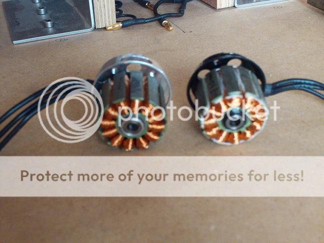

<span style="font-size: medium">PHOTOS COMPARING THE <u>INSIDE</u> OF THESE TWO MOTORS</span></p>
Here are photosshowing the inside of the Turnigy SK3 3542-1000Kv and Hacker A30-12 L motors, after the front circlip is removed, and the rotating can is removed from the stator. -This now explains why their performance is identical,because <span style="font-size: medium">INSIDE (as you can see) -THESE TWO MOTORS ARE COMPLETELY IDENTICAL ...</span></p>
a. They both have an identical 3020 stator -i.e. a stator which is 30mm diam, 20mm long. Both stators have 12 &ldquo;arms&rdquo; or &ldquo;slots&rdquo;.
b. The stator is wound identically for both, and with the same copper wire.
c. They have identical bearings.
d. They have a basicallyidentical 5mm shaft. (-The Hacker shaft is very slightly longer (67mm) than the Turnigy SK3 shaft (63mm) because the Hacker motor itself is slightly longer -due to the deeper rear housing. However, the length by which the shaft protrudes from the front of the rotating can (31mm ) is exactly the same in both motors. And the distanceofthe circlip goove from the front of the shaft is alsoidentical between these motors).
e. They have an identical diameter can, both made with exactly the same thickness aluminium
f. They both have 14 magnet &ldquo;poles&rdquo;, and the 20mm long magnets are identical in both motors.
g. AndBOTH of them motors have CURVED MAGNETS -i.e. magnets which are curved on their interior surface, which is the surface facing the stator (&ldquo;Curved magnets&rdquo; have always been a &ldquo;headline marketing feature&rdquo; of Hacker motors ...).
h. AndBOTH of the motors havedynamically balanced rotating cans -we can see this easily in pic 5, which shows the blue plastic deposits that are added during the can balancing procedure in the factory.</p>
<span style="font-size: medium">CONCLUSION: </span><span style="font-size: small">Once these two motors are taken apart, and we can see the inside (the &ldquo;guts&rdquo; of the motor&hellip; ), it becomes extremely obvious that the <span style="font-size: medium">Turnigy SK3 and the Hacker A30 are TOTALLY IDENTICAL AND EXACTLY THE SAME MOTOR.
</span>
Of course, this is precisely why the two motors produced exactly the same performance on the Test Stand ...
</span>
It is worth making the point here, that of course -<span style="font-size: medium">we would never guess </span><span style="font-size: small">from the outside appearance of these two motors, that they are EXACTLY the same inside and that they have exactly the same performance </span>(-and especially because the Turnigy costs $27, whilst the Hacker is $101&hellip; )
<span style="font-size: small"> -And of course this is <u>precisely</u> why allthe 20 or 25 or 30 different &ldquo;SunRay Tech motor brands&rdquo; all have a slightly different outside appearance. It is to try and prevent us realising that these motors are, in reality, all exactly the same on the inside.
-Clearly, the SunRay factory and also the re-sellers of these SunRay motors (-like Hacker, Extreme Flight, Common-Sense-RC, BMI-Models,etc etc) do not wish us to realise that Hyperion-Z,Gens Ace, Turnigy SK3, LiPolice, OK Hobby Infinite, Pelikan Foxy,Common-Sense-RC,BMISpitz, motors -are all, in fact,totally identical to Hacker motors, and to Extreme Flight Torque motors... (-on the inside ...)
</span>
<span style="font-size: large">But the fact is, they all are &hellip;.
</span>
Pics show: 1, 2, 3, Stator and windings of the 2 motors;Turnigy SK3 on left, Hacker on right; 4, Inside of rotatingcan; Turnigy SK3 on left, Hacker on right;Both motors have magnets which are curved on theinner surface; 5, Rotating can of both motors, to show that they are bothdynamically balanced (note blue plastic deposits between the magnets; Obviously, the Hacker is the purple one ..The actual can part is the same forboth Hacker and Turnigy SK3 -it is just that the Hacker has a wider rear end housing than the SK3.
6,Closeup view of the front housing of both motors
</p>

8. <span style="font-size: small">The Turnigy SK3 3542-1000Kv and the Hacker A30-12 L are the EXACT SAME IDENTICAL MOTOR, in all important respects.</span></p>
<span style="font-size: medium">-However, the Turnigy SK3 is only 27% of the cost of the Hacker A30 motor

<span style="font-size: medium">Who would have imagined that:</span></p>
<span style="font-size: large">A brushless motor costing $101</span></p>
<span style="font-size: medium">is </span><span style="font-size: medium">EXACTLY THE SAME IDENTICAL MOTOR</span></p>
<span style="font-size: medium"> </span><span style="font-size: large">-as another same-size motor costing $27 ... ????</span></p>
<span style="font-size: medium">But that is the situation we very clearly have ....</span></p>
<span style="font-size: large">Make no mistake: As far as brushless motors are concerned, We are most certainly <u>NOT</u> </span><span style="font-size: large">" ... getting what we are pay for ..."</span></p>
<span style="font-size: small">We might normally think: That the quality of an item might increase as the prices increases
-NOT IN THIS CASE ....</span></p>
<span style="font-size: small">We might normally imagine that the more one pays for an item, the better the merchandise
-NOT IN THIS CASE .... </span></p>

<span style="font-size: small">At the moment, post #10 is missing. And so are posts #14, #15&amp; #16.
</span>
This is not good at all;
-Post #10 shows several photos of theTurnigy 3542-1000Kv motor;
-And post #14 shows severalphotos of the INSIDE of both the Hacker and Turnigy motors, showing that their stators andmagnets, bearings and shafts etc are completely identical.
-This explains totally, why these two motorshave the very sameperformance figures on the Test Stand, because they are actually completely identical motors, underneath the outer case .....
I am not sure at all, why these 4 posts are missing from this thread, at the moment.

<span style="font-size: small">CORRECTION:
</span> -I have corrected post #10
-By mistake, I gave the length of the Turnigy 3542-1000Kv as 48mm, and the stator as 3025 (have NO idea why I did this .. ).
Of course,this motor is 42mm long(-that is why it is called a "3542" motor ... )and it has a 3020 stator -just likethe Hacker A30-12L &amp;HYPERION Z3019-12T
-And also just like these 12T, ~150gmotors:
LiPolice LP-3020/12T-970KV
OK Hobby Infinite A3020-970, 12T
Foxy C3020/12 970Kv
Pilotage Nova Line DT3019/12 970 Kv
Lipotech GTA 20-12 900 Kv, 12T
WAYPOINT-E3020-12 972Kv
O.S. OMA-3820 Kv960
-In all probability,these are all totallyIDENTICAL motors to the: Turnigy 3542-1000Kv, Hacker A30-12L &amp; HYPERION Z3019-12T
<span style="font-size: small">( -they are,of course, ALL manufactured side-by-side inthe SunRay Tech factory ... )</span>
