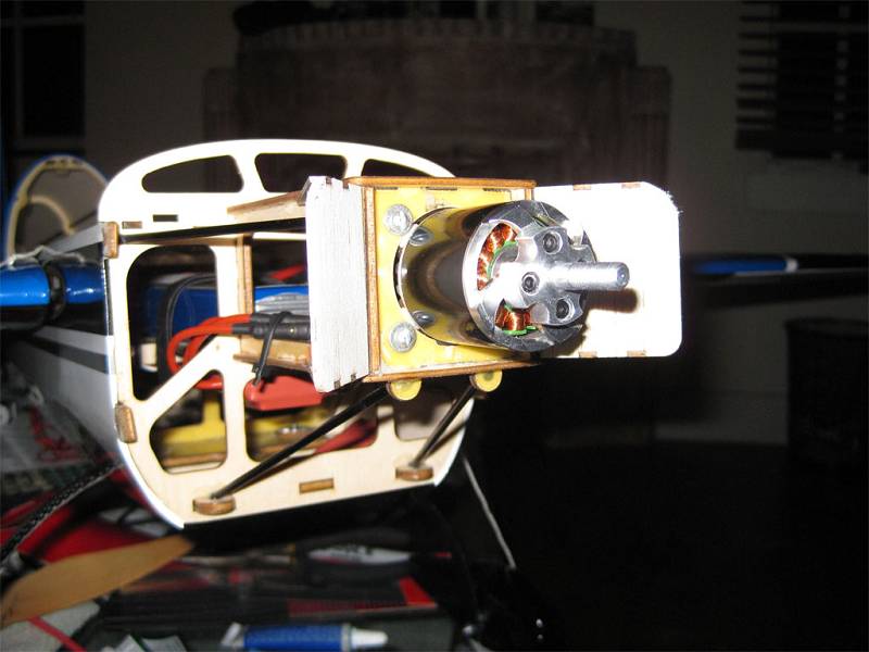

Done! But not maidened, yet. I started yesterday around 1pm and was finished around 7pm with interruptions. However, when I say done then I mean: adjusted the servo throws, setup dual rates, made sure the CG is okay (and even put the stickers on :-) ). Above you can see photos of the box and the finished product. I was gonna work on it over a few days and I was going to put up pictures of the progress, but since I decided to work on the plane instead of going flying, I finished it in one go.
All the electronics are as per Extreme Flight recommendations: Hitec 65MG, Airboss 45 amp ESC, Torque motor (the one with the 820 or so KV) and Thunderpower 2100mAh 4 cell battery (I got 2 of them and I got 2 EON Flightpower 2450mAh or so, those are going to be for windy days). I'll buy Zippies if I need more batteries.
It came together really well. This is my first electric where the motor was simple bolt on. The firewall has blindnuts installed. No drilling, no nothing necessary. Just put in the screws and you're done. The control linkage is also simple, except I had to scuff the carbon fiber rods a lot to be able to fit them in the ball linkages.
I'll put in another post after the maiden.

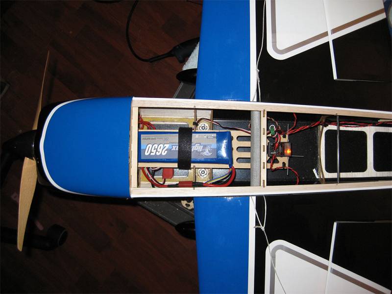

I finished mine. Since I usually only fly gas and only have the Little Bangee electric, some questions. I didn't go for the combo setup and in stead I got myself 3 2650mah Zippy batteries, Turnigy 40A controller and Turnigy SK 35-42 1000kV motor.
With the battery all the way up front, I got the CG 1/8" behind the center of the wing tube. Is this gonna work out fine or will it be tail heavy? I like my planes to be close to being tail heavy. With the big battery the plane weighs in at 47-1/2oz.
Also, I ran a few batteries with a Xoar 12x7E prop. Everything seems to work fine but the motor gets really hot and smells after 30 secs+ full throttle. Is this normal? I guess the motor is about 60 degrees Celsius after the full throttle run. The battery is warm and the controller slightly hot. I tried low, medium and high timing mode and I get the impression I get much longer run times in high timing mode. Can someone please confirm?
And I haven't used any of the included EZ connectors. These create a big load on the arms. See image 3 for how far the arms are out of line.

Okay. My motor has 820kv, which means it spins slower than your 1000kv motor. I'm using a 12x6 prop, you're using a 12x7 prop. That means you're definitely over propped! My motor and ESC have ambient temperature after a flight like the one in the video above, and the performance is very satisfying. I'd definitely try a 12x6 if I were you.
As far as CG: My CG is also aft. I have to move the battery all the way in the front to get the CG right (neutral). To do 3D stuff, I move the battery an inch from the front for slightly aft CG.
