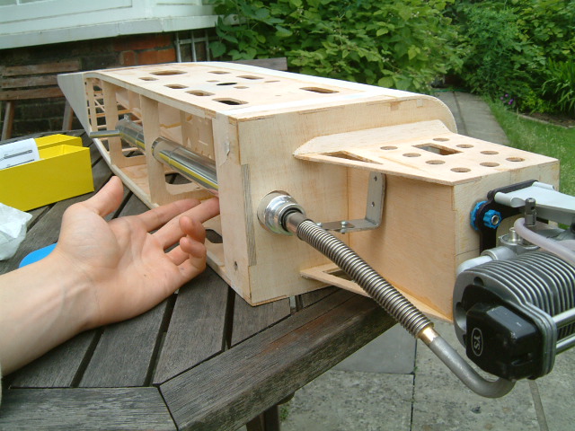

MAJOR PRob... anyone ever fitted a remote glo to a YS 4stroke !? Cant get mine to stay attached - well is too deep...and cowl too big for my glo sick to reach..

#892
Joined: Apr 2003
Posts: 4,643
From: chatsworth,
CA
yes, i had that problem. get one of the sullivan headlock ones, slip a 2-56 or 2mm nut inside the clip unit and it will self center on the little brass part in the middle and then put it on the plug. the sullivan one works just like those push-n-twist glow sticks

From: london, UNITED KINGDOM
Am gonna have plenty of air going through- will have an air ram scoop in the hatch and air exit holes.
As far as maintainance goes and connecting wings e.t.c, its easy peasy, the pipe only needs two bolts to take off and then it just pulls out of the plane.
The hatch will come off straight away after the first flight to see how hot it gets in there. The main thing i'm worried about as malc says is exhaust gases getting inside the fuz.
fingers crossed!!
fingers crossed!!
#900
Posts: 6,136
From: CamborneCornwall, UNITED KINGDOM
i've had internal pipes on the Magnum and Dragqueen, Dragqueen got very hot but no harm came of it, Magnum has better cooling, not much air but what there is moves fast and very close to the pipe.
i've also lined the bay with foil tape.
have a look over on the speed threads at the pylon racers.
