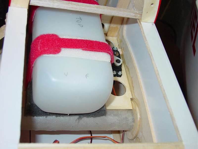

Hey Greg the motor looks great. Say how are you mounting your fuel tank in the Plane?

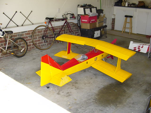

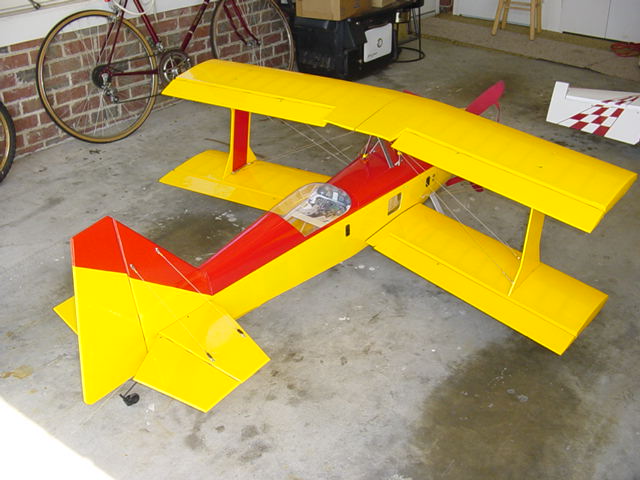

man i installed my flying wire tonight on my ultimate that i am trying to finish up...

Old 03-24-2004 | 10:48 PM
  #79
Posts: 941
From: Fenton, MI
Default RE: Its Here!! Double Vision
Does anybody out there who has a DV think it's a little porky? After weighing everything in the box mine is at 11 lbs. I think I'm going to have a finnished weight of around 18 lbs. Is the DA 50 up to hovering an 18 lb plane or should I be looking at getting a ZDZ 60 or even a 3W 70?
I'm just wondering what you other DV owners are thinking.
Cheers,
Wiz

RGreen,
I made a tank floor tonight, I will have pics tommorrow for you.
As far as weight, see Chips fly its good even at 17lbs.
Kitman

I was thinking of mounting mine to the underside of the canopy area. Whast do you think
Old 03-25-2004 | 04:42 PM
  #86
My Feedback: (13)
Posts: 208
From: Columbus, OH,
That will be fine and help the balance as fuel is used.
Kitman

Hey Greg, I would still like to see your pics of the fuel tank set up.
thanks
Old 03-25-2004 | 05:41 PM
  #89
rgreen24's Avatar
Posts: 1,113
From: Omaha, NE
Greg, I just realized that I will not be able to mount the fuel tank under the canopy hatch -- the fuel tank is too big. I need a new idea with some pics. I wish the plane had a real floor then I could bolt it to the floor. That' s what I do with all my pattern planes.

OK,
Just for you rgreen24, I crawled into my Hanger G (G for Garage), an' snapped a picture the tank.
You can't see much but the ply plate is positioned almost on top of the wing tube to a cross-bar on the former that is more forward. Foam is 3M-77 glued to bottom of tank. The tank is held in place with Velcro cable-straps.
Uses the same plate for the throttle servo.
With a DA50, a Slimline muffler and a 4000 mAh li-ion and JR digitals all round the final weight was 17lb 1 oz.
All I need now is some spring weather....
