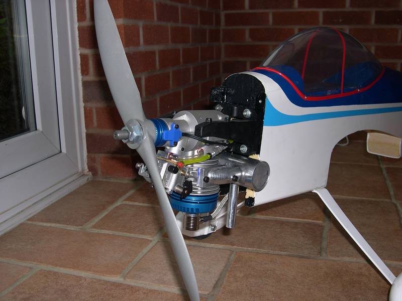

Hi , for those who wanted to know if you can put a mvvs 26gt petrol engine,, here it is but mine is an evolution 26gt. Ive already put this in a previous post. The tank has moved from front to middle just under the wing. I cut a hatch at the rear end of the fusealge where the batteries for ignition and servos go. I must say that with this sort of setup you need goood servos. Today my rudder servo just just died in neutral position (lucky me !) it was a Futaba 3010 so now im going to buy a hitec HS-5645MG. Apart from that the plane just flies great with just 10grams at the back and a 17 x 8 Menz-S prop
