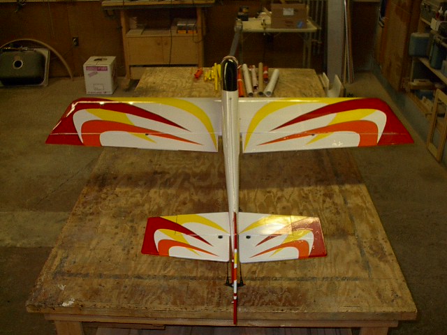

Posts: 2,279
From: Clarks Summit, PA
No, same one. #4. Guess I didn't make the flames big enough. It turned out to be harder to see than the original scheme. Didn't like the blues on overcast days, so I thought it would look good with flames. Went back to the original scheme, just different colors. Its now visualy enhanced for these tired eyes.

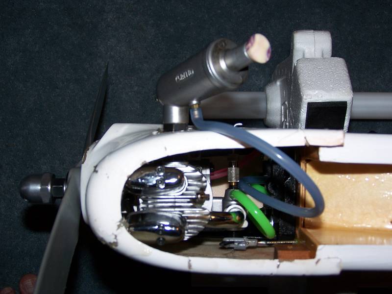

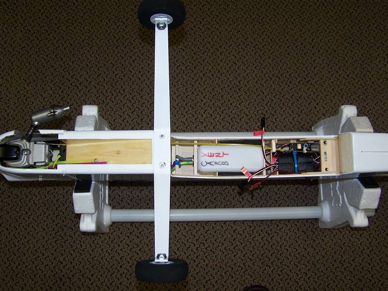

fliggyg...I think you will need to open up your cowl to get the air out. Before I opened mine I had a lot of overheating problems. Also, I second the idea to go to carbon fiber pushrods as an upgrade. Central Hobbies is the best place to get them.
Here's a couple of pictures of mine.
Barry

Barry, i would have to agree, yes, you do have sufficient air flow

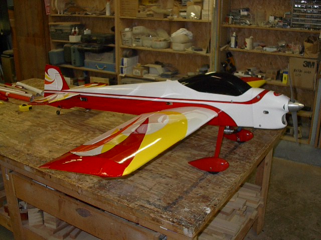

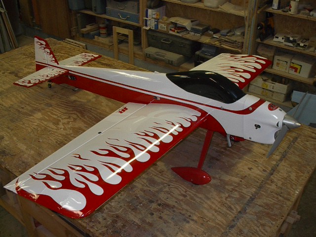

The last picture is of my most recent UCD. Number 4 I think. I'm getting better and more perfectionist minded like Joe. Also, the lastest version has the mighty 110 in it. Looks inocent just sitting there, but believe me it pulls the UCD around like no other. Mine weighs 7lbs 14ozs ready to fly less fuel. And it is fun to fly. The 110 makes this a completely different airplane. At least at my altitude it does. I need the omuph.Thanks
Barry
