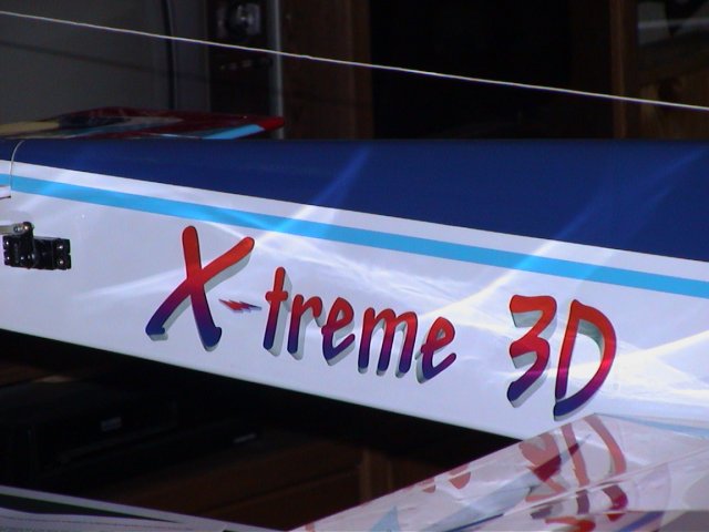

Folks,
As others had previously mentioned,... GP designed a great plane (no pun intended) but should had put a little more thought into the name. Attached is a picture of my UCD3D,.. now named "X-treme 3D". I also designed my own wheel pant decals. Amazing what you can do with a computer, inkjet color printer, water-transfer paper, MS Powerpoint and a little imagination.
More pics can be seen at http://www.prism.net/lingling/RC/UCD.html

Tom can you post your Powerpoint file(s), your graphics look awesome.
Thanks!

Attached is a ZIP file that contains the basic file PPT (Powerpoint 2000) with the "X-treme 3D" decals, including L and R wheel pant decals.
The paper I used was purchased from http://shop.store.yahoo.com/beldecal/moddecpap.html I've used other paper and this appears to be the cheapest I could find (please tell me if some one else sells it cheaper, this stuff is $1 or less a sheet, depending how much you buy). These were printed using a cheap ($100) HP 940C inkjet printer. After printing, I coated with 2 coats of TopFlite clear coat (fuel proof stuff of course). Best method to apply is to scuff the monokote with 000 steel wool, apply decal, then mask & coat with a light coat of Topflite clear coat. Other decals were simply copied from manufacturer websites. Have fun!

Glad you like them. Just be sure you give GP credit for their awesome 3D plane.

Tom, thanks for posting the powerpoint file. But on my computer, it doesn't quite look right. What font did you use? I'm guessing that I don't have it...
Ooops! Forgot that some might not have the specific font. I tried saving the Powerpoint file in a graphics format (JPG or GIF) but the output is rough (not giving good detail as that in PP when printed). In hopes that this might remedy the problem, I've attached the TTF font file below (zipped of course). Try unzipping and placing in the "C:/WINDOWS/FONTS" directory on your harddisk, then reload the decal file. Let me know if that works.

TOMAPOWA,
Ordered some decal sheets at your recommendation from Beldecal. Price was OK, but then they added $6.00 shipping on top. Way too much for basically a few sheets of paper. What was your experience with them? Should have the UCD done this weekend, looking forward to being able to add a few details to trick it out a bit.
