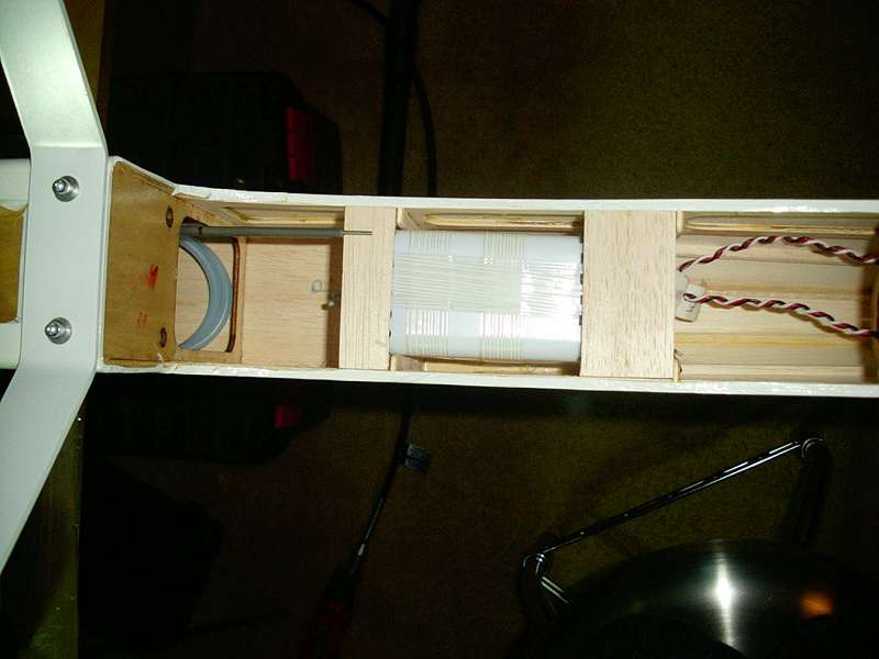

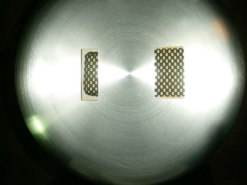

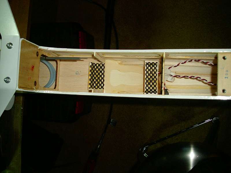

I'm gonna try and post a picture here (first time) of my modified fuse showing contoured and padded tank supports in place ready to receive the tank.
Old 11-09-2003 | 09:58 PM
  #1622
I & C Tech's Avatar
Posts: 643
From: Burgaw, NC
Default RE: can u
Great! Here's more then. Pic 1 shows the strapping tape reinforced tank in place. Pic 2 shows the two padded braces ready to complete the install. Pic 3 shows everything being test fitted together.

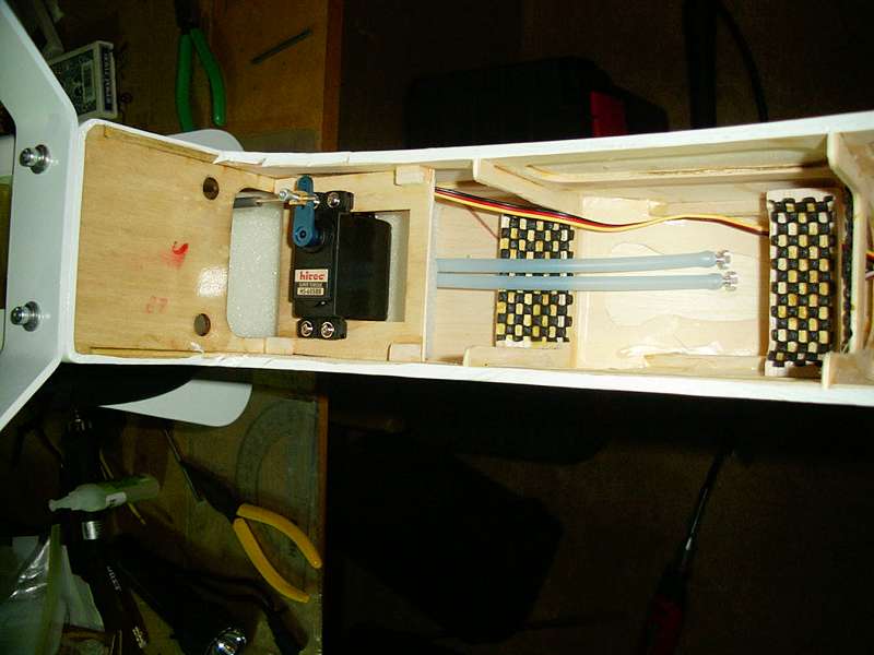

First pic- Trimmed down servo tray, ready to fit in front of fuel tank location. Second pic- tray installed with balsa block reinforcements. Third pic- servo installed and yes.... i know the servo arm screw isn't in yet but thanks for noticing

Default RE: can u
In the last couple of pics you can see foam used to isolate the fuel lines from vibration. Remember that foam packaging at the ends of the UCD box? Worked great after cutting off a couple of inches from the thin end. Put one above and one below the fuel lines. It might absorb fuel but I guess I'm trying it anyway.
Old 11-09-2003 | 11:03 PM
  #1625
I & C Tech's Avatar
Posts: 643
From: Burgaw, NC
Default RE: can u
OOOPS, I put the throttle servo a little to high and the lingage protrudes above the wing line. I'll have to cut it loose and lower the mount a wee bit. So watch that if you're doing a similar install.
