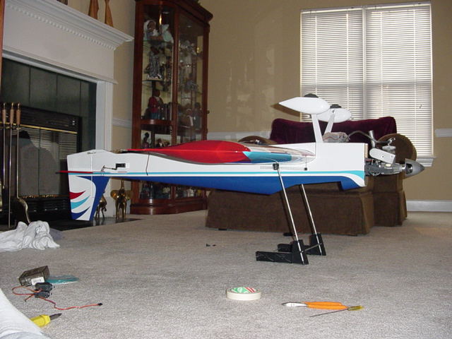

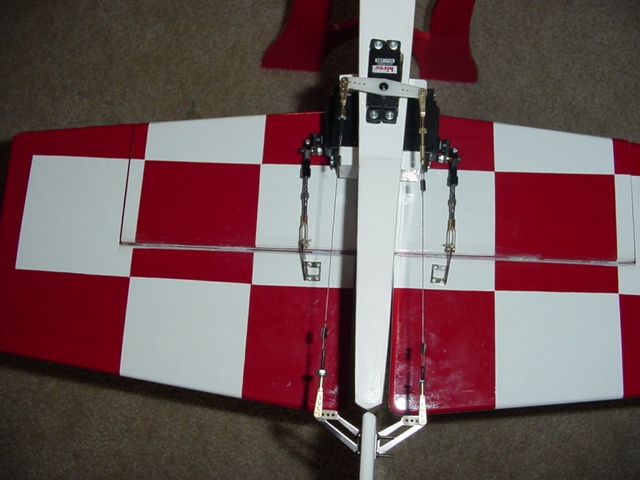

i am getting ready to put mine on a tune pipe RCS 1.4

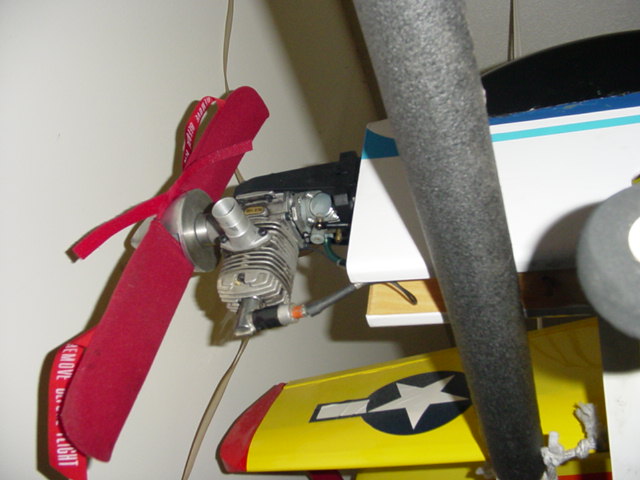

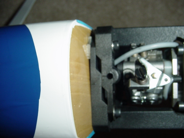

Krayzc, come on, give us the low down on that gasser. Weight of engine, how did it balance with engine, overall weight and most important, how is it????? You can't just show us a picture and clam up. Spew!!!!!!! Joe

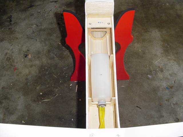

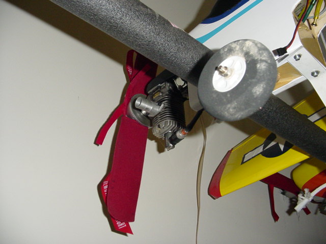

cumn thru:
I had did a forum on it months ago i think its called u can 3d w/120+ size engines.
I love to fly this one on an 8oz tank for an easy 15 minutes. it will do the waterfall and t-roll very well. I have never been able to do a blender or elevator with this set up. I am 8 3/4 lbs with a pitts muffler. I am not sure what the weight will be with the tune pipe. I have unlimited verticle. I could never get the RCS 1.4 to have unlimited verticle on the pervious planes (DP ultimate and a DA Funtana). I figured what the heck why not try that baby on this kit. The rCS is right at home on this set up. I am running a 18 x 6W apc that works great! The balance works great by sifting my servos in the rear (3), and the reciever battery. I should be able to use the cowl this time around and it will all hide in that long sucker.

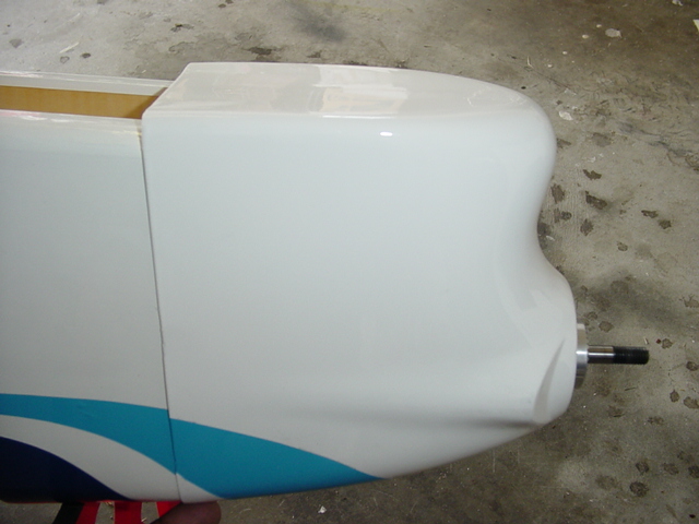

cumn thru:
I did no mods to the plane to make it any stronger. I went it with a laid back altitude. I did not pin or glass anything for strength. I think if a plane can achieve balance with in the spec it doesn't realize that it has a heavy or light motor on the front. I am with in the spec by relocating of the servos and receiver battery. Plus the motor is very smooth my satio and ys engines shake more than this engine. I did not get the 1st batch of u can do also, which means I may have a stronger kit. The first batch I heard a few people pulling off the landing gear. Mine has held tight. I did use the mount that was supplies I had to take a drimel and grind out some off both the inside to allow the motor to sit in there. This is a quick to put in the sky kind of plane.....I did have to put about 4 degrees of right thrust to have the kind of up lines that I like... I will show a pic of a u can do with the covering striped off

Hey krazyc, what's your new covering scheme like ? Interesting pic of the ucd stripped.
