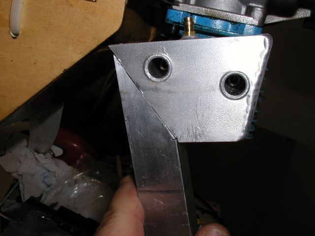

Hey, ya'll. Got my DL 50 today. Measured everything, and I'll need an additional 5/8" standoff from the firewall. If anyone has mounted a DA, you've had to deal with this, too.
What solutions are out there for the DA or DL 50's ??? Plane isn't here yet, so I have some production time....
[Edited after completion - ended up making 5/8" thick, 3/4" square hard a/c plywood standoffs, because they could be more easily sanded for the offsets needed per bubbagates on thrust alignments. He was right.]

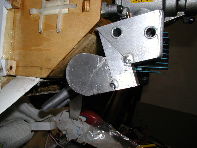

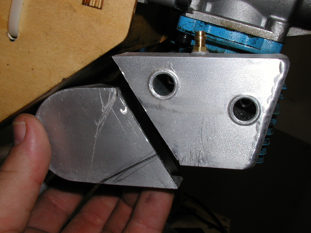

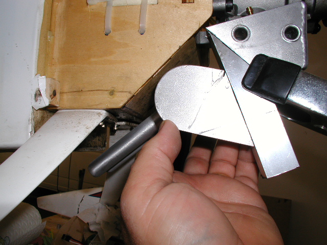

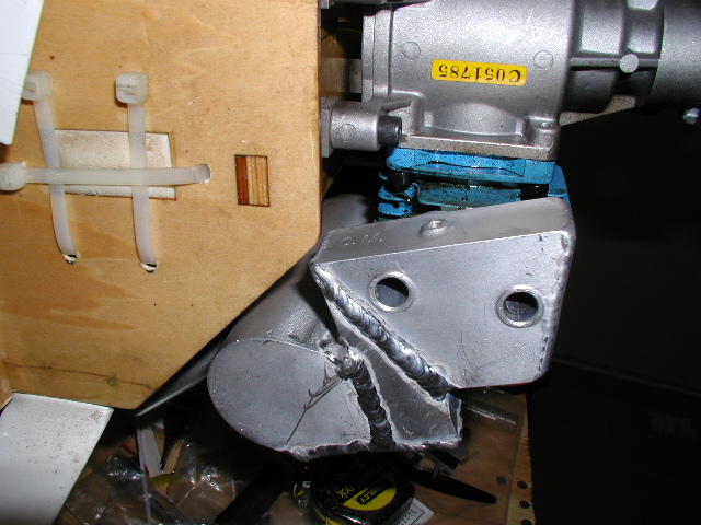

Hi guys. It Elvir from Croatia and I need a little help. I have a gp cap 232 with a Fuji 43. My sister came from the states this week and brought me a bison wrap around muffler. I tried to install it and to my surprise it did not fit , I would have to cut a good deal of fire wall or cut the exhaust and lower it about an inch , any one have any ideas?

Looks like you did a great job. Did you leave some clearance between the cylinder barrel and the muffler body? Any touching could cause vibration and early failure of the welds although they look great. Really nice job!
#792
Between the muffler and the firewall there is about 1/2in and the motor it is about 7/16in so it dose not touch, I am going to try it on Saturday to see how it runs and sounds. I also got from my sister a Sullivan smoke pump. I look up some home made recipes here there is knowone who has smoke oil in my country , if any one has any good smoke recipes please give some ideas.
