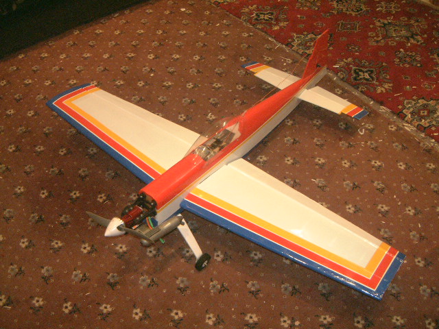

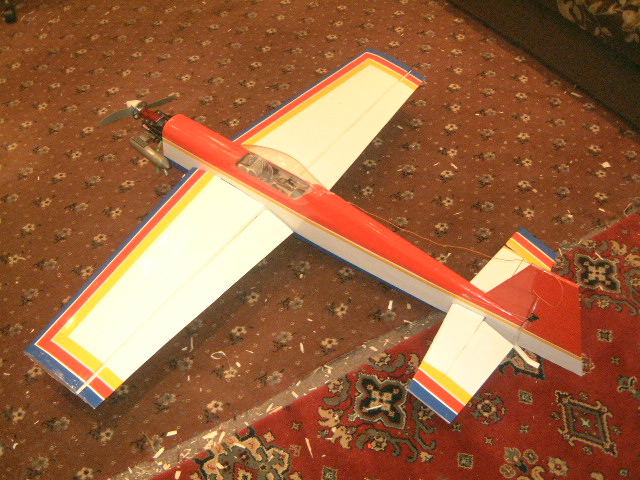

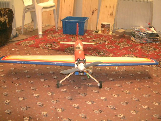

Pics, taken in my shed, yes it has carpet![X(]
Last pic is a funny one, I am sure I wasnt running but that is test pilot Phil with the tranny, he flew it I was not bothered to take a risk.[&:]
By the way thanks to you guys here on RCU for your encouragment and help throughout the build.
I have flooded the joiner with expoxy and clamped it both sides with brass and expoxied that, its well secure now and the hinges are good to go as well. I just need to check the NiCad and see for any fuel damage, still puzzled slighty as to how so much fuel got into the tank bay.
