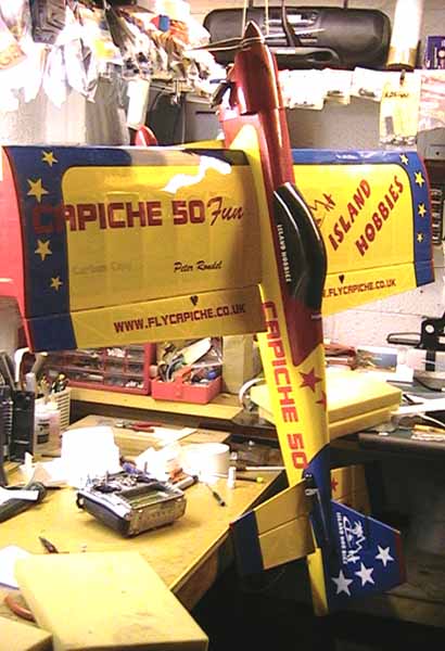

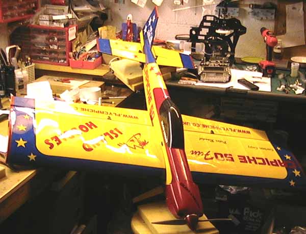

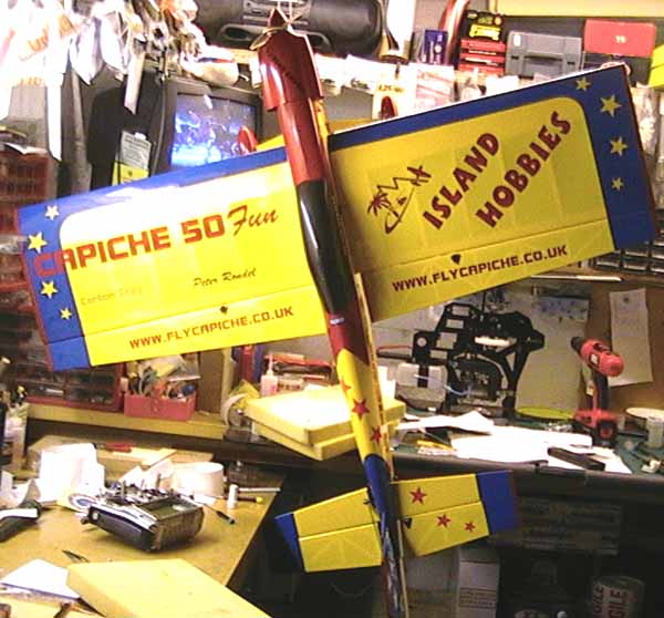

The original idea was to go for tapered wing...
we changed the plan and went for paralell chord, but with a tapered aileron.
Two reasons for this... first of all to add shape.
Secondly.. it is true that (in my view)
paralell chord ailerons on a fun fly does not work... too much drag at the tip. (i.e. as you say Surrey - harriers etc)
secondly is control response. Ailerons that are too large can have an adverse effect...(unless they are of stiff balsa and have powerful servos)... they can twist and create too much blow back. Narrower tips help allevaite this.
Many of the fun flys today are actually designed to be flown at near stall speed.... maximum throttle control...
In truth many folks also want to hit the gas and do a bit of flying too.... thats when huge ailerons let you down.
We will see how it flies....when the rain stops.... its been absolutely bucketing down here today and tonight !
some more pics
sorry about the quality but outside pics was a no go today !

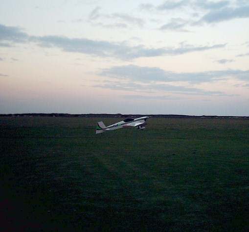

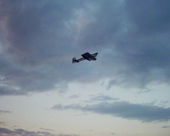

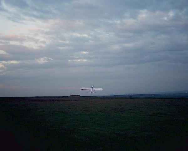

FF wing testing before i spanked the old Capiche fuz and proto FF wing.
from the flights i had before it went in, very nice.
3rd pic is prophang, tho the wind was making it hard to stay vert, so it was more of a harrier.
BTW Archie, roll rate on mine at speed, 3001 servos. fine, better than the Cougar maybe. no sign of blow back. Tho my cougar servos are now held by the wing covering alone..[X(] doesn't help.
Much quicker than the Pheonix at speed and it's barndoor ailerons.
i had my doubts about the section at first, my own wing was going to be of Hype section, propper FF stuff, tapered TE and LE to keep the Capiche shape. After the flights i've done however i'm very happy. would like to see a hypeish section tho just to see if it's better/worse. Like Malcolm said, this section keeps some of the pattern attibruites going. but.... if you've got a wing for pattern, do you need that in a FF wing?
