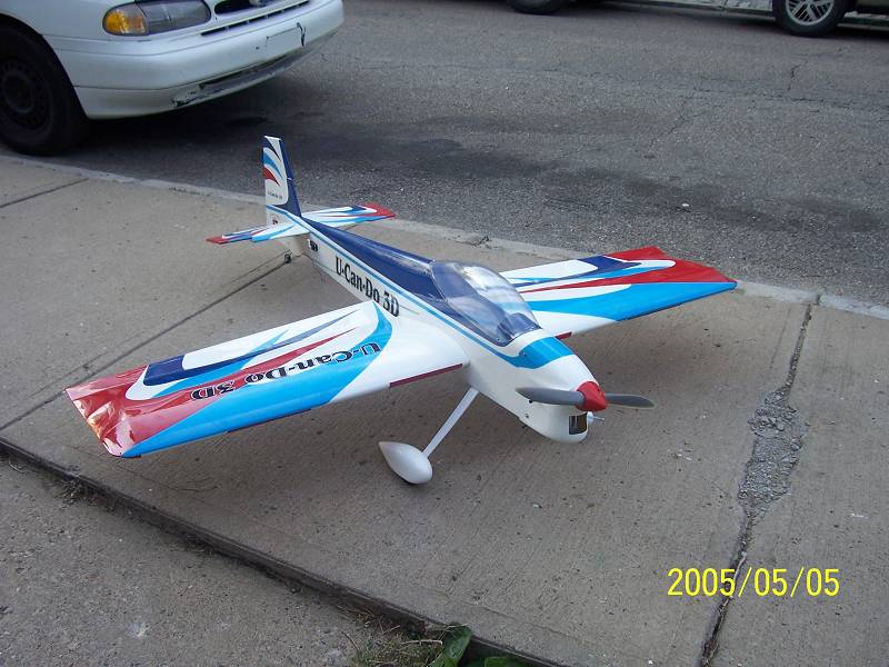

hey guy,
i finished my new UCD .60. What a sweet looking bird, so when i did a range check (10 times![:@]) on my futaba rec.(fm FP-R127Df) i got 20ft[:'(] so i pulled
the ant. out and moved it i had 100ft
. So when my test pilot fly it he was 100ft and lost control and did a slow roll right in to the ground[X(][:'(][:@][
] in that order and i didn't fly it[&o] so when i get my new one my old one will be a beater.
my father also has a .60 UCD with a futaba pcm 1024 rec and had the same problem but he was smart enough to know better. but me range checked out om the ground
did anyone else suffer from this?
what radio gear do you use?

38.. I've had no radio problems on my UCD 46 using Airtronics tranny
and Hitec gear on 6v.. I have my ant. on the very bottom of the fuse
exiting near the tail wheel, I drilled holes in the bottom of the bulkhead
and installed a plastic tube for my ant. wire. My servo wires are at the
top half of the fuse running in the same bulkhead but top cutouts..
Again not problems to date...

38...That's weird. I use Futaba and Hitec stuff and never had a problem. Knock on wood. Well, never a problem except for the 4 flat spin landings of course. Maybe they were because of radio glitch. Yeah, now that I think about it...they were radio glitch.Thanks

I run my radio antana wire stright out the bottom (just punch a small hole) and on the bottom of the fuse on the outside. Then I keep it tight with a rubber band around the tail wheel and to a broken servo arm part on the wire. Seems to work good. I can control it further than I can see it.Thanks
