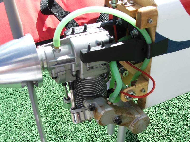

Finally.... here are acouple of pics of my UCD .46 powered by a Saito .82.....
Mark

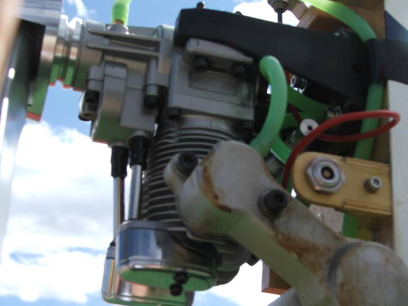

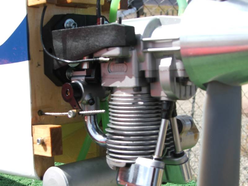

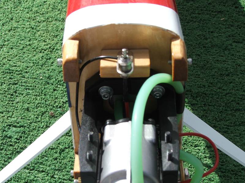

a few more....

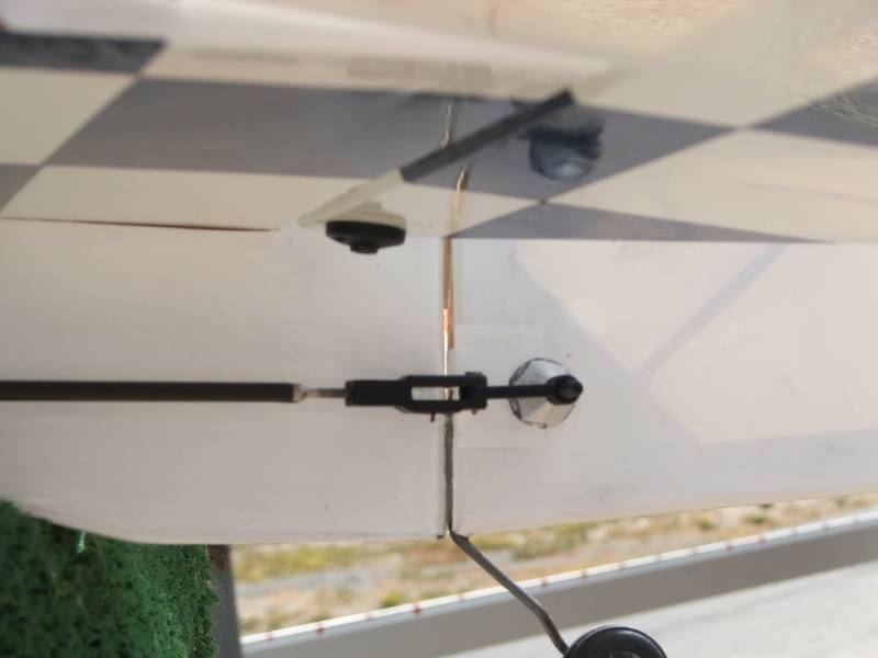

a couple more... these are featuring the control linkage which is a combination of Central Hobbies CF rods and Du-Bro HD Control Horns and clevises....

Great job on the pics Hero. Very nice! [8D] Where did you get the muffler for it? What brand is the remote glow?
It all looks like a pretty good set up. I'm jealous.........[&o]

Nice pictures. Thanks for sharing. From the pictrues it almost looks like the engine is upside down. Must be the camera angle...

Thanks guys... Rob, the muffler is new from Slimeline, it's the new Inverted 4-Stroke Muffler and the glow remote is from Revolution. it's actually design for helicopters but was perfect in that it has a rubber boot that locks onto the plug and the metal bracket comes with it. I just had to run a ground wire from the metal bracket to the motor bolts and it works great . I like it over the regular ones from Du-Bro and Sullivan as it was short, simple to install and doesn't 'pop' off like the others.
Barry, the engine is indeed installed inverted ... I almost installed it right-side up but noticed that in the instructions they show it right-side up but when I looked at the mounting pic closer the landing gear is actually at the top of the picture. So I just installed it upside-down and put the Pitts muffler on it and it flies great but I'm still dialing it in with the help of the fellas at the field.
BTW, I love flying this thing and I am so far able to perform a Hover, Knife-Edges and the Begginner IMAC pattern (still needs practice); got my 20th flight on it this weekend so I'm happy.
