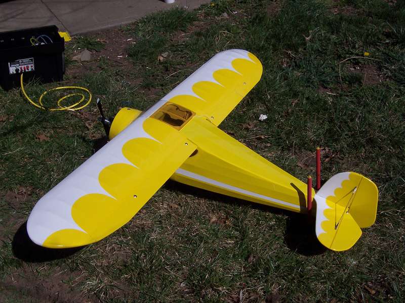

Here is a new adition to the hanger, The ucando has, not seen it yet.

Golden - Nice looking plane. I really like it. Whos's kit or ARF is it? How's it fly?

it is a kankge Monocoupe 90A 1/5 scale. It was the most dificult arf I have built to date. She has not even flown yet. I was just breaking in the engine.

Beautiful plane Golden..........

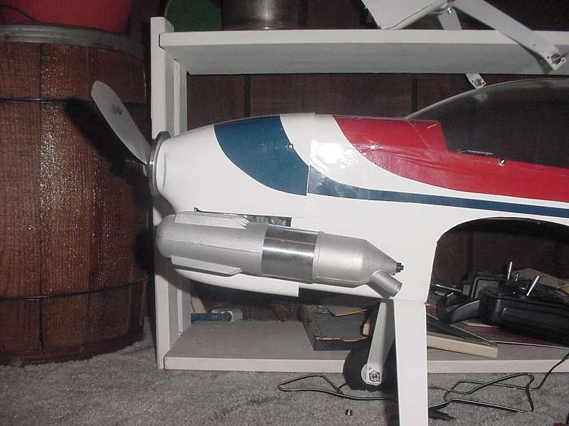

I coulnd't help not posting a pic of my new UCD with the OS 91 installed. should be AWSOME......

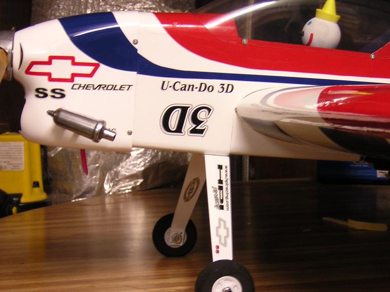

perkinsm.....Looks good bud, But I think that thing needs to see a heat gun!!! HA HA HA! I see that you used your "wooden squares" that came with the kit to install the cowl. What I did was not use them,(I started to tho) Instead, I drilled holes for the screws in the side of the firewall. Look at my other pics and you might be able to see. (aww heck, I'll post one fer ya!) I know this is not neccisary but it does take off a couple of grams. Not much but every little bit helps right?!
BTW.....whats with that other UCD in the pic, right above your new UCD? I can see part of that landing gear brace you made.
Joe
