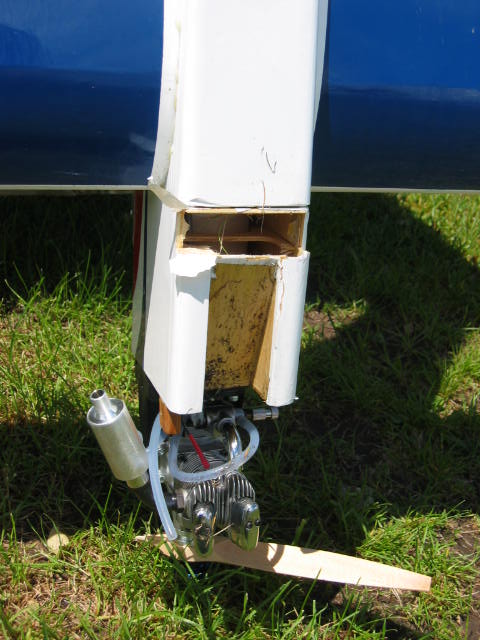

Raideron, glad to hear you had such a good day. I'm sure those tail touches look very cool.
I unfortunately had one hard landing that ended up as shown below. What is the best way to repair and strengthen the gear? I'm sure it has been discussed before and I'll page through the other posts to see if I can find it...
v_twin1k
v_twin1k

v_twin1k... Yeah they will come apart if you don't strength the block..
The way I did mine ... I used 1/4 angled bulsa(4), I applied C.A. on to
the bulsa strips and let dry then I epoxied it to the four corners of the
L.G. block.. I did not go very high on the wing side of the block, But on
the firewall side I went up pass the lite ply that the bottom of the tank
sits on and also added more epoxy around the block.. It's pretty strong
now... I've had the plane drop on the gear from about a foot and a half
from a dead stick and the gear stayed on... I think it was Gary and
maybe CeeGee that added pushrods??? from the wing opening glued
to the block and out through the ramp under the engine compartment??
But you'd have to find the post to be sure, It's just a few pages back I
think....

I use plastic bolts through my undercarridge, still breaks the bolts on the hard landing but better than having to fix the whole block, most of the time you can get the bolts out at the field, replace them and carry on flying

looks very similar to other pics,at least there consistant in comming apart and easy to fix, i think they call it "landing block crock"[&:] just use lots of 30 min epoxy, that will help

Hey V_twin,
I used some left over push-rod through some holes I drilled from the wing saddle side. Roughed them up with some sand paper ,rolled them in epoxy ,& pushed them in. Epoxy the heck out of it in the fuel compartment and should hold up fine.
