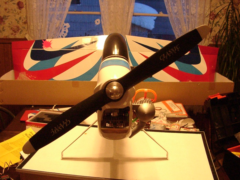

Well, gentlemen here are a few pics for your amusement. What I have going on here is the UCD 60 with a 23cc Super Tigre engine. I've added a smoke system with two taps on the exhaust to pressurize the tank. The muffler has a home-brewed brass coil inside that will pre-warm the dri smoke liquid before it dumps into the manifold. I've also added a remote glow ignitor and when finished it will have two 2000mAh batteries as well. I'm currently making the lexan skiis for the bottom and I hope to have it all up and running by Friday. To answer the question that's bound to be asked.........Yes, I'll be adding lead to the tail of the plane! lol

That there is a MAS 18x6 Classic .(Meant for the likes of a 1/3-1/4 scale cub.) I'm hoping to have some video if the weather permits. We've been flying in -20/25mph lately, except for today which was fantastic. I hope Friday's maidening will be just as fine a day! BTW the engine has 3.7 hp listed on the tech sheet. We'll have to see just how much flutter this here aeroplane can handle. Wish me luck! Peace

Well then, good luck! Flutter is all about the setup, or lack of a good one. I went 4/40 all the way with HD control horns, ball links and quick links. Pinned hinges gave me a good tight hinge line without sealing and it will handle full bore down lines with the YS 110 without a hint of flutter. Can't wait for this one and video would make my day. Thanks. Joe
