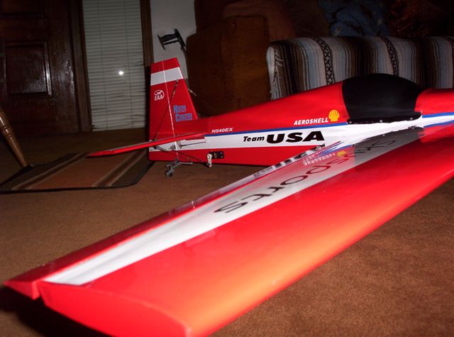

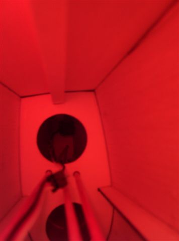

Ok,,, I'm finished. (Sort of.) I ordered a new cowling so I can swap back and forth between the Saito100 and the .91FX. They both fit perfect without changing the motor mount.
Anyway,,, you already know what stuff I've been working on to reduce weight in the fuse. The area right behind the firewall between the front and the LG got a nice big hole cut out in it. That made a big differance. Used the old rudder rod tube for the antenna wire.
In some of the pics below the 6volt battery pack wrapped in foam is setting along the belly structure but that will change after I CG it I'm sure. Also was playing around with some blue pin stripe tape tonight. Just to get an idea how it looks. Don't like it. Maybe black,, but not the blue.
VF Edge diet in pounds and ounces.
Before the dry weight of the plane was 8-3/4LBs .. easy nine pounds++++ when 14oz tank was full.
After the Sturtz Diet. Total dry weight is 7LBs 4oz.

The rudder now bangs the elev halves at 85% throw. No binding or stress. It just looks differant . What I was trying to accomplish is distance from the rudder pushrod to the elev horn. But,,,,, it's a small change to make so I'll probably move it back tomorrow.
The hole behind the firewall is 3 1/2" inches across and 3"inches wide.
Will be too windy this weekend I'm afraid. 15 to 30mph . But,,, if I get it CG'd and the rudder servo arm reversed I wouldn't be afraid to fly it. I'm hoping the weight loss will allow me to go back to the Saito. So much more throttle managment with the 4C.
The truth is that changing the rudder location was one of the easier mods I've done to this plane. Like John from VF said,,, "It's amazing how much weight the small stuff adds up too." And that is one reason I redid this Edge. Take the throttle servo . I had a big bunch of wood and epoxy holding the first one in place. Now I have a small popcicle stick brace that is stronger and lighter .
But the main thing has been shaving and sanding everything to the point it's much lighter yet remains strong.
Update: Changed the rudder servo arm. Lost a bit of throw but it will be plenty enough.

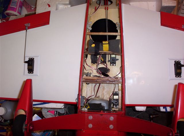

Balancing! Yea, I know - I bought the plane in July and I still haven't flown it - I'm a slacker [&o]
Any way - I can't seem to balance this thing. It is touchier than any plane I've dealt with on a CG machine.
With 1/2 ounce of lead on the tail, the following pictures were taken.
Now, both pictures - weight is in the same spot but I can "position" the plane at either angle and it will not move. Granted, if I tip it forward a little bit its going forward or if I tip it backward a little bit, it's definitely dropping the tail. It just seems to me to have a couple of different positions that it likes to sit at with the weight in the same spot. Also, I have to level it out until it stops going forward/backward by hand - is that normal?
Also...someone way back asked for pictures of how I had the internals set up so I'm posting a pic of that too.
