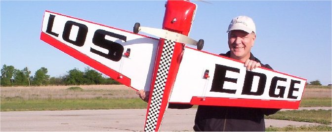

oh man,that sucks there shutting the doors[:@] (hopefully for just awhile) when they emailed me that my plane should ship in 7-9 days(which is monday) they told me and said they may be back so all we can do is hope and let them know we will be here for another plane, i can say that with confidence after reading the thread here so i hope they come back!!!
rcfury, those letters on the wing are vinyl grafix stick ons right? we have a grafix shop 25 miles away and i still have to check with them( ill take the plane there so they can see what i want).

Yup,,, I stole Nathan's idea as did others and made a couple of changes .That was on my first wingset. Really does help while flying out further away or while doing axial rolls. Don't have the graphics on the new wingset and I can really tell the differance.
If anyone is interested I can give you the email address of my friend who does vinyl graphics for a living. He does custom lettering for stock car racers. He does my computer business decals that I place on all my custom built gaming and business machines.
His prices are very cheap and I don't think you'll find anything of equal quality for the price anywhere.
Tell him Kurt sent ya.

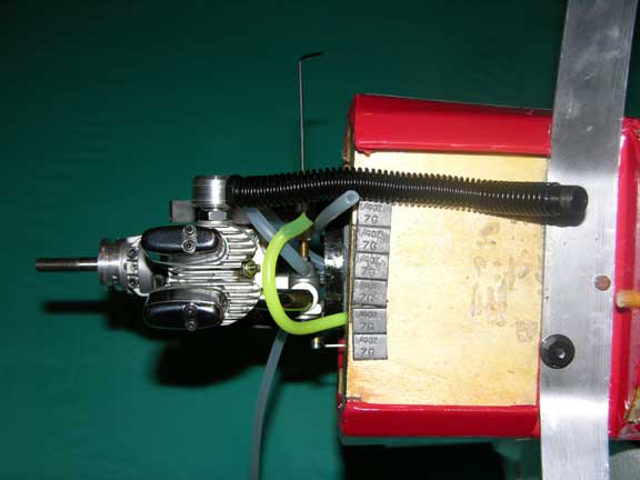

Finally got back to work on it tonight. Almost had a fire in the shop! I mixed up a BIG batch of 30 min. epoxy to install the wing joiners in the wing halves and got the right side in when I turned around to grab my cup o' epoxy to lather up the left side and the whole shop was filled with smoke behind me! Smelled kind of electrical, well sorta. I half panicked but couldn't think of what it could be...I wasn't charging anything or using any power other than the lights. Then I noticed it was coming from the epoxy. I guess small batches is the ticket. That 30 min stuff got a rock hard ball in it in less than 10 minutes then just set there cookin'. Anyway, a quick whip of a new batch for the left side and all is well...I think (haven't tried to fit it after gluing yet.
Now the reason for my post: I marked a circle around the engine mount so I could roll it over inverted and redrill the holes. Once bolted up I measure the position of it on the firewqall and it is offset to the left 1/8". Is this a design thing or a manufacturing goof? Shoul dI preserve the 1/8" offset when I drill the new holes? Maybe it's in anticipation of shimming the mount for right thrust figuring that will center the motor? Help? You guys that have them in the air...where is your mount set in relation to the centerline?

With the plane upright it is totally normal to have the center line offset. Looking at the plane from the front ,,,the offset should be to the right of centerline. This is not always the norm, but I can't think of a single plane I've built that didn't line up that way.
Many reasons for this. One simple reason is the built in right thrust of the firewall to compensate the torque effect. If you mounted the engine directly in the center of the firewall the prop shaft would never line up with the spinner hole in the cowling.

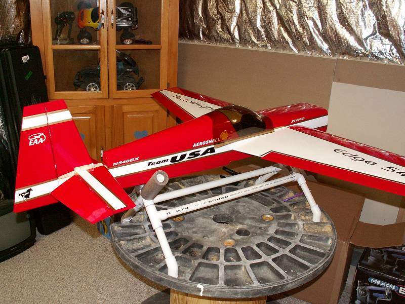

OK, I'm going to try to hang a few pics in this post to show what I've been up to with this thing so far. Construction so far is as most of you are quite familiar so no new developments there. What do you think of the gold striping? Worthwhile or no? Feel free to speek the truth.

nice work on the Photoshop sample there Sturtz. I thought of maybe adding that black a little away form the gold so a little white showed between. That was my dilemma with the gold in the first place. I wasn't sure whether I should lay it up on the red so 1/4" of red showed between the white and gold or right on the two like I did. I figured it would be easier to lay on this way as I had a little more flexibility in position and could clean up some of the red/white transitions that weren't "perfect". I do think a little red bewteen the gold and white would have been snazzier though...maybe down the road. Gonna stick with what I got for now and continue with the build so I can get it in the air...I'm a little anxious

Mine came with the Dave Brown mount which did need a little Dremel work to get my TT .91 between the rails. I gotta pick up a few blind nuts as I can't get two of mine out due to the interior structure trapping them in their current position. Got the new position marked and ready to move on once I get the hardware. Hope to get her going soon. For now I'm heading out to the field to fly Pop's Stinger! Maybe I'll take the bike, it's beautiful out there!

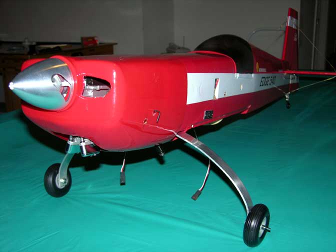

Ran into my first real snag on the build so far. I was fitting everything up to get an idea of where to put things as far as balance and noticed my wings weren't square with the fuse. I stretched a tape from the taill of the fuse to each tip and found them to be out better than a half an inch! The only thing I added since the last check was the dowel through the fuse. I cut the end of the dowel off for the left wing (the one that was swept too far rearward) and drilled out the pre-marked holes at the rear of the wing cut out everyone has been using to pull the rear of the wings together. Then I put the wings back on and made sure the new hole lined up with the pre-marked hole on the right wing and it was dead on. Wings back off again to drill the hole in the right wing and slip the dowel through just for good measure. Everything is cool so out comes the dowel and on go the wings. Stretch the tape back to the tail again to square the wings. Best I could do is get the tips within 3/16" of each other. then mark the location of the "new" hole on the root rib of the left wing which, sure enough, is about 1/8" behind the pre-marked hole. Wings back off to carefully drill out the new hle in the left wing, CA the dowel in place, wings back on and measure to find the tips again within about 3/16" - good enough. Now I have two dowels through the fuse and the right wing but only one through into the left wing. Easy enough fix I guess but I'm at a loss as to why the left wing is off in the first place. I triple checked everything before ever gluing. Bonus is the two dowels give me an awesome place to zip tie my receiver to! Might even be able to put the battery there if the balance allows for it. Pics will follow soon.

Hope your fuel line set up works out well 'cause mine's about the same! I cheated on the inverted motor a little though. As stated before I couldn't get the top two blind nuts out of the firewall because of the plywood that runs laterally right behind them. When I went to invert the mount I found I wasn't going to be able to set any new blind nuts on the top of the mount because of the same piece of ply so I rotated the mount a bit off inverted so I could pick up one of the old holes. Also allowed me to point my stock muffler darn near straight out the back on the bottom of the plane which should minimize any oil on the plane. I did have to cut a hole to clear the rocker covers but it isn't very big. I drilled the mount out to add another mounting bolt to get back to the stock 4. I promise some pics real soon

How are you going to be running the muffler? Since your doing the inverted setup. My orgianl plan was to use the slimline pitts for the inverted saito but, were all out of stock so i instead used the flexpipe as you havn't figured out from the pics.
