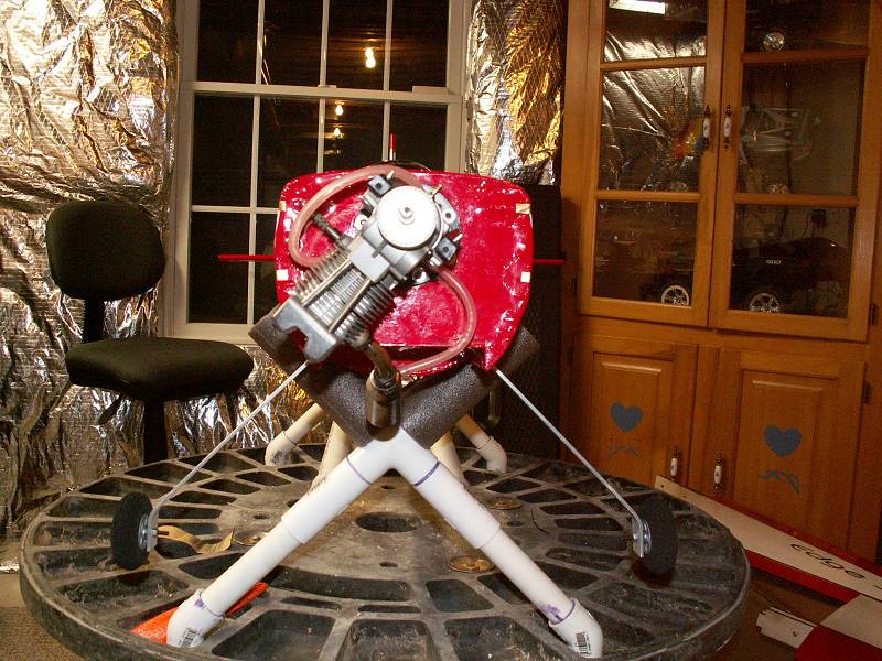

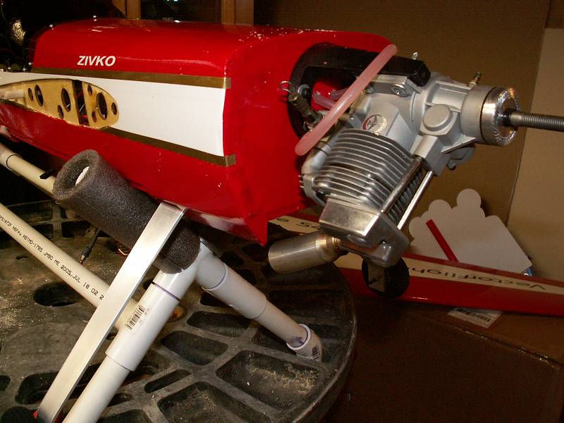

Guess I'll have to get out the camera for this one. The muffler is stock and since I didn't go absolutely inverted it aims straight out the bottom of the cowl. I haven't trimmed the cowl for it yet but should get that done after dinner.
You can also see my wing fix in the pics.

hey rc, if you need any help with the cline, ive been running one on my 100 for about a year ande it still works great.
Bunman: I was thinking of position the motor that way but, the way i was thinking it would have hacked the cowl too much than before. Im also amazed on how much the redesigned fuse has changed.
To much hackin' for ya? [:-]
After fitting the cowl over a totally inverted mototr and then this way, this allowed me the least hacking. Even more important to me was the exhaust angle. Hoping to keep the oil off the plane. This TT seems awfully large for a .91 and it is certainly WAY heavy at a little over 26oz. I think I'm going to get serious about a Saito 125. Gotta get that new cowl ordered...hopefully it aint too late!

I've used an Iron Bay regulator on my inverted Saito... works great... it doesn't need much back pressure... it allows the pressure to build up in the tank and just takes what it needs....

i think itll work just fine rc,the tap is close enough to the top that i think itll be ok!!, if not im screwed too because im ordering the same pipe for my 100 to go on my ucd and if it dont work i can always tap my crankcase, you just have to use a "T" fitting and put the check valve just on the other side of the "T" (straight across) and then have a open line to the atmosphere on the bottom of the "T" out the bottom just like a normal vent!this will create enough pressure to operate the cline and still allow flow for the oil to get to the bottom end
Bunnman, i kinda like that mount, gives me something to think about
about how far off is the tank centerline from the from the spraybar?

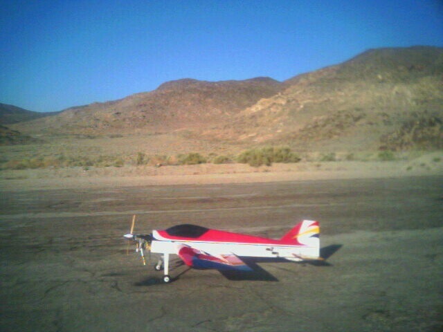

thanks Nathan, i have all the thing i need to start and am ready, and hope their right about wednesday, but that seems too good to be true, even if i have to wait till thurs or friday i guess ill live, (i hope
i have some pictures like your avitar
)i have some pictures like your avitar

Wow,,, look at that desert landscape. I have always wondered if you guys from CA or AZ, etc have to use air filters on all your planes. (?) Does the sand and dry lake bed dust effect your carb/motor? I guess we have about as much dust laying around in the grass. You can sure see it blow out of the grass when you first start your engine in the pits. Then you don't see much the rest of the day cuz you've blown it all away from your fueling area. Just a little dead grass blowin. We use to be a dust bowl here long ago. The red clay on the top soil can be very harmful on a small engine.
(UCD.46) Don't feel bad !! I had to dig my Saito.72 out of the ground one time after coming out the wrong way in a low inverted loop.[X(] Also had the tail break off another one at half throttle. Landed a little hard was all. The UCD is unlike any other plane.
Really gives you a feeling of confidence. Unfortunatly that is what often turns them into broken sticks. And what you do with your DO,,,should usually not be tried with a regular ARF. "OUCH"!

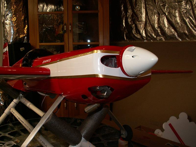

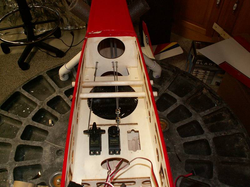

Good sitrep Bunn. That gold trim looks even better out in the open field. I use Futaba radios so I'm not much help on the programming problem. I have learned that you should balance this bird upright and inverted . Then choose the position that the plane falls off the balance point the slowest to do the final CG. Balance it with the tank empty!!
Yup,,, I've been going crazy here with the Dremel tool and the drill and saw. Finished the bottom of the cowl today. Removed over 5 oz of unwanted fat from that alone. Plane with Saito100 weighed in at 8LB 8oz. Plane with OS.91FX (which is heavier) weighs in at 7LBs even. With nothing but the engine, rudder servo in the tail, elev push rods, tail wheel and landing gear/wheels and pants left on this thing I could lift it by the landing gear and it would nose forward. After removing all that excess wood in front of the landing gear area it now falls back to the tail when picked up by the gear. That is a big differance when you can get results like that.
I just now picked the VF fuse up to make room for my 120 and freaked on how light it is now. After proper CG'ing and adding the Futaba 3010s on elevator and ailerons w/6.0volt battery I already know what this plane is gonna do. Slower approaches without that sudden fall from the heavier fuse weight. KE will be much cleaner with less coupling. Rudder inputs (yaw) will be twice as crisp with less mass to move side to side and with the servo closer to the surface. Loops will be smoother and less likely to snap . Vertical is gonna be a hoot after sheading all this fat. The only true weight in the wings is the joiner and the servos. Because they are not sheeted the foam retains it's lightness. And I truely believe that was the only fault in the whole plane's flight character. The wings love to fly. Get your CG too forward and try a fast landing to see what I mean. Better have plenty of space to settle down with.
Balanced perfectly and with less weight in the fuse and this thing should be the nimble power house it was mean't to be.
Nathan,, I have flown the 120 540T and can tell already that the thing will hover just a hair over 1/4 throttle. Yes,,, I over powered it with the Super Tigre G2300 and the 18x6 prop. On the maiden flight I found out why they say to have lower than low rates ready in case of an over responsive plane. Talk about PUCKER FACTOR +++ !! I managed to relax and do the trimming on the middle rates but flicked the switch to low quickly after. LOL... Gonna be a 3/D machine from hell. Hopefully I can handle it. Used 25% expo,, will raise that by another 10% next time out. I had to cut the maiden short because of the G2300 losing power. I ordered a Perry Carb and it came today. I'm hoping it will make the break-in period a little less nerve racking cuz I sure would hate running several gallons of high-$$ nitro through it while it sits in a tail stand. I wanna fly that fuel !!! Not watch it blow out the exhaust .

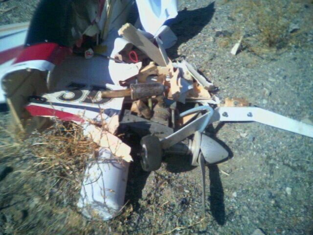

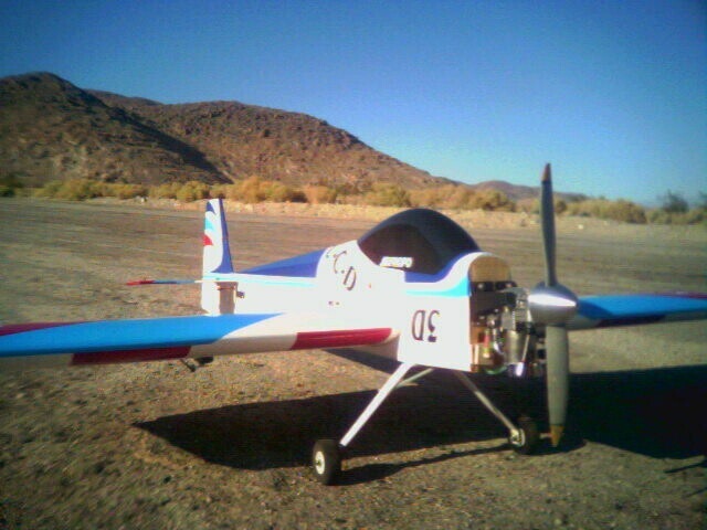

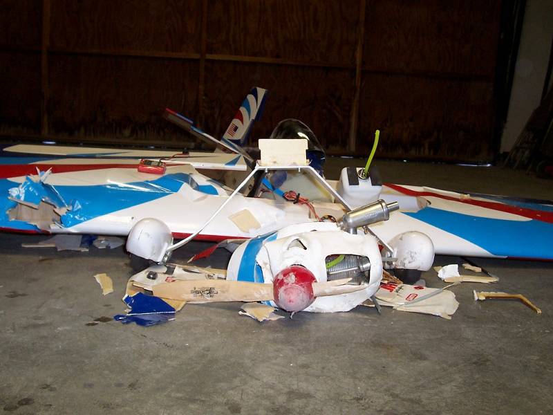

Nathan, yep, dumb thumbs on the 60 size alright, comming out of knife at about 30 ft off the deck and forgot i was on high rates and rolled out right too far and wound up inverted and freaked out till it hit the ground
the 46 was a catostrofic failure of the left main wing(notice its not in the picture)[X(]
sturtz, no problem with the air, we actually have really clean air as long as the winds stay below 20 mph so we are ok, thats one of the reasons i start it on my truck gate and not on the groundwhich is a little dusty sometimes but not real bad, see all the clean air in the pics
