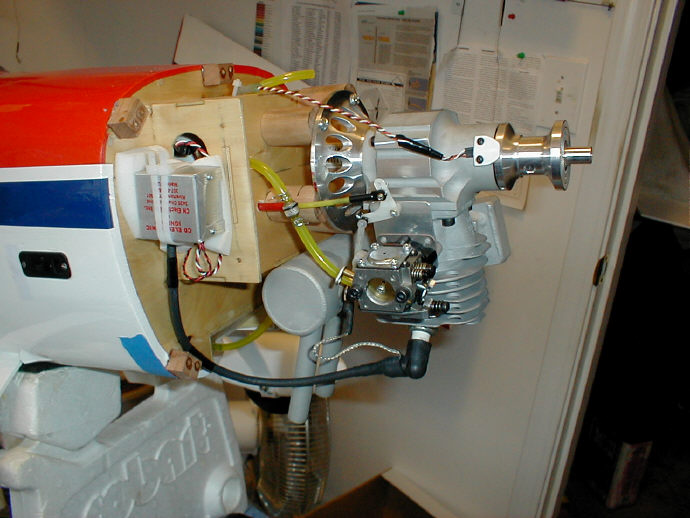

My PW300 is now completed except for the CG and a connection to work the choke. Wgt is 17 pounds. I am not sure what made the wgt to top out at 17 LBS. I installed a Taurus 2.6 with a 1400MAH battery for the ign. I had to install standoffs to clear the engine box. I did not want to cut out for the muffler. My standoffs are 1.5 inches long and 1 inch in diameter. Wgt 3 oz total for standoffs. See photo attached.
I think The airplane is going to be a little Nose heavy due to engine being so far forward. I should be able to work around this okay. I used Radio South 1/4 scale CA hinges on all controls.
Looking for a way to work the choke without a big hole in the cowl. I have enjoyed very much reading about everyones progress on their PW300. I have picked up some good ideas reading these posts. Will advise how she flies.

Im not cutting any hole in the cowl for the choke on mine. Im using a brison 3.2 and I am able to use a stick through the front of the cowl to operate the choke.

to activate the the choke on my 3.2 i attach a 2-56 threaded nylon clevis to the choke. drill a small hole in the cowl that puts a threaded pushrod inline. you can align the clevis and pushrod through the front of the cowl.simply screw it into the clevis and snip it off the desired length.pull to choke push to open,when you want to remove the cowl,.........unscrew it..........simple and works great on my others

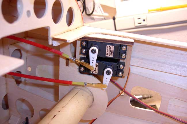

I added and extra servo for the choke on my 3W48B2. I tucked two servos in the upper right hand corner under the canopy. I'll post pictures tomorrow.

Radar,
Here are a couple of pictures from my throttle and choke set up.
Andy

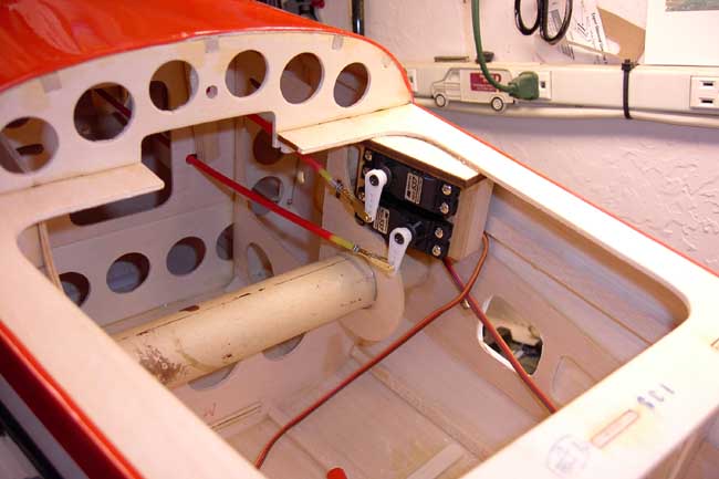

Default Wagstaff Extra 300
Here is another angle.
