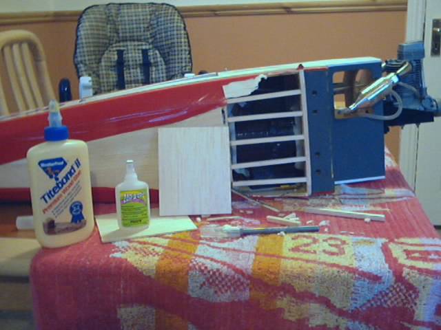

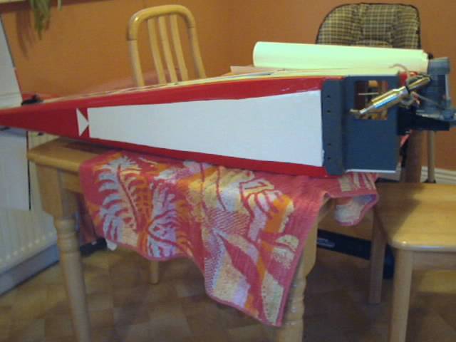

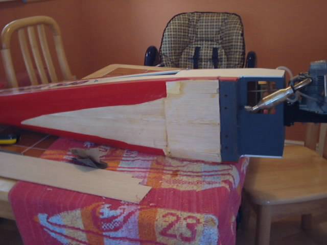

Hi guys, further to my earlier posts.... be cautious with the undercarriage of your Edge. I have been recommended to use plastic bolts as our flying field is quite rough and it puts a lot of stress on the internal mounting structure. The undercarriage member is very big and strong but isn't held in by a lot so it's always the weekest link to go....
Here's a pic of my repair incorporating 2 extra stringers, resheeting with balsa and covering with some white... I couldn't find the right colour red at the model shop and the plane has white anyway so it matched relatively well.
Not a bad job for someone who likes the flying more than the building side of the hobby ( I even used sandpaper :-0 )

Hi Gricer - thanx for the pics - nice to see someone getting some air time this time of year.
Your repairs look ok to. Did you do anything to further reinforce the block that the gear attaches to?
