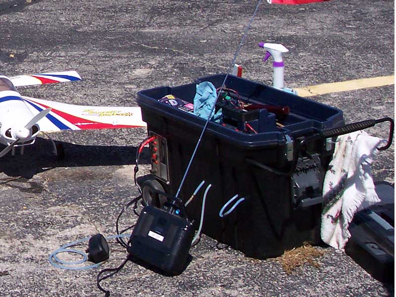

When I stared flying I was like most beginner pilots, I had a flight box that was stuffed to the gills with tools and parts. After a couple of years of lugging that monster out to the flight line I came to the conclusion that I needed to do something different. So here's what I did. First I split up what I take to the field into repair tools that can stay in my truck and things I needed on the flightline for flying. Then I decided that I needed to take less tools to the field. Some guys seem to carry every tool to the field with them (heck, I think some of them could fabricate a new engine from scratch with all the tools they carry ), but I decided to not do that any longer. I only take the basics to the field with me any more. Enough to do simple repairs like tightening loose items, changing props, repairing holes in the covering, etc... But for bigger repairs I simply take the plane home. I hate doing field repairs because they are pain to do and most of the time you can do more damage than good doing a field repair. I can't even count how many times I've watched guys rush through a repair at the field only to have it come loose in flight and the plane crash, whereas if they had gone home they could have done the repair right and would still have their plane. So for me, only simple repairs at the field. This usually doesn't ground me because I always take at least 2 planes to the field, usually it's more like 3 or 4 planes.
Anyway, back to my flight box. Since I was tired of lugging a flight box to the flight line I decided to find something with wheels on it so I wouldn't have to carry it. I found a tool box at Lowe's that was perfect for me (see pictures). In the bottom of the box is a 12v lawn mower battery (needed for starting larger engines, 140+ size) and 2 one gallon containers for fuel (one 15% for the majority of my engines and one 25% for my YS). In the top tray I keep tie down ropes, my electric starter, my field charger, glow driver, overflow tank to catch fuel when filling, and my fuel pump. That's all that goes out to the flight line/pits with me, that's all I need there. I've had this box for about 4 years now I totally love it. I have two 12v taps on it (one for my starter and one for my field charger). I do have the power panel on there but I never use it and will probably leave it off if I get another box later on. The best thing about this box was that I didn't have to spend a lot of time "building" it. I had it ready to go with about 20 minutes worth of work.
I know that everybody has their own way of doing things and I would never think of knocking somebody for how they do their equipment, but instead I bring this up to show that there are alternatives. Many beginners (myself included) think that they need a huge flight box with every tool they own when they go to the field. I have found that KISS (keep it simple silly) works a lot better for me. I'm pointing this out so that beginners out there can see that there are other ways of doing things.
Edit: Forgot the picture of my box

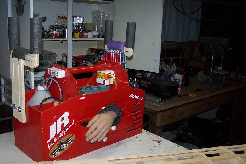

I have decided to go with the banana plug terminals on the outside of the box.
I have the banana jacks that screw onto the outside of the box, I have the electric piggy-back terminals and the female inserts, I have multiple sets of banana plugs and 5 feet each of red and black 14-gauge wire.
So it is my belief that all I do is drill the holes for the banana jacks into the flight box, solder a red and black wire to the banana jack leads and cover with heat-shrink tubing. Then the other ends of the wires get soldered to the female terminal discs and then covered with heat-shrink tubing. Then the female terminal discs get plugged into the piggy-back terminals which are crimped onto the battery. And I have to make two sets (negative and positive).
Am I right about how to do this? Sticktickler has it done on his box (that is his box displayed below) so you are the one to ask, is that the way you did it?
Because I have the piggy-back terminals that clip onto the battery I can do two sets of these external terminals on my box (never know when you will need two going at once so I will be having two sets).
Am I right that this is all I need to purchase and all that is required to install them?
Then I also know I will need to cut the alligator clips off from my charger and starter (knew I should have gotten a panel-ready ) and solder on the banana plugs. One question with that. I have played around with those plugs and can not see how to remove the banana plug from the casing to solder the wire onto.
And a question about soldering. To solder all you have to do is stick the wire in through the hole in the terminal and fold the wire onto itself and then solder? How much solder do you want to apply, I imagine you wouldn't wanna overdo it obviously but how much is overdoing? Do you want a thin coat to the point that it sticks or do you want it well coated?

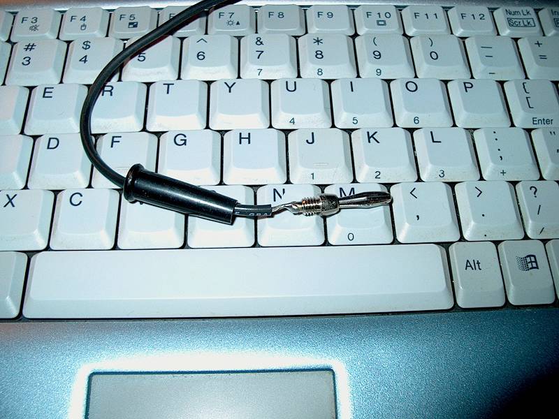

What is the p/n of the banana plugs you bought. Picture too fuzzy to read. Once I know that I may be able to tell you how to solder to that particular plug.

Here's one of mine from a Radio Shack (I believe) solder banana plug.
Digital camers are wonderful things.
Old 02-02-2007 | 09:31 PM
  #146
Joined: Nov 2004
Posts: 11,701
From: Memphis, TN
Default RE: A NEW KIND OF BUILD THREAD, for those of you . . .
That's a good one Charlie. If he has the same style plug it will be a good example.

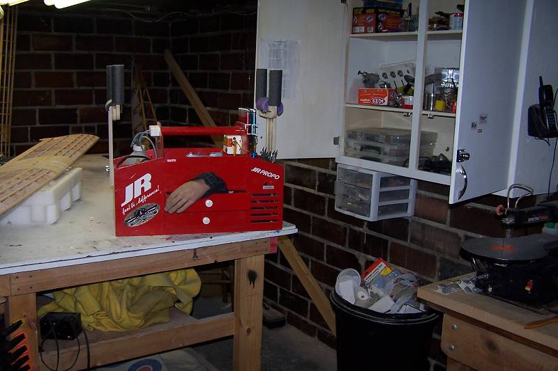

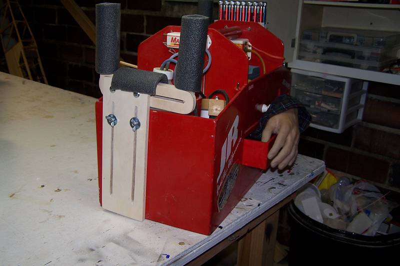

Well Steve I liked yours so much I had to mount mine on the box too. Can't wait to use them I think I'm going to find my snow skis and give it a shot.
PS the hand is from the last guy at the field that got into my box lol!

If by p/n you mean part number it is Radio Shack 274-730 and the banana jacks are Radio Shack 274-725B
I also have some banana plugs that came with the charger that are smaller and screw into the casing (no part number)
From the picture Charlie P displays in the post above the banana plug just pulls of the casing. I guess you just carefully grab it with pliers and twist.
So I don't need anything more, and the connection I mentioned is correct?
EDIT: I just looked again at Charlie P's pic and it looks like thread screws that unscrew to remove the plug.

I like. Looks like you did yours a bit different. The slots for up and down adjustment seems to be longer so you have more area of adjustment.
P.S: I love the hand, what'd the guy steal to lose it?
ORIGINAL: sticktickler
Old 02-02-2007 | 10:02 PM
  #150
sticktickler's Avatar
Joined: Dec 2006
Posts: 551
From: Des Moines IA

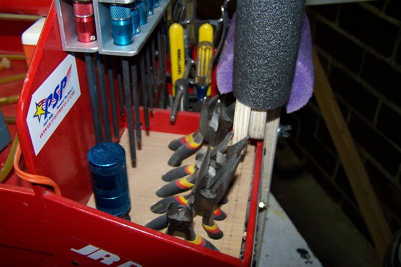

I made them so I can push them all the way down when not in use rather than removing them just another mod. And I chose to mount mine on the ends becouse I have some very large planes that need to fit (wide wing cord) very cool unit!
